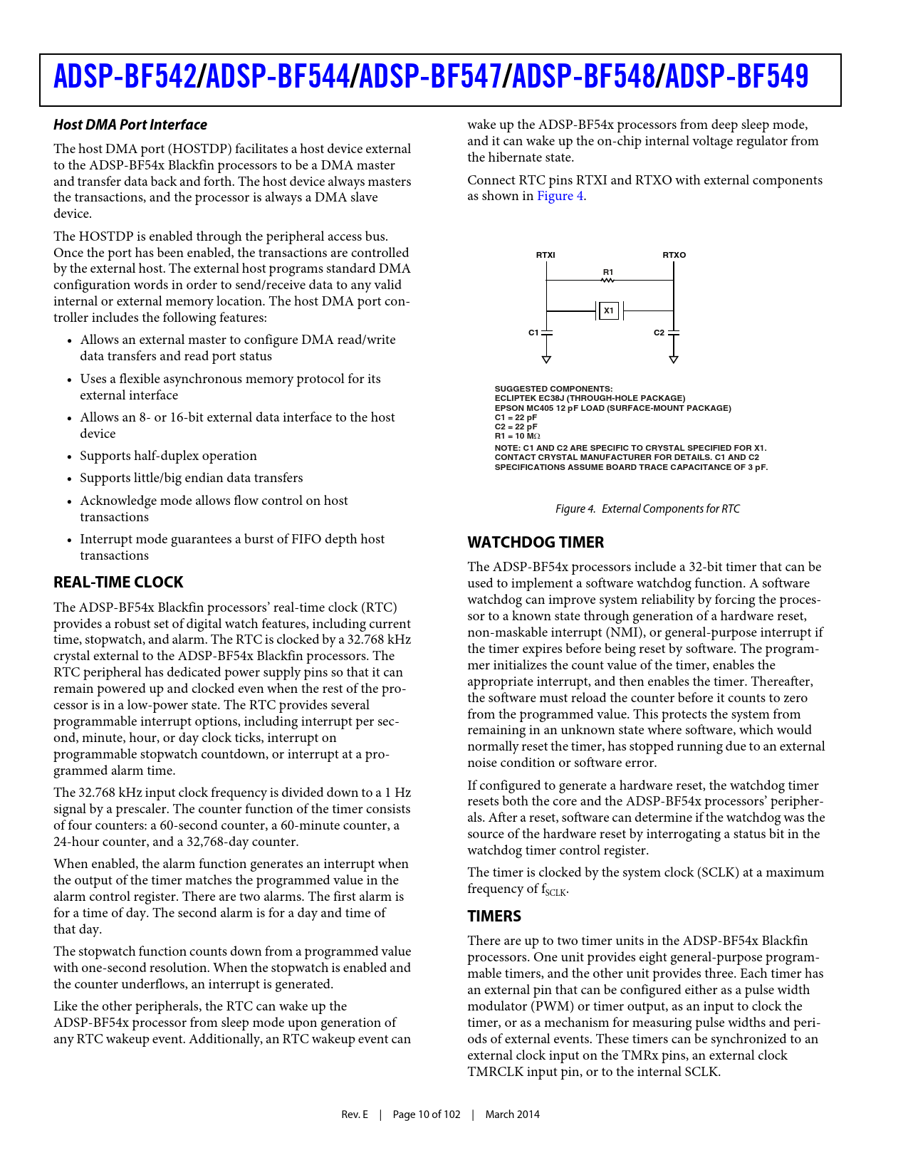

wake up the ADSP-BF54x processors from deep sleep mode, and it can wake up the on-chip internal voltage regulator from The host DMA port (HOSTDP) facilitates a host device external the hibernate state. to the ADSP-BF54x Blackfin processors to be a DMA master and transfer data back and forth. The host device always masters Connect RTC pins RTXI and RTXO with external components the transactions, and the processor is always a DMA slave as shown in Figure 4. device. The HOSTDP is enabled through the peripheral access bus. Once the port has been enabled, the transactions are controlled
RTXI RTXO
by the external host. The external host programs standard DMA
R1
configuration words in order to send/receive data to any valid internal or external memory location. The host DMA port con-
X1
troller includes the following features:
C1 C2
• Allows an external master to configure DMA read/write data transfers and read port status • Uses a flexible asynchronous memory protocol for its external interface
SUGGESTED COMPONENTS: ECLIPTEK EC38J (THROUGH-HOLE PACKAGE) EPSON MC405 12 pF LOAD (SURFACE-MOUNT PACKAGE)
• Allows an 8- or 16-bit external data interface to the host
C1 = 22 pF C2 = 22 pF
device
R1 = 10 M
Ω
NOTE: C1 AND C2 ARE SPECIFIC TO CRYSTAL SPECIFIED FOR X1.
• Supports half-duplex operation
CONTACT CRYSTAL MANUFACTURER FOR DETAILS. C1 AND C2 SPECIFICATIONS ASSUME BOARD TRACE CAPACITANCE OF 3 pF.
• Supports little/big endian data transfers • Acknowledge mode allows flow control on host Figure 4. External Components for RTC transactions • Interrupt mode guarantees a burst of FIFO depth host
