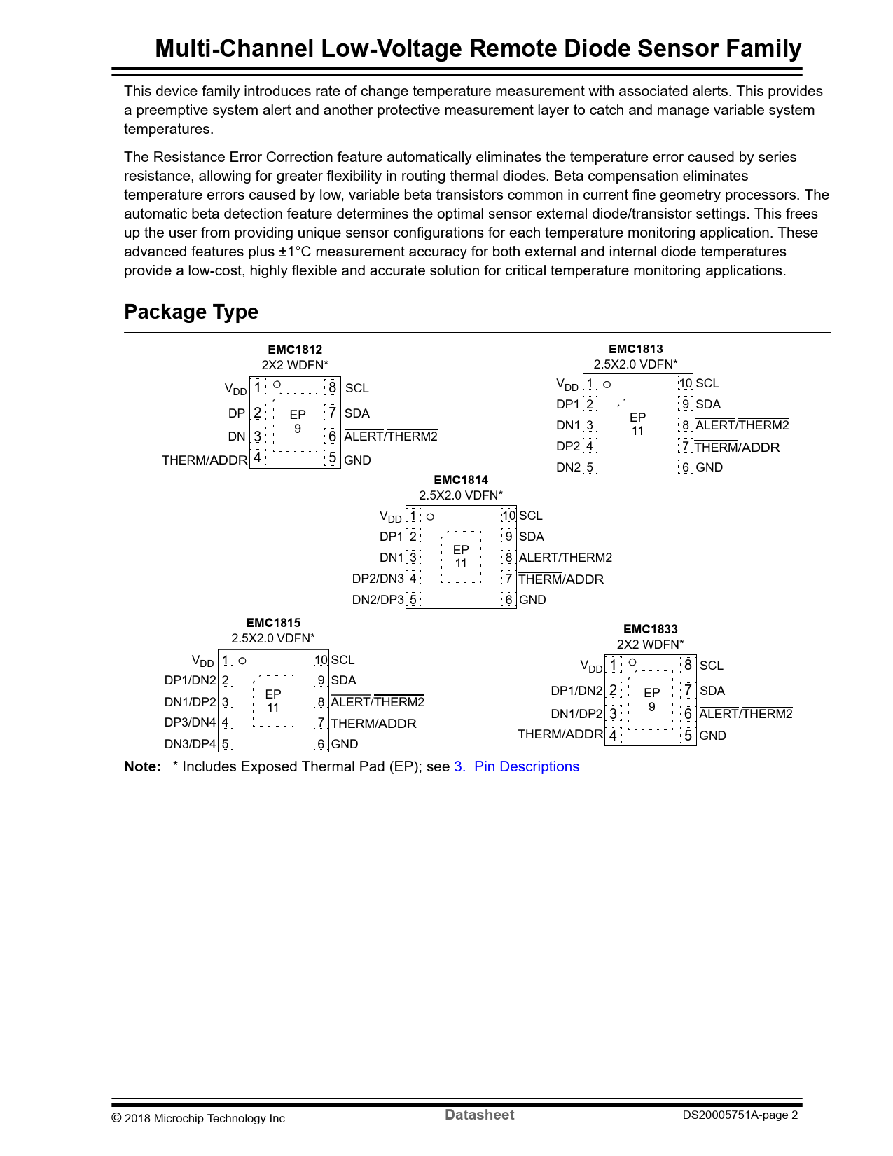

Multi-Channel Low-Voltage Remote Diode Sensor Family
This device family introduces rate of change temperature measurement with associated alerts. This provides a preemptive system alert and another protective measurement layer to catch and manage variable system temperatures. The Resistance Error Correction feature automatically eliminates the temperature error caused by series resistance, allowing for greater flexibility in routing thermal diodes. Beta compensation eliminates temperature errors caused by low, variable beta transistors common in current fine geometry processors. The automatic beta detection feature determines the optimal sensor external diode/transistor settings. This frees up the user from providing unique sensor configurations for each temperature monitoring application. These advanced features plus ±1°C measurement accuracy for both external and internal diode temperatures provide a low-cost, highly flexible and accurate solution for critical temperature monitoring applications.
Package Type EMC1812 EMC1813
2X2 WDFN* 2.5X2.0 VDFN* V V 1 10 SCL DD 1 8 SCL DD DP1 2 9 SDA DP 2 EP 7 SDA EP DN1 3 8 ALERT/THERM2 9 DN 3 6 ALERT/THERM2 11 DP2 4 7 THERM/ADDR THERM/ADDR 4 5 GND DN2 5 6 GND
EMC1814
2.5X2.0 VDFN* V 1 10 DD SCL DP1 2 9 SDA EP DN1 3 11 8 ALERT/THERM2 DP2/DN3 4 7 THERM/ADDR DN2/DP3 5 6 GND
EMC1815 EMC1833
2.5X2.0 VDFN* 2X2 WDFN* V 1 10 DD SCL VDD 1 8 SCL DP1/DN2 2 9 SDA DP1/DN2 EP 2 EP 7 SDA DN1/DP2 3 11 8 ALERT/THERM2 9 DN1/DP2 3 6 ALERT/THERM2 DP3/DN4 4 7 THERM/ADDR THERM/ADDR 4 5 GND DN3/DP4 5 6 GND
