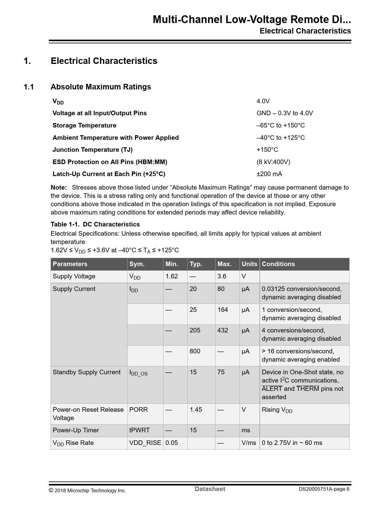

Multi-Channel Low-Voltage Remote Di... Electrical Characteristics. 1.1. Absolute Maximum Ratings. VDD
Multi-Channel Low-Voltage Remote Di.. Electrical Characteristics 1.1 Absolute Maximum Ratings VDD
Multi-Channel Low-Voltage Remote Di... Electrical Characteristics 1. Electrical Characteristics 1.1 Absolute Maximum Ratings VDD
4.0V
Voltage at all Input/Output Pins
GND – 0.3V to 4.0V
Storage Temperature
–65°C to +150°C
Ambient Temperature with Power Applied
–40°C to +125°C
Junction Temperature (TJ)
+150°C
ESD Protection on All Pins (HBM:MM)
(8 kV:400V)
Latch-Up Current at Each Pin (+25°C)
±200 mA
Note: 
Stresses above those listed under “Absolute Maximum Ratings” may cause permanent damage to the device. This is a stress rating only and functional operation of the device at those or any other conditions above those indicated in the operation listings of this specification is not implied. Exposure above maximum rating conditions for extended periods may affect device reliability.
Table 1-1. DC Characteristics
Electrical Specifications: Unless otherwise specified, all limits apply for typical values at ambient temperature 1.62V ≤ VDD ≤ +3.6V at –40°C ≤ TA ≤ +125°C
Parameters Sym. Min. Typ. Max. Units Conditions
Supply Voltage VDD 1.62 — 3.6 V Supply Current IDD — 20 80 µA 0.03125 conversion/second, dynamic averaging disabled — 25 164 µA 1 conversion/second, dynamic averaging disabled — 205 432 µA 4 conversions/second, dynamic averaging disabled — 800 — µA > 16 conversions/second, dynamic averaging enabled Standby Supply Current IDD_OS — 15 75 µA Device in One-Shot state, no active I2C communications, ALERT and THERM pins not asserted Power-on Reset Release PORR — 1.45 — V Rising VDD Voltage Power-Up Timer tPWRT — 15 — ms VDD Rise Rate VDD_RISE 0.05 — V/ms 0 to 2.75V in ~ 60 ms © 2018 Microchip Technology Inc.
