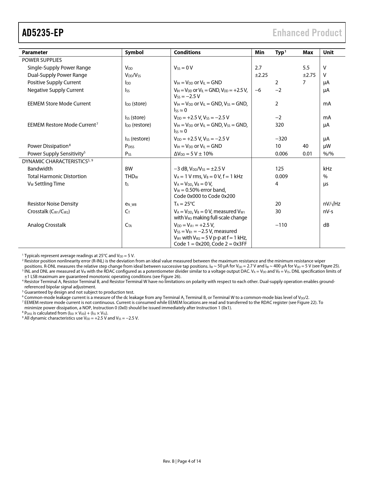

AD5235-EP. Enhanced Product. Parameter. Symbol. Conditions. Min. Typ1. Max. Unit
AD5235-EP Enhanced Product Parameter Symbol Conditions Min Typ1 Max Unit
link to page 13 link to page 13 link to page 11
POWER SUPPLIES Single-Supply Power Range VDD VSS = 0 V 2.7 5.5 V Dual-Supply Power Range VDD/VSS ±2.25 ±2.75 V Positive Supply Current IDD VIH = VDD or VIL = GND 2 7 µA Negative Supply Current ISS VIH = VDD or VIL = GND, VDD = +2.5 V, −6 −2 µA VSS = −2.5 V EEMEM Store Mode Current IDD (store) VIH = VDD or VIL = GND, VSS = GND, 2 mA ISS ≈ 0 ISS (store) VDD = +2.5 V, VSS = −2.5 V −2 mA EEMEM Restore Mode Current7 IDD (restore) VIH = VDD or VIL = GND, VSS = GND, 320 µA ISS ≈ 0 ISS (restore) VDD = +2.5 V, VSS = −2.5 V −320 µA Power Dissipation8 PDISS VIH = VDD or VIL = GND 10 40 µW Power Supply Sensitivity5 PSS ΔVDD = 5 V ± 10% 0.006 0.01 %/% DYNAMIC CHARACTERISTICS5, 9 Bandwidth BW −3 dB, VDD/VSS = ±2.5 V 125 kHz Total Harmonic Distortion THDW VA = 1 V rms, VB = 0 V, f = 1 kHz 0.009 % VW Settling Time tS VA = VDD, VB = 0 V, 4 µs VW = 0.50% error band, Code 0x000 to Code 0x200 Resistor Noise Density eN_WB TA = 25°C 20 nV/√Hz Crosstalk (CW1/CW2) CT VA = VDD, VB = 0 V, measured VW1 30 nV-s with VW2 making ful -scale change Analog Crosstalk CTA VDD = VA1 = +2.5 V, −110 dB VSS = VB1 = −2.5 V, measured VW1 with VW2 = 5 V p-p at f = 1 kHz, Code 1 = 0x200, Code 2 = 0x3FF 1 Typicals represent average readings at 25°C and VDD = 5 V. 2 Resistor position nonlinearity error (R-INL) is the deviation from an ideal value measured between the maximum resistance and the minimum resistance wiper positions. R-DNL measures the relative step change from ideal between successive tap positions. IW ~ 50 µA for VDD = 2.7 V and IW ~ 400 µA for VDD = 5 V (see Figure 25). 3 INL and DNL are measured at VW with the RDAC configured as a potentiometer divider similar to a voltage output DAC. VA = VDD and VB = VSS. DNL specification limits of ±1 LSB maximum are guaranteed monotonic operating conditions (see Figure 26). 4 Resistor Terminal A, Resistor Terminal B, and Resistor Terminal W have no limitations on polarity with respect to each other. Dual-supply operation enables ground- referenced bipolar signal adjustment. 5 Guaranteed by design and not subject to production test. 6 Common-mode leakage current is a measure of the dc leakage from any Terminal A, Terminal B, or Terminal W to a common-mode bias level of VDD/2. 7 EEMEM restore mode current is not continuous. Current is consumed while EEMEM locations are read and transferred to the RDAC register (see Figure 22). To minimize power dissipation, a NOP, Instruction 0 (0x0) should be issued immediately after Instruction 1 (0x1). 8 PDISS is calculated from (IDD × VDD) + (ISS × VSS). 9 All dynamic characteristics use VDD = +2.5 V and VSS = −2.5 V. Rev. B | Page 4 of 14 Document Outline FEATURES APPLICATIONS GENERAL DESCRIPTION FUNCTIONAL BLOCK DIAGRAM TABLE OF CONTENTS REVISION HISTORY SPECIFICATIONS ELECTRICAL CHARACTERISTICS INTERFACE TIMING AND EEMEM RELIABILITY CHARACTERISTICS Timing Diagrams ABSOLUTE MAXIMUM RATINGS ESD CAUTION PIN CONFIGURATION AND FUNCTION DESCRIPTIONS TYPICAL PERFORMANCE CHARACTERISTICS TEST CIRCUITS OUTLINE DIMENSIONS ORDERING GUIDE
