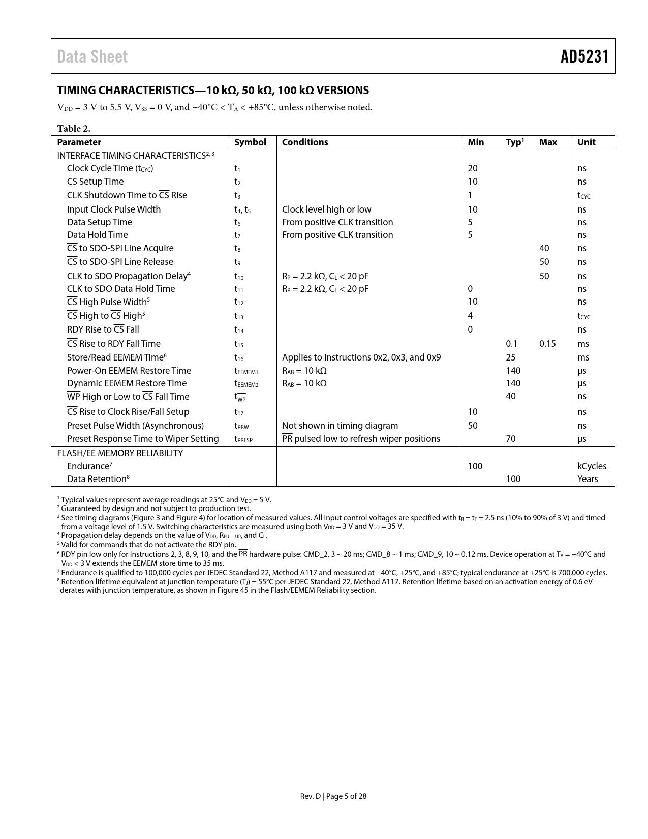

Data Sheet AD5231 TIMING CHARACTERISTICS—10 kΩ, 50 kΩ, 100 kΩ VERSIONS
VDD = 3 V to 5.5 V, VSS = 0 V, and −40°C < TA < +85°C, unless otherwise noted.
Table 2. Parameter Symbol Conditions Min Typ1 Ma x Unit
INTERFACE TIMING CHARACTERISTICS2, 3 Clock Cycle Time (tCYC) t1 20 ns CS Setup Time t2 10 ns CLK Shutdown Time to CS Rise t3 1 tCYC Input Clock Pulse Width t4, t5 Clock level high or low 10 ns Data Setup Time t6 From positive CLK transition 5 ns Data Hold Time t7 From positive CLK transition 5 ns CS to SDO-SPI Line Acquire t8 40 ns CS to SDO-SPI Line Release t9 50 ns CLK to SDO Propagation Delay4 t10 RP = 2.2 kΩ, CL < 20 pF 50 ns CLK to SDO Data Hold Time t11 RP = 2.2 kΩ, CL < 20 pF 0 ns CS High Pulse Width5 t12 10 ns CS High to CS High5 t13 4 tCYC RDY Rise to CS Fall t14 0 ns CS Rise to RDY Fall Time t15 0.1 0.15 ms Store/Read EEMEM Time6 t16 Applies to instructions 0x2, 0x3, and 0x9 25 ms Power-On EEMEM Restore Time tEEMEM1 RAB = 10 kΩ 140 μs Dynamic EEMEM Restore Time tEEMEM2 RAB = 10 kΩ 140 μs WP High or Low to CS Fall Time t 40 ns WP CS Rise to Clock Rise/Fall Setup t17 10 ns Preset Pulse Width (Asynchronous) tPRW Not shown in timing diagram 50 ns Preset Response Time to Wiper Setting tPRESP PR pulsed low to refresh wiper positions 70 μs FLASH/EE MEMORY RELIABILITY Endurance7 100 kCycles Data Retention8 100 Years 1 Typical values represent average readings at 25°C and VDD = 5 V. 2 Guaranteed by design and not subject to production test. 3 See timing diagrams (Figure 3 and Figure 4) for location of measured values. All input control voltages are specified with tR = tF = 2.5 ns (10% to 90% of 3 V) and timed from a voltage level of 1.5 V. Switching characteristics are measured using both VDD = 3 V and VDD = 35 V. 4 Propagation delay depends on the value of VDD, RPULL-UP, and CL. 5 Valid for commands that do not activate the RDY pin. 6 RDY pin low only for Instructions 2, 3, 8, 9, 10, and the PR hardware pulse: CMD_2, 3 ~ 20 ms; CMD_8 ~ 1 ms; CMD_9, 10 ~ 0.12 ms. Device operation at TA = −40°C and VDD < 3 V extends the EEMEM store time to 35 ms. 7 Endurance is qualified to 100,000 cycles per JEDEC Standard 22, Method A117 and measured at −40°C, +25°C, and +85°C; typical endurance at +25°C is 700,000 cycles. 8 Retention lifetime equivalent at junction temperature (TJ) = 55°C per JEDEC Standard 22, Method A117. Retention lifetime based on an activation energy of 0.6 eV derates with junction temperature, as shown in Figure 45 in the Flash/EEMEM Reliability section. Rev. D | Page 5 of 28 Document Outline Features Applications Functional Block Diagram General Description Revision History Specifications Electrical Characteristics—10 kΩ, 50 kΩ, 100 kΩ Versions Timing Characteristics—10 kΩ, 50 kΩ, 100 kΩ Versions Timing Diagrams Absolute Maximum Ratings ESD Caution Pin Configuration and Function Descriptions Typical Performance Characteristics Test Circuits Theory of Operation Scratchpad and EEMEM Programming Basic Operation EEMEM Protection Digital Input/Output Configuration Serial Data Interface Daisy-Chain Operation Terminal Voltage Operation Range Power-Up Sequence Latched Digital Outputs Advanced Control Modes Linear Increment and Decrement Instructions Logarithmic Taper Mode Adjustment Using Additional Internal Nonvolatile EEMEM RDAC Structure Programming the Variable Resistor Rheostat Operation Programming the Potentiometer Divider Voltage Output Operation Programming Examples Flash/EEMEM Reliability Applications Bipolar Operation from Dual Supplies High Voltage Operation Bipolar Programmable Gain Amplifier 10-Bit Bipolar DAC 10-Bit Unipolar DAC Programmable Voltage Source with Boosted Output Programmable Current Source Programmable Bidirectional Current Source Resistance Scaling RDAC Circuit Simulation Model Outline Dimensions Ordering Guide
