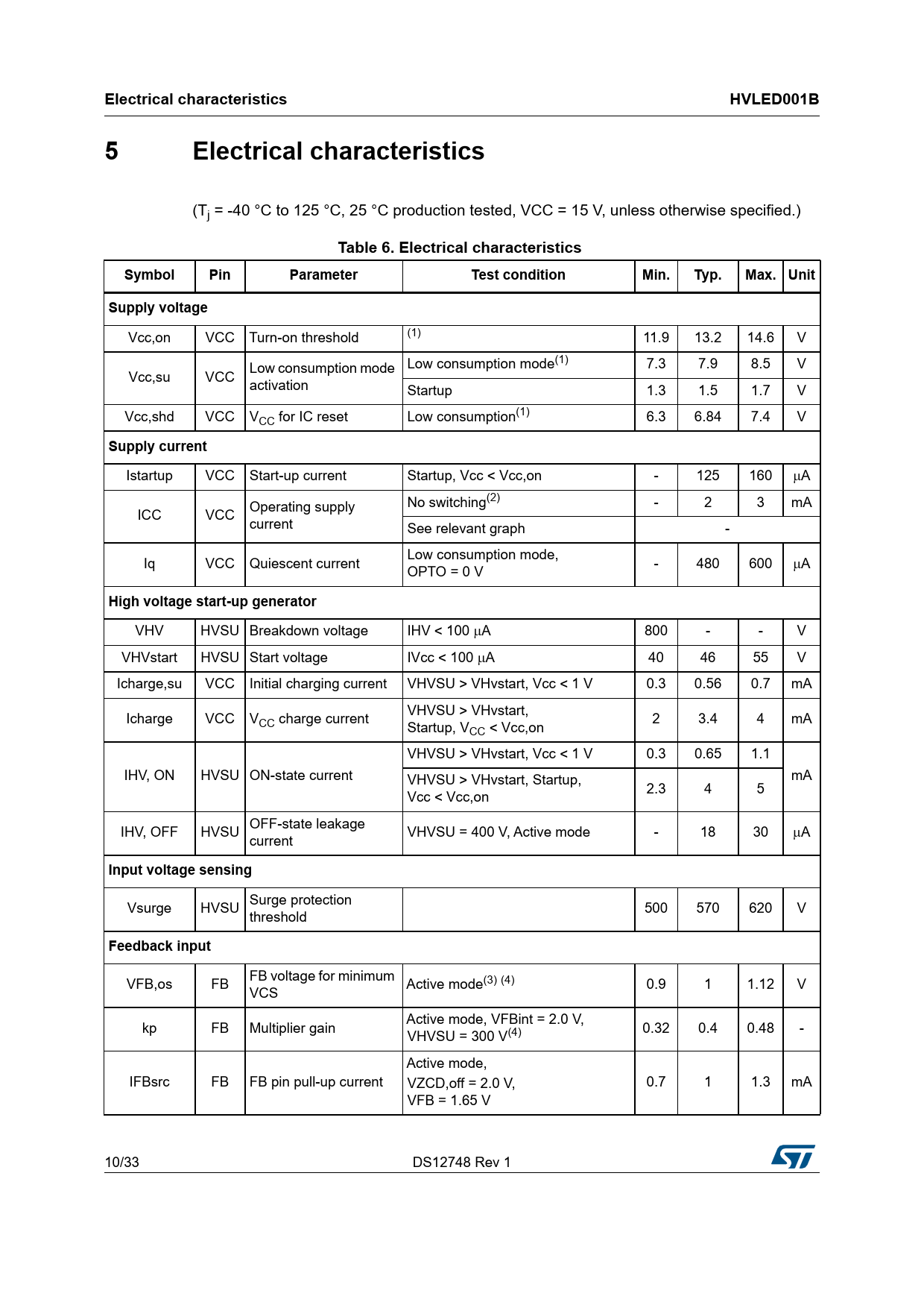

Electrical characteristics. HVLED001B. Table 6. Electrical characteristics. Symbol. Pin. Parameter. Test condition. Min. Typ. Max. Unit
Electrical characteristics HVLED001B Table 6 Electrical characteristics Symbol Pin Parameter Test condition Min Typ Max Unit
link to page 13 link to page 13 link to page 13
Electrical characteristics HVLED001B 5 Electrical characteristics
(Tj = -40 °C to 125 °C, 25 °C production tested, VCC = 15 V, unless otherwise specified.)
Table 6. Electrical characteristics Symbol Pin Parameter Test condition Min. Typ. Max. Unit Supply voltage
Vcc,on VCC Turn-on threshold (1) 11.9 13.2 14.6 V Low consumption mode Low consumption mode(1) 7.3 7.9 8.5 V Vcc,su VCC activation Startup 1.3 1.5 1.7 V Vcc,shd VCC VCC for IC reset Low consumption(1) 6.3 6.84 7.4 V
Supply current
Istartup VCC Start-up current Startup, Vcc < Vcc,on - 125 160 A Operating supply No switching(2) - 2 3 mA ICC VCC current See relevant graph - Low consumption mode, Iq VCC Quiescent current - 480 600 A OPTO = 0 V
High voltage start-up generator
VHV HVSU Breakdown voltage IHV < 100 A 800 - - V VHVstart HVSU Start voltage IVcc < 100 A 40 46 55 V Icharge,su VCC Initial charging current VHVSU > VHvstart, Vcc < 1 V 0.3 0.56 0.7 mA VHVSU > VHvstart, Icharge VCC VCC charge current 2 3.4 4 mA Startup, VCC < Vcc,on VHVSU > VHvstart, Vcc < 1 V 0.3 0.65 1.1 IHV, ON HVSU ON-state current mA VHVSU > VHvstart, Startup, 2.3 4 5 Vcc < Vcc,on OFF-state leakage IHV, OFF HVSU VHVSU = 400 V, Active mode - 18 30 A current
Input voltage sensing
Surge protection Vsurge HVSU 500 570 620 V threshold
