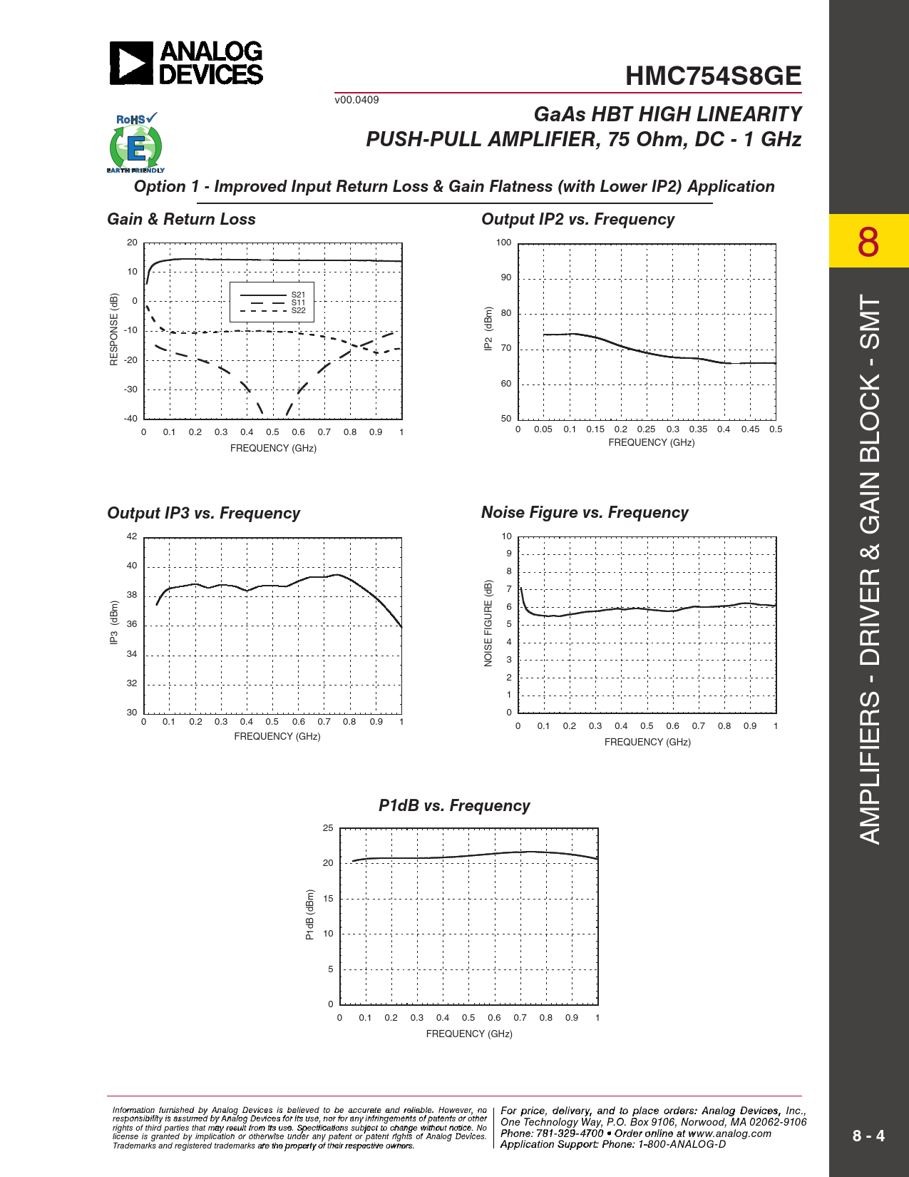

DescriptionGaAs HBT High Linearity Push-Pull Amplifier, 75 Ohm, DC - 1 GHz

GaAs HBT HIGH LINEARITY PUSH-PULL AMPLIFIER, 75 Ohm, DC - 1 GHz Option 1 - Improved Input Return Loss & Gain Flatness (with Lower IP2) Application Gain & Return Loss Output IP2 vs. Frequency
20 100 8 10 90 ) S21 0 S11 (dB S22 ) m 80 T E S N -10 m O P 2 (dB S IP 70 s E -20 R 60 -30 k - c -40 50 0 0.1 0.2 0.3 0.4 0.5 0.6 0.7 0.8 0.9 1 0 0.05 0.1 0.15 0.2 0.25 0.3 0.35 0.4 0.45 0.5 FREQUENCY (GHz) lo FREQUENCY (GHz) in B
Output IP3 vs. Frequency Noise Figure vs. Frequency
A 42 10 9 40 8 ) 7 r & G 38 ) (dB E 6 e m R U 36 5 IG iv 3 (dB F IP E 4 IS r 34 O 3 N 2 32 1 s - D 30 0 0 0.1 0.2 0.3 0.4 0.5 0.6 0.7 0.8 0.9 1 0 0.1 0.2 0.3 0.4 0.5 0.6 0.7 0.8 0.9 1 r FREQUENCY (GHz) FREQUENCY (GHz) ie lif
P1dB vs. Frequency
p 25 m A 20 15 (dBm) 10 P1dB 5 0 0 0.1 0.2 0.3 0.4 0.5 0.6 0.7 0.8 0.9 1 FREQUENCY (GHz) Inf F or o m rat ip o r n ifc ur e n ,is hd e e d lbiv y e Anry alo a g n D d evi cto es ips la beclie ev eo d rtd o e b r e sa: ccH ur iattte itaen M d reliic a r bl o e w . H a o v weev eC r, o n r o For price, delivery, and to place orders: Analog Devices, Inc., responsibility is assumed by Analog Devices for its use, nor for any infringements of patents or other poration, 20 Alpha Road, Chelmsford, MA 01824 One Technology Way, P.O. Box 9106, Norwood, MA 02062-9106 Phone: 978-250-3343 Fax: 978-250-3373 rights of third parties that may result from its use. Specifications subject to change without notice. No Or P d hoe n r e O : 7 n- 81-li 3 n 2 e 9- a 4 t 7 0 www 0 • O . rdh e itt r o it n e li . n co e a m license is granted by implication or otherwise under any patent or patent rights of Analog Devices. t www.analog.com
