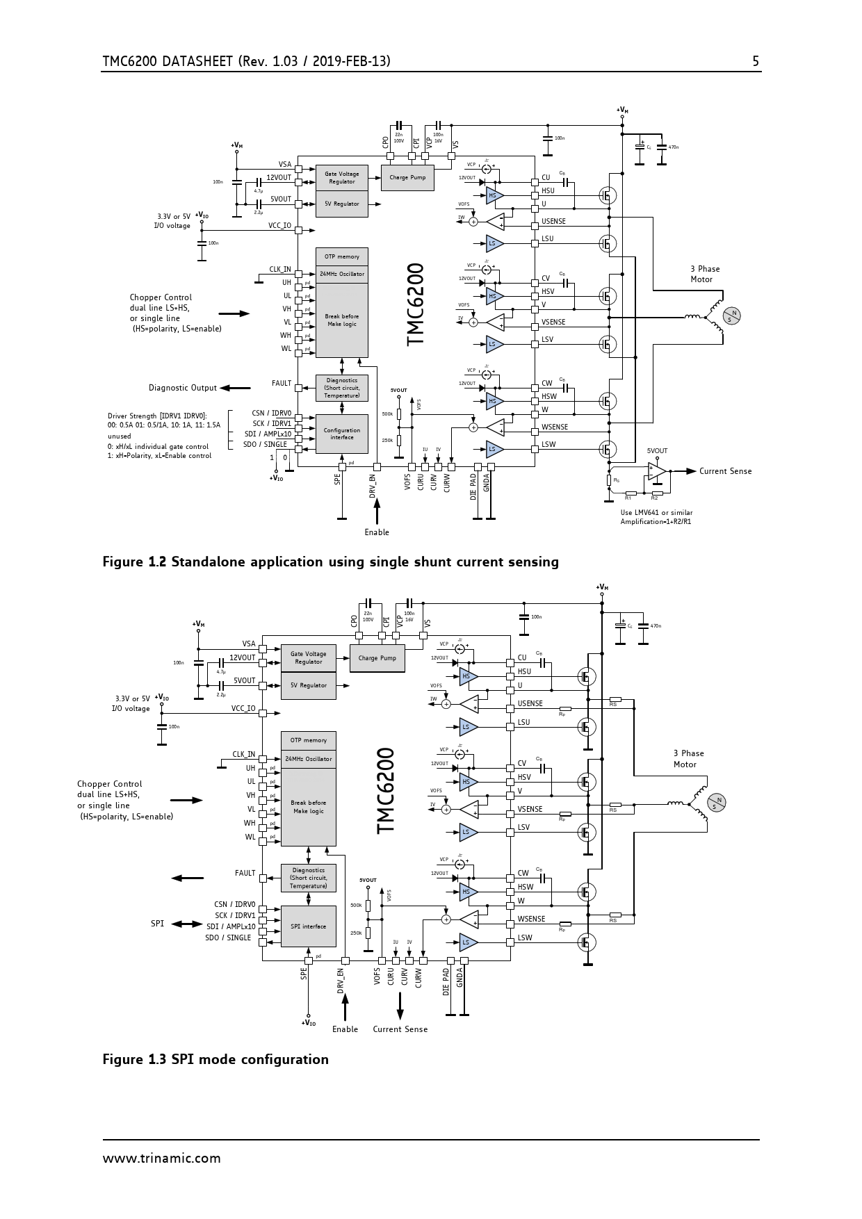

Pages / Page47 / 5 — +VM. +VIO. 5VOUT. Figure 1.2 Standalone application using single shunt …
+VM. +VIO. 5VOUT. Figure 1.2 Standalone application using single shunt current sensing. Figure 1.3 SPI mode configuration
+VM +VIO 5VOUT Figure 1.2 Standalone application using single shunt current sensing Figure 1.3 SPI mode configuration

Figure 1.2 Standalone application using single shunt current sensing +VM
