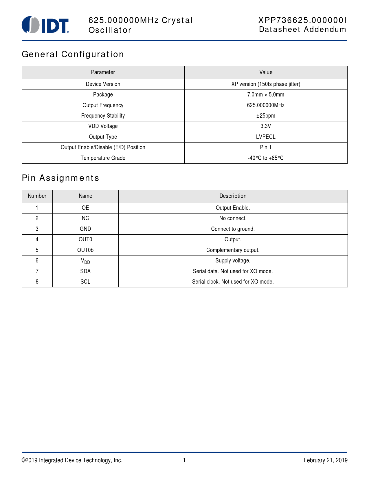

156.250000MHz Crystal. XPP736156.250000I. Oscillator. Datasheet Addendum. General Configuration. Parameter. Value. Pin Assignments
156.250000MHz Crystal XPP736156.250000I Oscillator Datasheet Addendum General Configuration Parameter Value
Device Version XP version (150fs phase jitter) Package 7.0mm × 5.0mm Output Frequency 156.250000MHz Frequency Stability ±25ppm VDD Voltage 3.3V Output Type LVPECL Output Enable/Disable (E/D) Position Pin 1 Temperature Grade -40°C to +85°C
Pin Assignments Number Name Description
1 OE Output Enable. 2 NC No connect. 3 GND Connect to ground. 4 OUT0 Output. 5 OUT0b Complementary output. 6 VDD Supply voltage. 7 SDA Serial data. Not used for XO mode. 8 SCL Serial clock. Not used for XO mode. ©2019 Integrated Device Technology, Inc. 1 February 21, 2019 Document Outline General Configuration Pin Assignments Revision History
