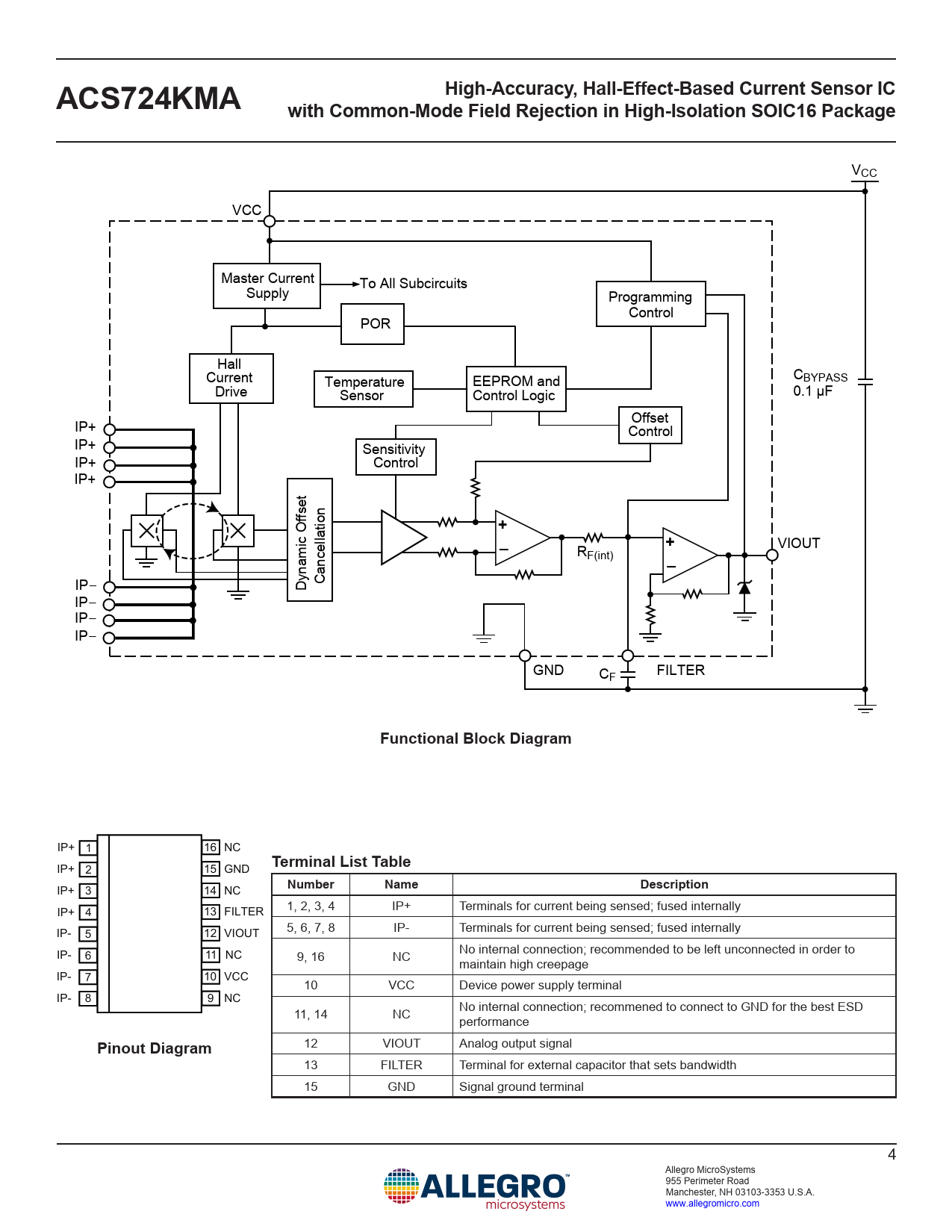

VCC VCC Master Current To All Subcircuits Supply Programming Control POR Hall Current Temperature EEPROM and CBYPASS Drive Sensor Control Logic 0.1 µF Offset IP+ Control IP+ Sensitivity IP+ Control IP+ ffset n
O latio
VIOUT cel RF(int)
ynamic an IP– D C IP– IP– IP– GND C FILTER F
Functional Block Diagram
IP+ 1 16 NC
Terminal List Table
IP+ 2 15 GND
Number Name Description
IP+ 3 14 NC 1, 2, 3, 4 IP+ Terminals for current being sensed; fused internally IP+ 4 13 FILTER 5, 6, 7, 8 IP- Terminals for current being sensed; fused internally IP- 5 12 VIOUT IP- 6 11 NC 9, 16 NC No internal connection; recommended to be left unconnected in order to maintain high creepage IP- 7 10 VCC 10 VCC Device power supply terminal IP- 8 9 NC 11, 14 NC No internal connection; recommened to connect to GND for the best ESD performance 12 VIOUT Analog output signal
Pinout Diagram
13 FILTER Terminal for external capacitor that sets bandwidth 15 GND Signal ground terminal 4 Allegro MicroSystems 955 Perimeter Road Manchester, NH 03103-3353 U.S.A. www.allegromicro.com
