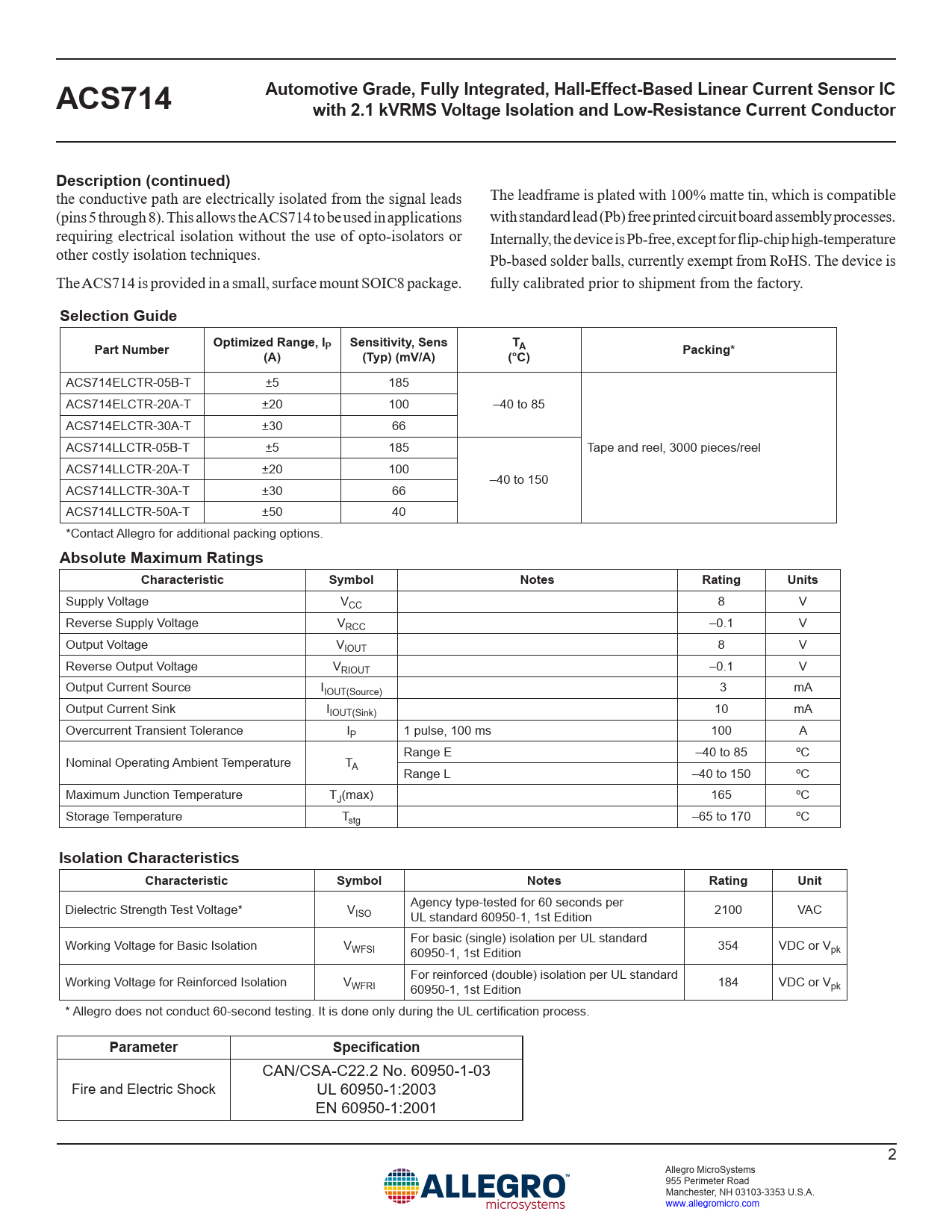

DescriptionAutomotive Grade, Fully Integrated, Hall Effect-Based Linear Current Sensor IC with 2.1 kVRMS Voltage Isolation and a Low-Resistance Current Conductor
Pages / Page19 / 3 — Automotive Grade, Fully Integrated, Hall-Effect-Based Linear Current …
Automotive Grade, Fully Integrated, Hall-Effect-Based Linear Current Sensor IC. ACS714
Automotive Grade, Fully Integrated, Hall-Effect-Based Linear Current Sensor IC ACS714
Automotive Grade, Fully Integrated, Hall-Effect-Based Linear Current Sensor IC ACS714 with 2.1 kVRMS Voltage Isolation and Low-Resistance Current Conductor Description (continued)
the conductive path are electrically isolated from the signal leads The leadframe is plated with 100% matte tin, which is compatible (pins 5 through 8). This allows the ACS714 to be used in applications with standard lead (Pb) free printed circuit board assembly processes. requiring electrical isolation without the use of opto-isolators or Internally, the device is Pb-free, except for flip-chip high-temperature other costly isolation techniques. Pb-based solder balls, currently exempt from RoHS. The device is The ACS714 is provided in a small, surface mount SOIC8 package. fully calibrated prior to shipment from the factory.
Selection Guide Part Number Optimized Range, IP Sensitivity, Sens TA (A) (Typ) (mV/A) (°C) Packing*
ACS714ELCTR-05B-T ±5 185 ACS714ELCTR-20A-T ±20 100 –40 to 85 ACS714ELCTR-30A-T ±30 66 ACS714LLCTR-05B-T ±5 185 Tape and reel, 3000 pieces/reel ACS714LLCTR-20A-T ±20 100 –40 to 150 ACS714LLCTR-30A-T ±30 66 ACS714LLCTR-50A-T ±50 40 *Contact Allegro for additional packing options.
Absolute Maximum Ratings Characteristic Symbol Notes Rating Units
Supply Voltage VCC 8 V Reverse Supply Voltage VRCC –0.1 V Output Voltage VIOUT 8 V Reverse Output Voltage VRIOUT –0.1 V Output Current Source IIOUT(Source) 3 mA Output Current Sink IIOUT(Sink) 10 mA Overcurrent Transient Tolerance IP 1 pulse, 100 ms 100 A Range E –40 to 85 ºC Nominal Operating Ambient Temperature TA Range L –40 to 150 ºC Maximum Junction Temperature TJ(max) 165 ºC Storage Temperature Tstg –65 to 170 ºC
Isolation Characteristics Characteristic Symbol Notes Rating Unit
Dielectric Strength Test Voltage* V Agency type-tested for 60 seconds per ISO UL standard 60950-1, 1st Edition 2100 VAC Working Voltage for Basic Isolation V For basic (single) isolation per UL standard WFSI 60950-1, 1st Edition 354 VDC or Vpk Working Voltage for Reinforced Isolation V For reinforced (double) isolation per UL standard WFRI 60950-1, 1st Edition 184 VDC or Vpk * Allegro does not conduct 60-second testing. It is done only during the UL certification process.
Parameter Specification
CAN/CSA-C22.2 No. 60950-1-03 Fire and Electric Shock UL 60950-1:2003 EN 60950-1:2001 2 Allegro MicroSystems 955 Perimeter Road Manchester, NH 03103-3353 U.S.A. www.allegromicro.com
