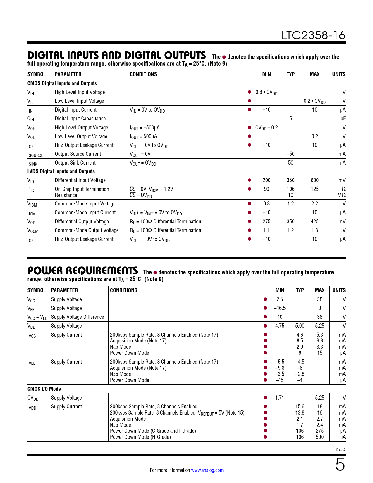

DIGITAL INPUTS AND DIGITAL OUTPUTS. The. denotes the specifications which apply over the
DIGITAL INPUTS AND DIGITAL OUTPUTS The denotes the specifications which apply over the
LTC2358-16
l
denotes the specifications which apply over the full operating temperature range, otherwise specifications are at TA = 25°C. (Note 9) SYMBOL PARAMETER CONDITIONS MIN TYP MAX UNITS CMOS Digital Inputs and Outputs
VIH High Level Input Voltage l 0.8 • OVDD V VIL Low Level Input Voltage l 0.2 • OVDD V IIN Digital Input Current VIN = 0V to OVDD l –10 10 μA CIN Digital Input Capacitance 5 pF VOH High Level Output Voltage IOUT = –500μA l OVDD – 0.2 V VOL Low Level Output Voltage IOUT = 500μA l 0.2 V IOZ Hi-Z Output Leakage Current VOUT = 0V to OVDD l –10 10 μA ISOURCE Output Source Current VOUT = 0V –50 mA ISINK Output Sink Current VOUT = OVDD 50 mA
LVDS Digital Inputs and Outputs
VID Differential Input Voltage l 200 350 600 mV RID On-Chip Input Termination CS = 0V, VICM = 1.2V l 90 106 125 Ω Resistance CS = OVDD 10 MΩ VICM Common-Mode Input Voltage l 0.3 1.2 2.2 V IICM Common-Mode Input Current VIN+ = VIN– = 0V to OVDD l –10 10 μA VOD Differential Output Voltage RL = 100Ω Differential Termination l 275 350 425 mV VOCM Common-Mode Output Voltage RL = 100Ω Differential Termination l 1.1 1.2 1.3 V IOZ Hi-Z Output Leakage Current VOUT = 0V to OVDD l –10 10 μA
POWER REQUIREMENTS The
l
VCC Supply Voltage l 7.5 38 V VEE Supply Voltage l –16.5 0 V VCC − VEE Supply Voltage Difference l 10 38 V VDD Supply Voltage l 4.75 5.00 5.25 V IVCC Supply Current 200ksps Sample Rate, 8 Channels Enabled (Note 17) l 4.6 5.3 mA Acquisition Mode (Note 17) l 8.5 9.8 mA Nap Mode l 2.9 3.3 mA Power Down Mode l 6 15 μA IVEE Supply Current 200ksps Sample Rate, 8 Channels Enabled (Note 17) l –5.5 –4.5 mA Acquisition Mode (Note 17) l –9.8 –8 mA Nap Mode l –3.5 –2.8 mA Power Down Mode l –15 –4 μA
