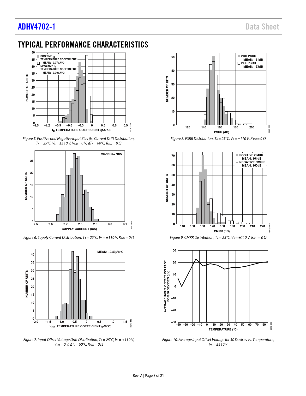

ADHV4702-1. Data Sheet. TYPICAL PERFORMANCE CHARACTERISTICS. POSITIVE I. VCC PSRR. TEMPERATURE COEFFICIENT. MEAN: 161dB
ADHV4702-1 Data Sheet TYPICAL PERFORMANCE CHARACTERISTICS POSITIVE I VCC PSRR TEMPERATURE COEFFICIENT MEAN: 161dB
ADHV4702-1 Data Sheet TYPICAL PERFORMANCE CHARACTERISTICS 50 POSITIVE I VCC PSRR B 50 45 TEMPERATURE COEFFICIENT MEAN: 161dB MEAN: –0.37pA/°C VEE PSRR 40 NEGATIVE IB MEAN: 163dB TEMPERATURE COEFFICIENT 40 35 MEAN: –0.30pA/°C S TI S N T 30 U HI F F 30 O 25 R R O E B 20 BE M U 20 N 15 NUM 10 10 5 0 –1.5 –1.2 –0.9 –0.6 –0.3 0 0.3 0.6 0.9

16047- Figure 5. Positive and Negative Input Bias (IB) Current Drift Distribution, Figure 8. PSRR Distribution, TA = 25°C, VS = ±110 V, RADJ = 0 Ω TA = 25°C, VS = ±110 V, VCM = 0 V, ∆TA = 60°C, RADJ = 0 Ω
MEAN: 2.77mA 70 POSITIVE CMRR MEAN: 161dB 25 NEGATIVE CMRR 60 MEAN: 163dB S 20 T S 50 T UNI F UNI 15 F 40 R O R O BE BE 30 10 NUM NUM 20 5 10 0 2.5 2.6 2.7 2.8 2.9 3.0 3.1

16047- Figure 6. Supply Current Distribution, TA = 25°C, VS = ±110 V, RADJ = 0 Ω Figure 9. CMRR Distribution, TA = 25°C, VS = ±110 V, RADJ = 0 Ω
MEAN: –0.49µV/°C 30 40 E 35 20 AG LT S 30 TI VO V) 10 N U 25 F SET ES (µ O F F C R O 0 E 20 EVI B T D M PU 0 U 15 N 5 N R E I O –10 G F 10 A VER 5 –20 A 0

16047- Figure 7. Input Offset Voltage Drift Distribution, TA = 25°C, VS = ±110 V, Figure 10. Average Input Offset Voltage for 50 Devices vs. Temperature, VCM = 0 V, ∆TJ = 60°C, RADJ = 0 Ω VS = ±110 V Rev. A | Page 8 of 21 Document Outline FEATURES APPLICATIONS GENERAL DESCRIPTION TYPICAL APPLICATION CIRCUIT TABLE OF CONTENTS REVISION HISTORY FUNCTIONAL BLOCK DIAGRAM SPECIFICATIONS ±12 V TO ±110 V SUPPLY ABSOLUTE MAXIMUM RATINGS MAXIMUM POWER DISSIPATION THERMAL RESISTANCE ESD CAUTION PIN CONFIGURATION AND FUNCTION DESCRIPTIONS TYPICAL PERFORMANCE CHARACTERISTICS THEORY OF OPERATION INTERNAL ELECTROSTATIC DISCHARGE (ESD) PROTECTION SLEW BOOST CIRCUIT AND PROTECTION DIGITAL GROUND (DGND) RESISTOR ADJUSTABLE QUIESCENT CURRENT (RADJ) SHUTDOWN PIN (SDB) TEMPERATURE MONITOR (TMP) OVERTEMPERATURE PROTECTION OUTPUT CURRENT DRIVE AND SHORT-CIRCUIT PROTECTION EXTERNAL COMPENSATION AND CAPACITIVE LOAD (CLOAD) DRIVING SAFE OPERATING AREA LFCSP PACKAGE AND HIGH VOLTAGE PIN SPACING EXPOSED PAD (EPAD) APPLICATIONS INFORMATION POWER SUPPLY AND DECOUPLING HIGH VOLTAGE GUARD RING HIGH VOLTAGE DAC VOLTAGE SUBTRACTOR HIGH CURRENT OUTPUT DRIVER SIGNAL RANGE EXTENDER OUTLINE DIMENSIONS ORDERING GUIDE
