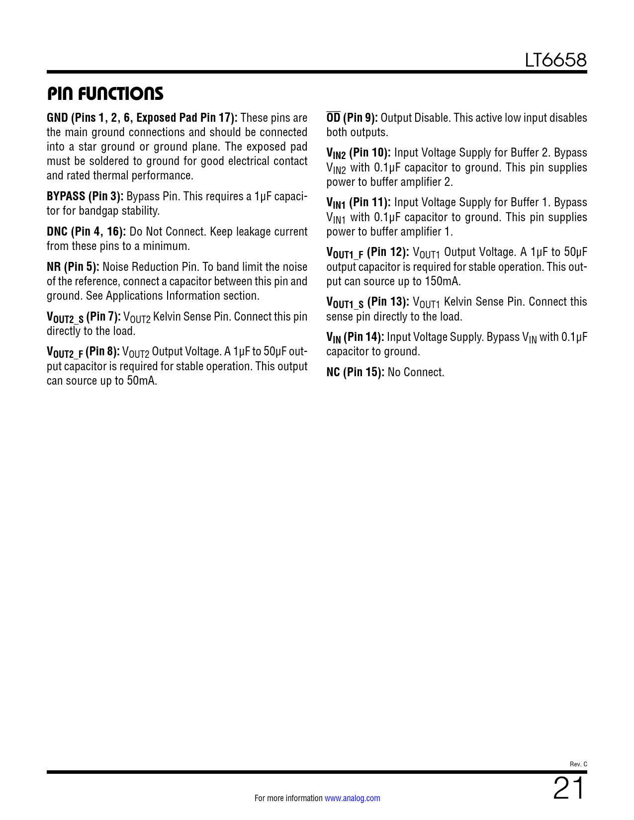

PIN FUNCTIONS GND (Pins 1, 2, 6, Exposed Pad Pin 17):
These pins are
OD (Pin 9):
Output Disable. This active low input disables the main ground connections and should be connected both outputs. into a star ground or ground plane. The exposed pad
V
must be soldered to ground for good electrical contact
IN2 (Pin 10):
Input Voltage Supply for Buffer 2. Bypass V and rated thermal performance. IN2 with 0.1μF capacitor to ground. This pin supplies power to buffer amplifier 2.
BYPASS (Pin 3):
Bypass Pin. This requires a 1μF capaci-
V
tor for bandgap stability.
IN1 (Pin 11):
Input Voltage Supply for Buffer 1. Bypass VIN1 with 0.1μF capacitor to ground. This pin supplies
DNC (Pin 4, 16):
Do Not Connect. Keep leakage current power to buffer amplifier 1. from these pins to a minimum.
VOUT1_F (Pin 12):
VOUT1 Output Voltage. A 1μF to 50μF
NR (Pin 5):
Noise Reduction Pin. To band limit the noise output capacitor is required for stable operation. This out- of the reference, connect a capacitor between this pin and put can source up to 150mA. ground. See Applications Information section.
VOUT1_S (Pin 13):
VOUT1 Kelvin Sense Pin. Connect this
VOUT2_S (Pin 7):
VOUT2 Kelvin Sense Pin. Connect this pin sense pin directly to the load. directly to the load.
VIN (Pin 14):
Input Voltage Supply. Bypass VIN with 0.1μF
VOUT2_F (Pin 8):
VOUT2 Output Voltage. A 1μF to 50μF out- capacitor to ground. put capacitor is required for stable operation. This output
NC (Pin 15):
No Connect. can source up to 50mA. Rev. C For more information www.analog.com 21 Document Outline Features Applications Typical Application Description Absolute Maximum Ratings Pin Configuration Order Information Available Options Electrical Characteristics Typical Performance Characteristics Pin Functions Block Diagram Applications Information Typical Applications Package Description Revision History Typical Application Related Parts
