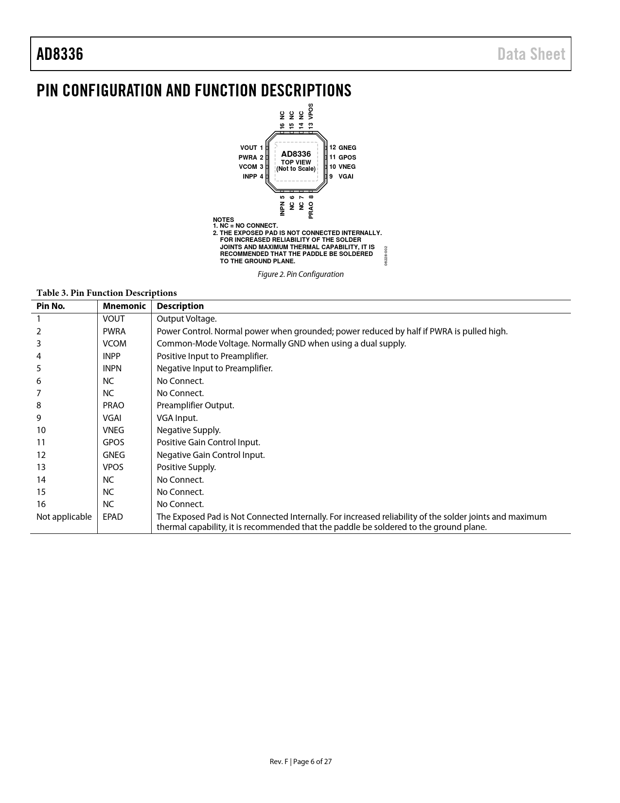

AD8336. Data Sheet. PIN CONFIGURATION AND FUNCTION DESCRIPTIONS. VPO. VOUT 1. 12 GNEG. PWRA 2. 11 GPOS. TOP VIEW. VCOM 3. 10 VNEG
AD8336 Data Sheet PIN CONFIGURATION AND FUNCTION DESCRIPTIONS VPO VOUT 1 12 GNEG PWRA 2 11 GPOS TOP VIEW VCOM 3 10 VNEG
AD8336 Data Sheet PIN CONFIGURATION AND FUNCTION DESCRIPTIONS S NC NC NC VPO 16 15 14 13 VOUT 1 12 GNEG AD8336 PWRA 2 11 GPOS TOP VIEW VCOM 3 10 VNEG (Not to Scale) INPP 4 9 VGAI 5 6 7 8 N NC NC INP RAO NOTES P 1. NC = NO CONNECT. 2. THE EXPOSED PAD IS NOT CONNECTED INTERNALLY. FOR INCREASED RELIABILITY OF THE SOLDER JOINTS AND MAXIMUM THERMAL CAPABILITY, IT IS RECOMMENDED THAT THE PADDLE BE SOLDERED
002
TO THE GROUND PLANE.
06228- Figure 2. Pin Configuration
Table 3. Pin Function Descriptions Pin No. Mnemonic Description
1 VOUT Output Voltage. 2 PWRA Power Control. Normal power when grounded; power reduced by half if PWRA is pulled high. 3 VCOM Common-Mode Voltage. Normally GND when using a dual supply. 4 INPP Positive Input to Preamplifier. 5 INPN Negative Input to Preamplifier. 6 NC No Connect. 7 NC No Connect. 8 PRAO Preamplifier Output. 9 VGAI VGA Input. 10 VNEG Negative Supply. 11 GPOS Positive Gain Control Input. 12 GNEG Negative Gain Control Input. 13 VPOS Positive Supply. 14 NC No Connect. 15 NC No Connect. 16 NC No Connect. Not applicable EPAD The Exposed Pad is Not Connected Internally. For increased reliability of the solder joints and maximum thermal capability, it is recommended that the paddle be soldered to the ground plane. Rev. F | Page 6 of 27 Document Outline FEATURES APPLICATIONS GENERAL DESCRIPTION FUNCTIONAL BLOCK DIAGRAM TABLE OF CONTENTS REVISION HISTORY SPECIFICATIONS ABSOLUTE MAXIMUM RATINGS ESD CAUTION PIN CONFIGURATION AND FUNCTION DESCRIPTIONS TYPICAL PERFORMANCE CHARACTERISTICS TEST CIRCUITS THEORY OF OPERATION OVERVIEW PREAMPLIFIER VGA SETTING THE GAIN NOISE OFFSET VOLTAGE APPLICATIONS INFORMATION AMPLIFIER CONFIGURATION PREAMPLIFIER Circuit Configuration for Noninverting Gain Circuit Configuration for Inverting Gain USING THE POWER ADJUST FEATURE DRIVING CAPACITIVE LOADS EVALUATION BOARD OPTIONAL CIRCUITRY BOARD LAYOUT CONSIDERATIONS OUTLINE DIMENSIONS ORDERING GUIDE
