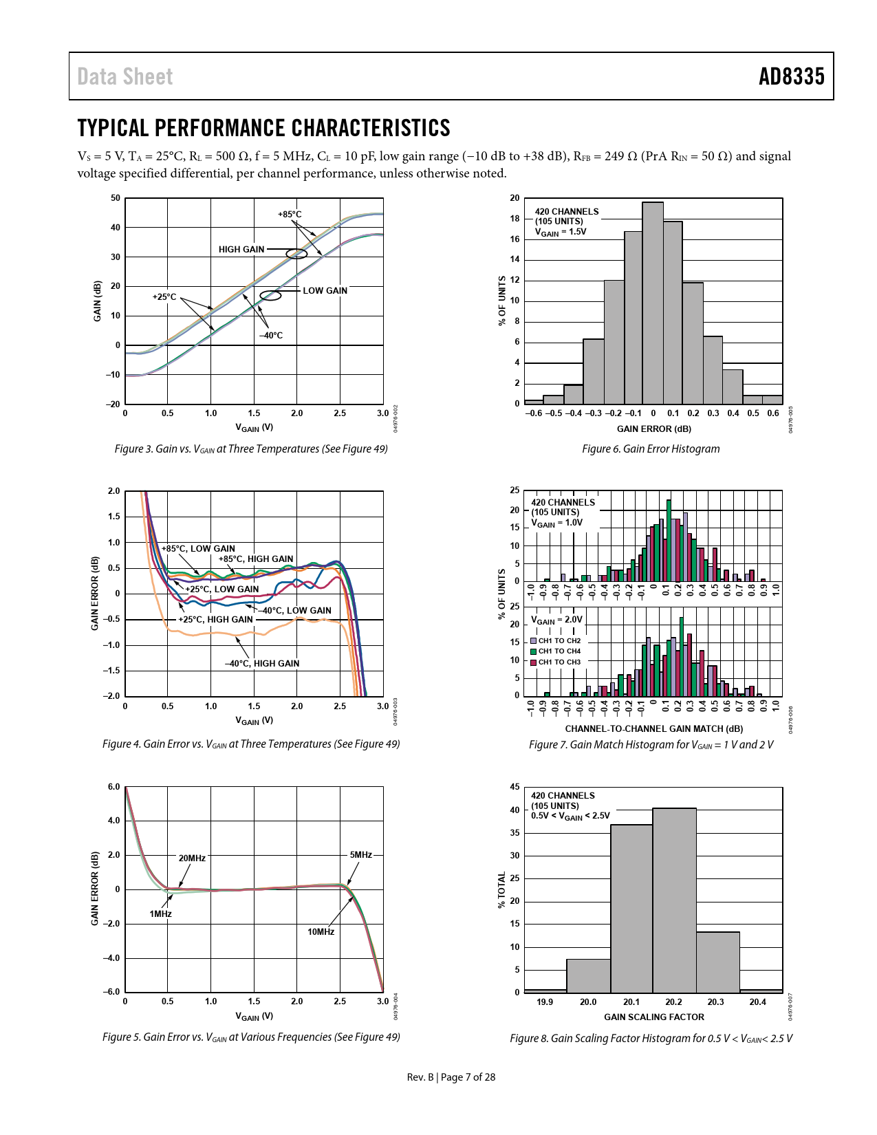

Data Sheet AD8335 TYPICAL PERFORMANCE CHARACTERISTICS
VS = 5 V, TA = 25°C, RL = 500 Ω, f = 5 MHz, CL = 10 pF, low gain range (−10 dB to +38 dB), RFB = 249 Ω (PrA RIN = 50 Ω) and signal voltage specified differential, per channel performance, unless otherwise noted.

04 Figure 3. Gain vs. VGAIN at Three Temperatures (See Figure 49) Figure 6. Gain Error Histogram

97 04 Figure 4. Gain Error vs. VGAIN at Three Temperatures (See Figure 49) Figure 7. Gain Match Histogram for VGAIN = 1 V and 2 V

0 Figure 5. Gain Error vs. VGAIN at Various Frequencies (See Figure 49) Figure 8. Gain Scaling Factor Histogram for 0.5 V < VGAIN< 2.5 V Rev. B | Page 7 of 28 Document Outline FEATURES APPLICATIONS GENERAL DESCRIPTION FUNCTIONAL BLOCK DIAGRAM TABLE OF CONTENTS REVISION HISTORY SPECIFICATIONS ABSOLUTE MAXIMUM RATINGS ESD CAUTION PIN CONFIGURATION AND FUNCTION DESCRIPTIONS TYPICAL PERFORMANCE CHARACTERISTICS TEST CIRCUITS THEORY OF OPERATION ENABLE SUMMARY PREAMP Noise VGA Optimizing the System Dynamic Range Attenuator Gain Control Output Stage VGA Noise APPLICATIONS INFORMATION ULTRASOUND BASIC CONNECTIONS PREAMP CONNECTIONS INPUT OVERDRIVE Input Overload Protection LOGIC INPUTS COMMON-MODE PINS DRIVING ADCs EVALUATION BOARD BOARD LAYOUT OUTLINE DIMENSIONS ORDERING GUIDE
