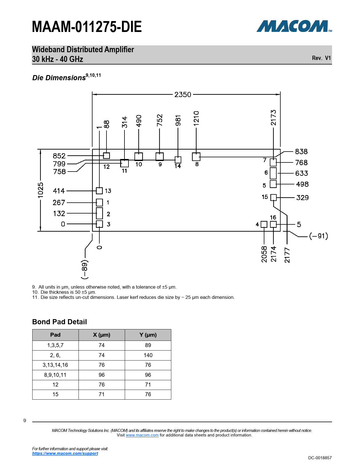

Pages / Page10 / 9 — MAAM-011275-DIE. Wideband Distributed Amplifier. 30 kHz - 40 GHz. Rev. …
MAAM-011275-DIE. Wideband Distributed Amplifier. 30 kHz - 40 GHz. Rev. V1. Die Dimensions. 9,10,11. Bond Pad Detail
MAAM-011275-DIE Wideband Distributed Amplifier 30 kHz - 40 GHz Rev V1 Die Dimensions 9,10,11 Bond Pad Detail
MAAM-011275-DIE Wideband Distributed Amplifier 30 kHz - 40 GHz Rev. V1 Die Dimensions 9,10,11
9. All units in µm, unless otherwise noted, with a tolerance of ±5 µm. 10. Die thickness is 50 ±5 µm. 11. Die size reflects un-cut dimensions. Laser kerf reduces die size by ~ 25 µm each dimension.
Bond Pad Detail
1,3,5,7 74 89 2, 6, 74 140 3,13,14,16 76 76 8,9,10,11 96 96 12 76 71 15 71 76 9 MACOM Technology Solutions Inc. (MACOM) and its affiliates reserve the right to make changes to the product(s) or information contained herein without notice.
