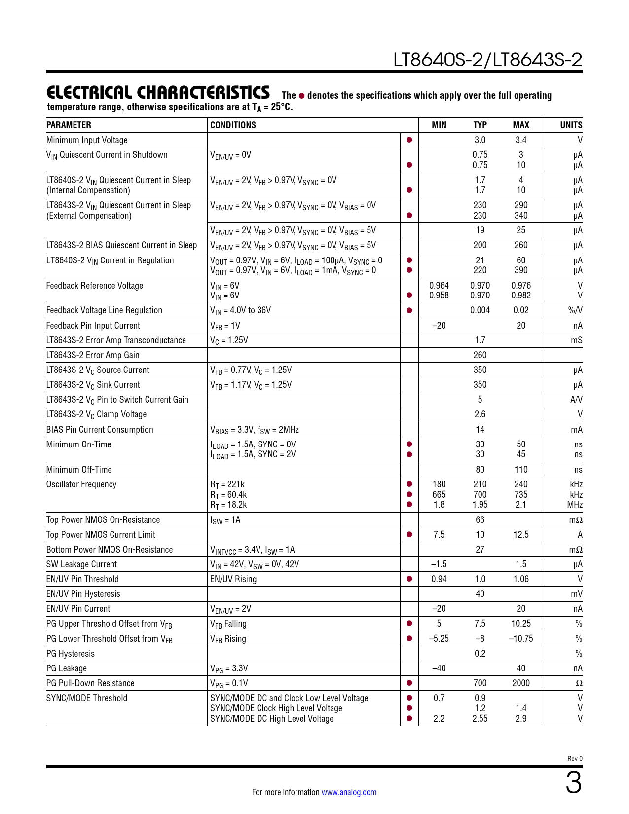

Description42V, 6A Synchronous Step-Down Silent Switcher with 2.5µA Quiescent Current

denotes the specifications which apply over the full operating temperature range, otherwise specifications are at TA = 25°C. PARAMETER CONDITIONS MIN TYP MAX UNITS
Minimum Input Voltage l 3.0 3.4 V VIN Quiescent Current in Shutdown VEN/UV = 0V 0.75 3 µA l 0.75 10 µA LT8640S-2 VIN Quiescent Current in Sleep VEN/UV = 2V, VFB > 0.97V, VSYNC = 0V 1.7 4 µA (Internal Compensation) l 1.7 10 µA LT8643S-2 VIN Quiescent Current in Sleep VEN/UV = 2V, VFB > 0.97V, VSYNC = 0V, VBIAS = 0V 230 290 µA (External Compensation) l 230 340 µA VEN/UV = 2V, VFB > 0.97V, VSYNC = 0V, VBIAS = 5V 19 25 µA LT8643S-2 BIAS Quiescent Current in Sleep VEN/UV = 2V, VFB > 0.97V, VSYNC = 0V, VBIAS = 5V 200 260 µA LT8640S-2 VIN Current in Regulation VOUT = 0.97V, VIN = 6V, ILOAD = 100µA, VSYNC = 0 l 21 60 µA VOUT = 0.97V, VIN = 6V, ILOAD = 1mA, VSYNC = 0 l 220 390 µA Feedback Reference Voltage VIN = 6V 0.964 0.970 0.976 V VIN = 6V l 0.958 0.970 0.982 V Feedback Voltage Line Regulation VIN = 4.0V to 36V l 0.004 0.02 %/V Feedback Pin Input Current VFB = 1V –20 20 nA LT8643S-2 Error Amp Transconductance VC = 1.25V 1.7 mS LT8643S-2 Error Amp Gain 260 LT8643S-2 VC Source Current VFB = 0.77V, VC = 1.25V 350 µA LT8643S-2 VC Sink Current VFB = 1.17V, VC = 1.25V 350 µA LT8643S-2 VC Pin to Switch Current Gain 5 A/V LT8643S-2 VC Clamp Voltage 2.6 V BIAS Pin Current Consumption VBIAS = 3.3V, fSW = 2MHz 14 mA Minimum On-Time ILOAD = 1.5A, SYNC = 0V l 30 50 ns ILOAD = 1.5A, SYNC = 2V l 30 45 ns Minimum Off-Time 80 110 ns Oscillator Frequency RT = 221k l 180 210 240 kHz RT = 60.4k l 665 700 735 kHz RT = 18.2k l 1.8 1.95 2.1 MHz Top Power NMOS On-Resistance ISW = 1A 66 mΩ Top Power NMOS Current Limit l 7.5 10 12.5 A Bottom Power NMOS On-Resistance VINTVCC = 3.4V, ISW = 1A 27 mΩ SW Leakage Current VIN = 42V, VSW = 0V, 42V –1.5 1.5 µA EN/UV Pin Threshold EN/UV Rising l 0.94 1.0 1.06 V EN/UV Pin Hysteresis 40 mV EN/UV Pin Current VEN/UV = 2V –20 20 nA PG Upper Threshold Offset from VFB VFB Falling l 5 7.5 10.25 % PG Lower Threshold Offset from VFB VFB Rising l –5.25 –8 –10.75 % PG Hysteresis 0.2 % PG Leakage VPG = 3.3V –40 40 nA PG Pull-Down Resistance VPG = 0.1V l 700 2000 Ω SYNC/MODE Threshold SYNC/MODE DC and Clock Low Level Voltage l 0.7 0.9 V SYNC/MODE Clock High Level Voltage l 1.2 1.4 V SYNC/MODE DC High Level Voltage l 2.2 2.55 2.9 V Rev 0 For more information www.analog.com 3 Document Outline FEATURES DESCRIPTION APPLICATIONS TYPICAL APPLICATION ABSOLUTE MAXIMUM RATINGS PIN CONFIGURATION ORDER INFORMATION E LECTRICAL CHARACTERISTICS TYPICAL PERFORMANCE CHARACTERISTICS PIN FUNCTIONS BLOCK DIAGRAM OPERATION APPLICATIONS INFORMATION TYPICAL APPLICATIONS PACKAGE DESCRIPTION TYPICAL APPLICATIONS RELATED PARTS
