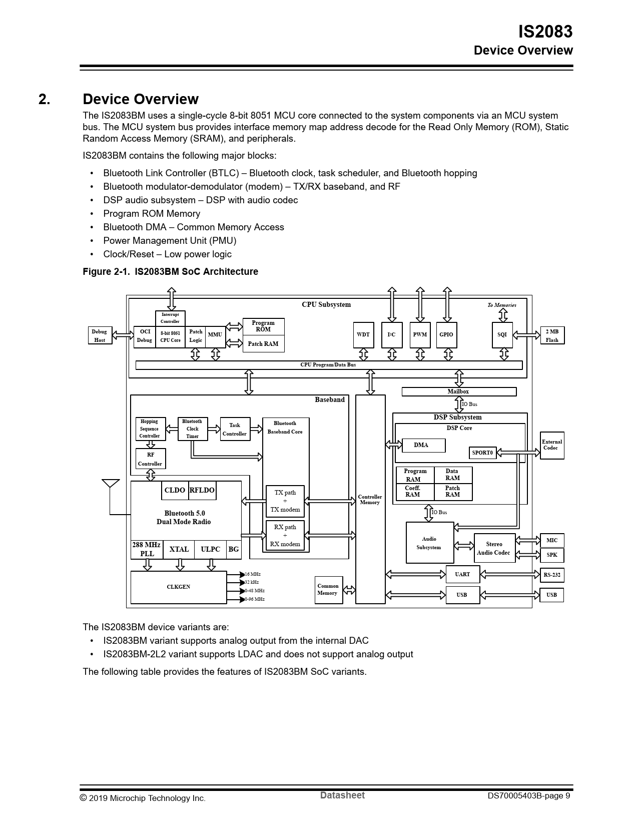

IS2083. Device Overview. Figure 2-1. IS2083BM SoC Architecture. CPU Subsystem. To Memories. Interrupt. Controller. Program. ROM. Debug. OCI
IS2083 Device Overview 2. Device Overview
The IS2083BM uses a single-cycle 8-bit 8051 MCU core connected to the system components via an MCU system bus. The MCU system bus provides interface memory map address decode for the Read Only Memory (ROM), Static Random Access Memory (SRAM), and peripherals. IS2083BM contains the following major blocks: • Bluetooth Link Controller (BTLC) – Bluetooth clock, task scheduler, and Bluetooth hopping • Bluetooth modulator-demodulator (modem) – TX/RX baseband, and RF • DSP audio subsystem – DSP with audio codec • Program ROM Memory • Bluetooth DMA – Common Memory Access • Power Management Unit (PMU) • Clock/Reset – Low power logic
Figure 2-1. IS2083BM SoC Architecture CPU Subsystem To Memories Interrupt Controller Program ROM Debug OCI Patch 2 MB 8-bit 8051 MMU WDT I2C PWM GPIO SQI Host Debug CPU Core Logic Flash Patch RAM CPU Program/Data Bus Mailbox Baseband
IO Bus
DSP Subsystem Hopping Bluetooth Task Bluetooth Sequence Clock DSP Core Controller Baseband Core Controller Timer DMA External Codec RF SPORT0 Controller Program Data RAM RAM CLDO RFLDO Coeff. Patch
TX path
Controller RAM RAM
Memory Bluetooth 5.0
TX modem IO Bus
Dual Mode Radio
RX path +
Audio MIC
RX modem
Stereo 288 MHz XTAL ULPC BG Subsystem Audio Codec PLL SPK
16 MHz
UART RS-232
32 kHz
CLKGEN Common
0-48 MHz
Memory USB USB
0-96 MHz The IS2083BM device variants are: • IS2083BM variant supports analog output from the internal DAC • IS2083BM-2L2 variant supports LDAC and does not support analog output The following table provides the features of IS2083BM SoC variants. © 2019 Microchip Technology Inc.
