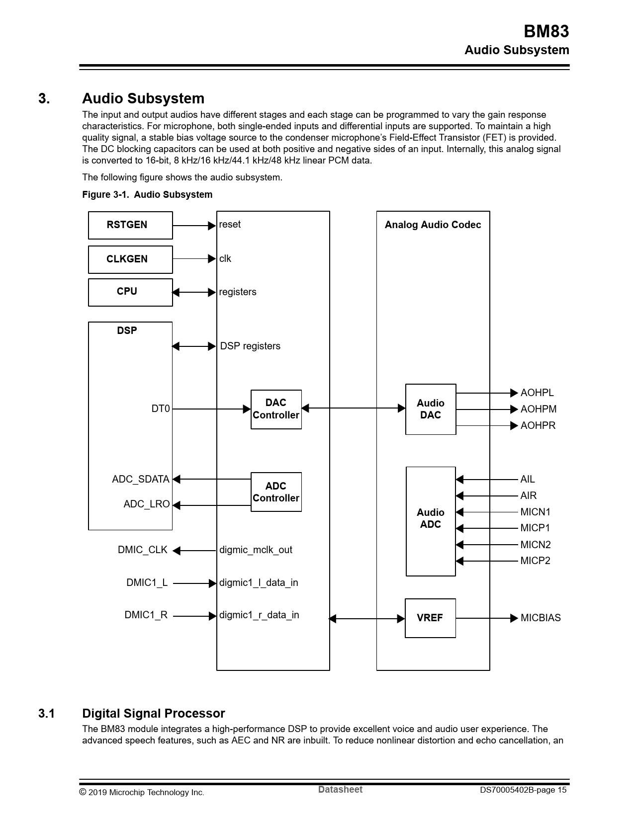

The input and output audios have different stages and each stage can be programmed to vary the gain response characteristics. For microphone, both single-ended inputs and differential inputs are supported. To maintain a high quality signal, a stable bias voltage source to the condenser microphone’s Field-Effect Transistor (FET) is provided. The DC blocking capacitors can be used at both positive and negative sides of an input. Internally, this analog signal is converted to 16-bit, 8 kHz/16 kHz/44.1 kHz/48 kHz linear PCM data. The following figure shows the audio subsystem.
Figure 3-1. Audio Subsystem RSTGEN
reset
Analog Audio Codec CLKGEN
clk
CPU
registers
DSP
DSP registers AOHPL
DAC
DT0
AOHPM
Controller DAC
AOHPR ADC_SDATA AIL
ADC Controller
AIR ADC_LRO
MICN1
ADC
MICP1 DMIC_CLK digmic_mclk_out MICN2 MICP2 DMIC1_L digmic1_l_data_in DMIC1_R digmic1_r_data_in
VREF
MICBIAS
