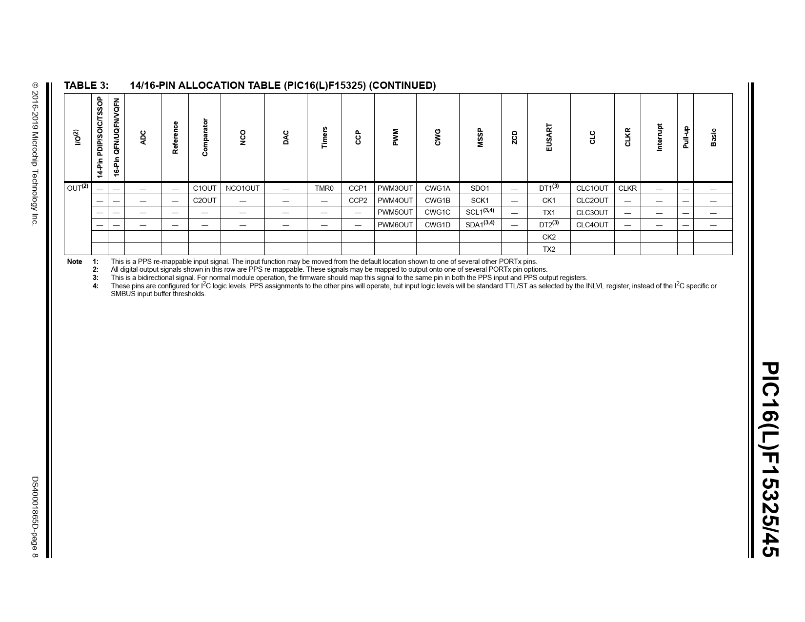

TABLE 3: 14/16-PIN ALLOCATION TABLE (PIC16(L)F15325) (CONTINUED)
-2019 Microchip
OP QFN /V N F ce tor T R pt (2) OIC/TSS G S O M ren ara SP D C K rru sic I/O ADC fe NC DAC imers ZC SAR CL T CCP PW CW MS CL Pull-up Ba Re EU Inte Comp in QFN/UQ
Technology In
in PDIP/ -P 14-P 16
OUT
(2)
― ― ― ― C1OUT NCO1OUT ― TMR0 CCP1 PWM3OUT CWG1A SDO1 ― DT1
(3)
CLC1OUT CLKR ― ― ― ― ― ― ― C2OUT ― ― ― CCP2 PWM4OUT CWG1B SCK1 ― CK1 CLC2OUT ― ― ― ― ― ― ― ― ― ― ― ― ― PWM5OUT CWG1C SCL1
(3,4)
― TX1 CLC3OUT ― ― ― ― c. ― ― ― ― ― ― ― ― ― PWM6OUT CWG1D SDA1
(3,4)
― DT2
(3)
CLC4OUT ― ― ― ― CK2 TX2
Note 1:
This is a PPS re-mappable input signal. The input function may be moved from the default location shown to one of several other PORTx pins.
2:
All digital output signals shown in this row are PPS re-mappable. These signals may be mapped to output onto one of several PORTx pin options.
3:
This is a bidirectional signal. For normal module operation, the firmware should map this signal to the same pin in both the PPS input and PPS output registers.
4:
These pins are configured for I2C logic levels. PPS assignments to the other pins wil operate, but input logic levels will be standard TTL/ST as selected by the INLVL register, instead of the I2C specific or SMBUS input buffer thresholds.
