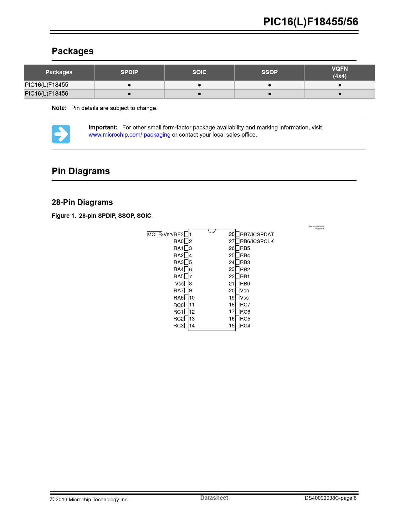

PIC16(L)F18455/56. Packages. VQFN. SPDIP. SOIC. SSOP. (4x4). Note: . Important: . Pin Diagrams. 28-Pin Diagrams
PIC16(L)F18455/56 Packages VQFN Packages SPDIP SOIC SSOP (4x4)
PIC16(L)F18455 ● ● ● ● PIC16(L)F18456 ● ● ● ●
Note:
Pin details are subject to change.
Important:
For other small form-factor package availability and marking information, visit www.microchip.com/ packaging or contact your local sales office. Fil
Pin Diagrams
ename: 00-000028A.vsd Title: 28-pin DIP Last Edit: 10/3/2018 First Used: N/A Notes: Generic 28-pin dual in-line diagram
28-Pin Diagrams Figure 1. 28-pin SPDIP, SSOP, SOIC
Rev. 00-000028A 10/3/2018 MCLR/VPP/RE3 1 28 RB7/ICSPDAT RA0 2 27 RB6/ICSPCLK RA1 3 26 RB5 RA2 4 25 RB4 RA3 5 24 RB3 RA4 6 23 RB2 RA5 7 22 RB1 VSS 8 21 RB0 RA7 9 20 VDD RA6 10 19 VSS RC0 11 18 RC7 RC1 12 17 RC6 RC2 13 16 RC5 RC3 14 15 RC4 © 2019 Microchip Technology Inc.
