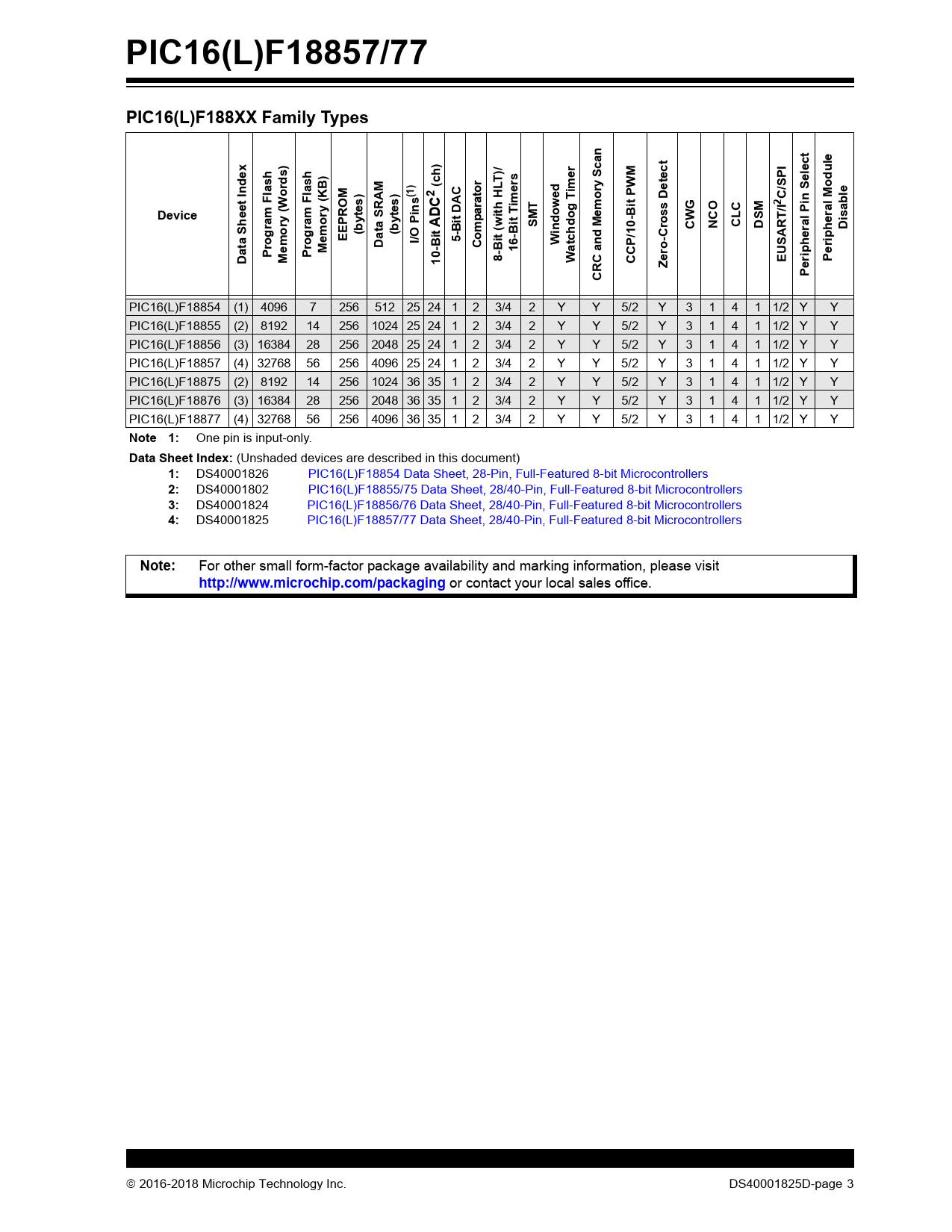

PIC16F18857
PIC16(L)F18857/77 PIC16(L)F188XX Family Types n le ) )/ r u dex elect ) LT etect S ords) (ch or ers ime ry Sca (1 2 ed o C/SPI le Flash Flash (KB) at im T it PWM G O C 2 Device eet In ry t DAC ar p ow og em eral Mod ram ram ytes) a SRAM ytes) ADC it T SMT M ross D CW NC CL DSM Disab g g (b Bi m ind C eral Pin a Sh o o EEPROM (b I/O Pins 5- W SART/I h Memo Dat -Bit Co 16-B atchd and Dat Pr Memory (W Pr 10 8-Bit (with H W CCP/10-B Periph Zero- EU CRC Perip
PIC16(L)F18854 (1) 4096 7 256 512 25 24 1 2 3/4 2 Y Y 5/2 Y 3 1 4 1 1/2 Y Y PIC16(L)F18855 (2) 8192 14 256 1024 25 24 1 2 3/4 2 Y Y 5/2 Y 3 1 4 1 1/2 Y Y PIC16(L)F18856 (3) 16384 28 256 2048 25 24 1 2 3/4 2 Y Y 5/2 Y 3 1 4 1 1/2 Y Y PIC16(L)F18857 (4) 32768 56 256 4096 25 24 1 2 3/4 2 Y Y 5/2 Y 3 1 4 1 1/2 Y Y PIC16(L)F18875 (2) 8192 14 256 1024 36 35 1 2 3/4 2 Y Y 5/2 Y 3 1 4 1 1/2 Y Y PIC16(L)F18876 (3) 16384 28 256 2048 36 35 1 2 3/4 2 Y Y 5/2 Y 3 1 4 1 1/2 Y Y PIC16(L)F18877 (4) 32768 56 256 4096 36 35 1 2 3/4 2 Y Y 5/2 Y 3 1 4 1 1/2 Y Y
Note 1:
One pin is input-only.
Data Sheet Index:
(Unshaded devices are described in this document)
1:
DS40001826 PIC16(L)F18854 Data Sheet, 28-Pin, Full-Featured 8-bit Microcontrollers
2:
DS40001802 PIC16(L)F18855/75 Data Sheet, 28/40-Pin, Full-Featured 8-bit Microcontrollers
3:
DS40001824 PIC16(L)F18856/76 Data Sheet, 28/40-Pin, Full-Featured 8-bit Microcontrollers
4:
DS40001825 PIC16(L)F18857/77 Data Sheet, 28/40-Pin, Full-Featured 8-bit Microcontrollers
