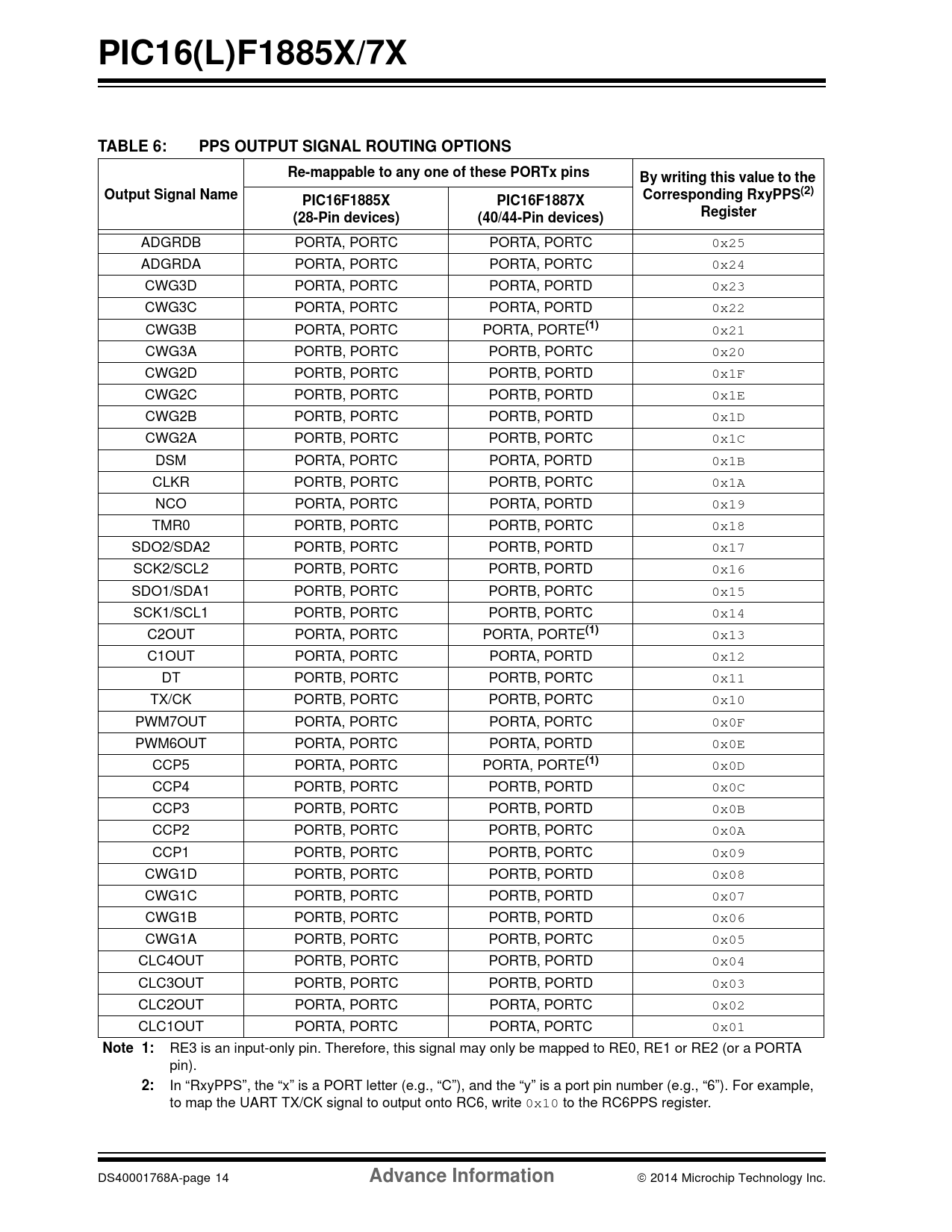

PIC16(L)F1885X/7X. TABLE 6: PPS OUTPUT SIGNAL ROUTING OPTIONS
PIC16(L)F1885X/7X
Re-mappable to any one of these PORTx pins Output Signal Name PIC16F1885X
(28-Pin devices) PIC16F1887X
(40/44-Pin devices) By writing this value to the
Corresponding RxyPPS(2)
Register ADGRDB PORTA, PORTC PORTA, PORTC 0x25 ADGRDA PORTA, PORTC PORTA, PORTC 0x24 CWG3D PORTA, PORTC PORTA, PORTD 0x23 CWG3C PORTA, PORTC PORTA, PORTD 0x22 CWG3B PORTA, PORTC PORTA, PORTE(1) 0x21 CWG3A PORTB, PORTC PORTB, PORTC 0x20 CWG2D PORTB, PORTC PORTB, PORTD 0x1F CWG2C PORTB, PORTC PORTB, PORTD 0x1E CWG2B PORTB, PORTC PORTB, PORTD 0x1D CWG2A PORTB, PORTC PORTB, PORTC 0x1C DSM PORTA, PORTC PORTA, PORTD 0x1B CLKR PORTB, PORTC PORTB, PORTC 0x1A NCO PORTA, PORTC PORTA, PORTD 0x19 TMR0 PORTB, PORTC PORTB, PORTC 0x18 SDO2/SDA2 PORTB, PORTC PORTB, PORTD 0x17 SCK2/SCL2 PORTB, PORTC PORTB, PORTD 0x16 SDO1/SDA1 PORTB, PORTC PORTB, PORTC 0x15 SCK1/SCL1 PORTB, PORTC PORTB, PORTC 0x14 C2OUT PORTA, PORTC PORTA, PORTE(1) 0x13 C1OUT PORTA, PORTC PORTA, PORTD 0x12 DT PORTB, PORTC PORTB, PORTC 0x11 TX/CK PORTB, PORTC PORTB, PORTC 0x10 PWM7OUT PORTA, PORTC PORTA, PORTC 0x0F PWM6OUT PORTA, PORTC PORTA, PORTD 0x0E CCP5 PORTA, PORTC PORTA, PORTE(1) 0x0D CCP4 PORTB, PORTC PORTB, PORTD 0x0C CCP3 PORTB, PORTC PORTB, PORTD 0x0B CCP2 PORTB, PORTC PORTB, PORTC 0x0A CCP1 PORTB, PORTC PORTB, PORTC 0x09 CWG1D PORTB, PORTC PORTB, PORTD 0x08 CWG1C PORTB, PORTC PORTB, PORTD 0x07 CWG1B PORTB, PORTC PORTB, PORTD 0x06 CWG1A PORTB, PORTC PORTB, PORTC 0x05 CLC4OUT PORTB, PORTC PORTB, PORTD 0x04 CLC3OUT PORTB, PORTC PORTB, PORTD 0x03 CLC2OUT PORTA, PORTC PORTA, PORTC 0x02 CLC1OUT PORTA, PORTC PORTA, PORTC 0x01 Note 1:
2: RE3 is an input-only pin. Therefore, this signal may only be mapped to RE0, RE1 or RE2 (or a PORTA
pin).
In “RxyPPS”, the “x” is a PORT letter (e.g., “C”), and the “y” is a port pin number (e.g., “6”). For example,
to map the UART TX/CK signal to output onto RC6, write 0x10 to the RC6PPS register. DS40001768A-page 14 Advance Information 2014 Microchip Technology Inc.
