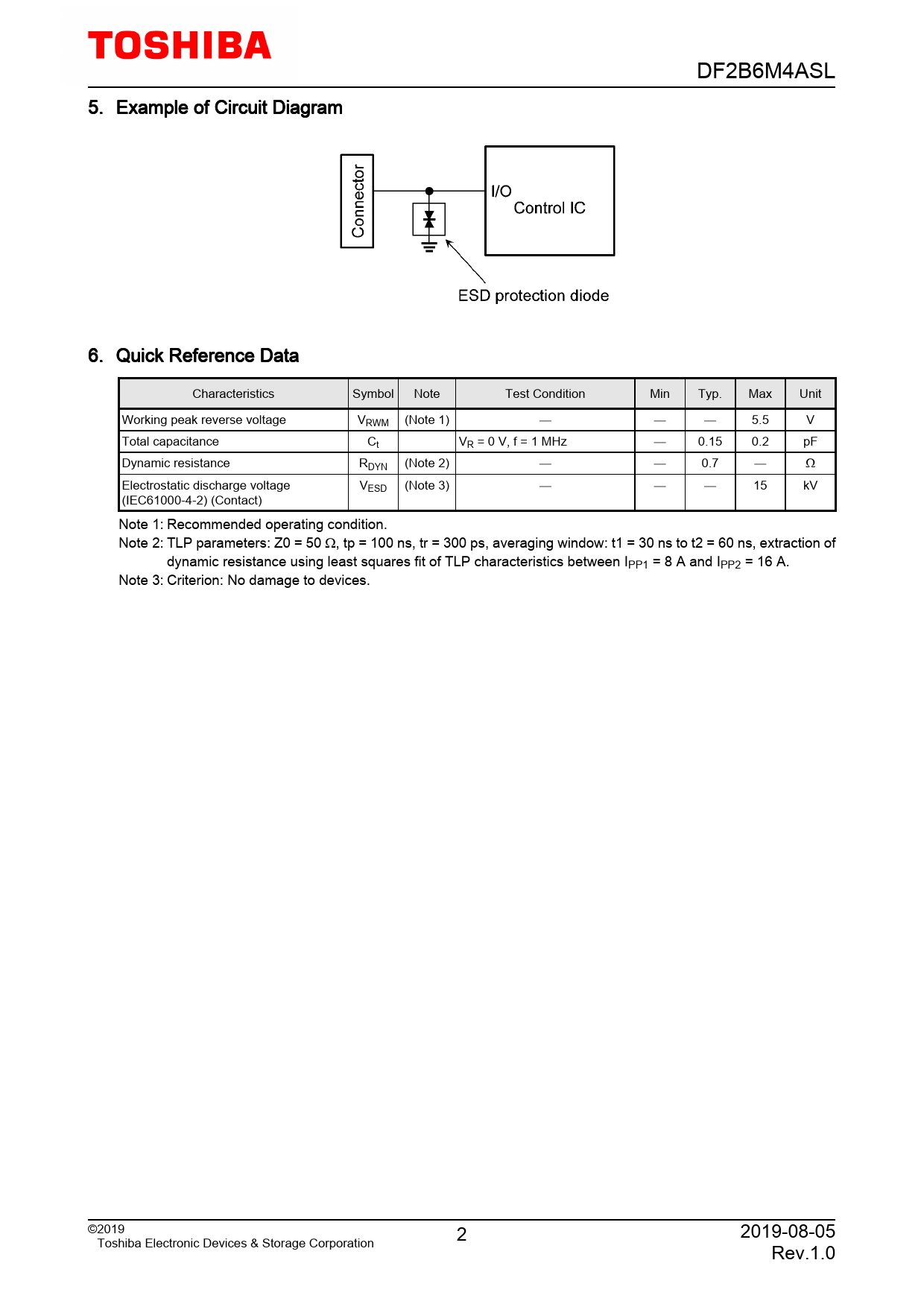

Pages / Page9 / 2 — DF2B6M4ASL. 5. Example. of. Circuit. Diagram. 6. Quick. Reference. Data. …
File Format / SizePDF / 364 Kb
DF2B6M4ASL. 5. Example. of. Circuit. Diagram. 6. Quick. Reference. Data. Characteristics. Symbol. Note. Test. Condition. Min. Typ. Max. Unit. Working. peak
DF2B6M4ASL 5 Example of Circuit Diagram 6 Quick Reference Data Characteristics Symbol Note Test Condition Min Typ Max Unit Working peak
DF2B6M4ASL 5. Example of Circuit Diagram 6. Quick Reference Data Characteristics Symbol Note Test Condition Min Typ. Max Unit Working peak reverse voltage VRWM (Note 1)    5.5 V Total capacitance Ct VR = 0 V, f = 1 MHz  0.15 0.2 pF Dynamic resistance RDYN (Note 2)   0.7  Ω Electrostatic discharge voltage VESD (Note 3)    15 kV (IEC61000-4-2) (Contact) Note 1: Recommended operating condition. Note 2: TLP parameters: Z0 = 50 Ω, tp = 100 ns, tr = 300 ps, averaging window: t1 = 30 ns to t2 = 60 ns, extraction of dynamic resistance using least squares fit of TLP characteristics between IPP1 = 8 A and IPP2 = 16 A. Note 3: Criterion: No damage to devices. ©2019 2 2019-08-05 Toshiba Electronic Devices & Storage Corporation Rev.1.0
