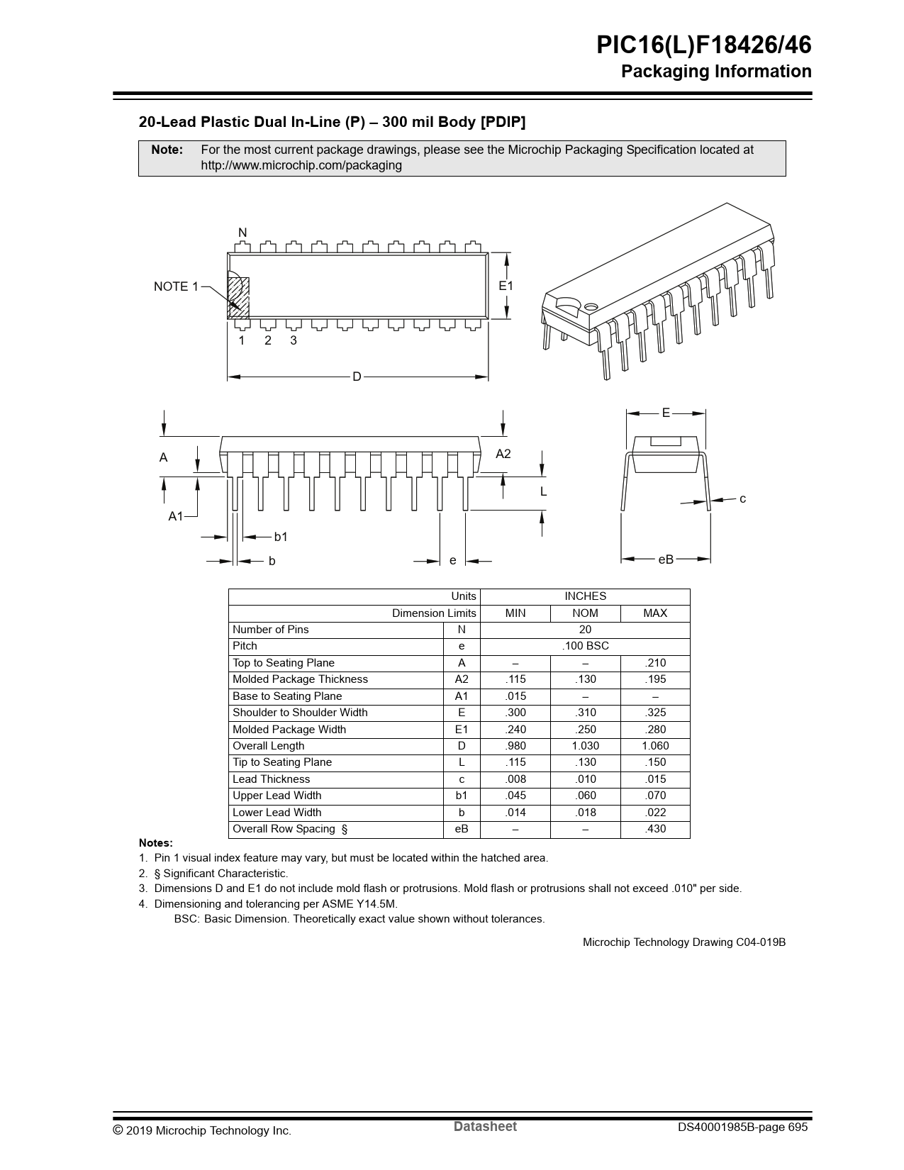

PIC16(L)F18426/46. Packaging Diagrams and Parameters. Packaging Information
M
PIC16(L)F18426/46 Packaging Diagrams and Parameters Packaging Information 20-Lead Plastic Dual In-Line (P) – 300 mil Body [PDIP] Note:
For the most current package drawings, please see the Microchip Packaging Specification located at http://www.microchip.com/packaging N NOTE 1 E1 1 2 3 D E A A2 L c A1 b1 b e eB Units INCHES Dimension Limits MIN NOM MAX Number of Pins N 20 Pitch e .100 BSC Top to Seating Plane A – – .210 Molded Package Thickness A2 .115 .130 .195 Base to Seating Plane A1 .015 – – Shoulder to Shoulder Width E .300 .310 .325 Molded Package Width E1 .240 .250 .280 Overal Length D .980 1.030 1.060 Tip to Seating Plane L .115 .130 .150 Lead Thickness c .008 .010 .015 Upper Lead Width b1 .045 .060 .070 Lower Lead Width b .014 .018 .022 Overal Row Spacing § eB – – .430
Notes:
1. Pin 1 visual index feature may vary, but must be located within the hatched area. 2. § Significant Characteristic. 3. Dimensions D and E1 do not include mold flash or protrusions. Mold flash or protrusions shall not exceed .010" per side. 4. Dimensioning and tolerancing per ASME Y14.5M. BSC: Basic Dimension. Theoretically exact value shown without tolerances. Microchip Technology Drawing C04-019B DS00049AR-page 52 © 2007 Microchip Technology Inc. © 2019 Microchip Technology Inc.
