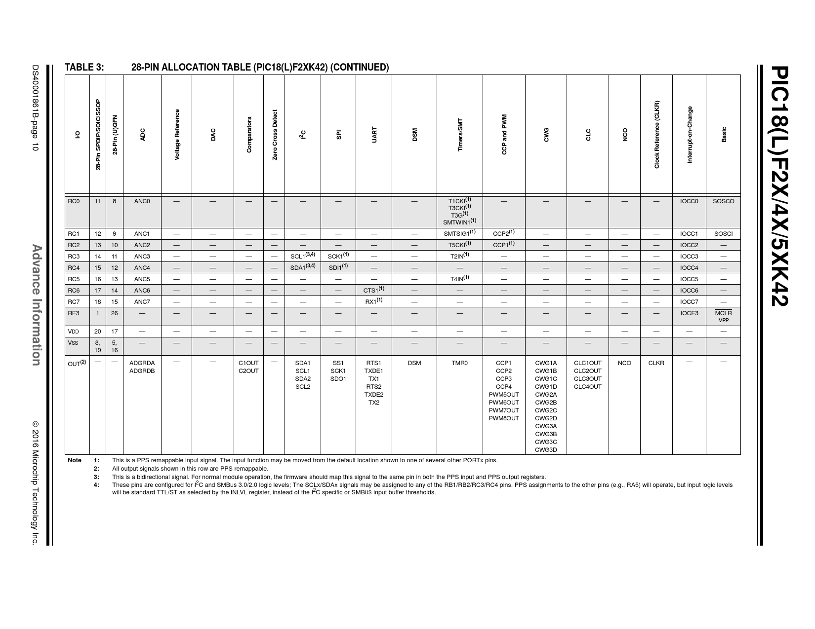

PIC18(L)F2X/4X/5XK4 TABLE 3: 28-PIN ALLOCATION TABLE (PIC18(L)F2XK42) (CONTINUED)
0001861B-p
P ) R e t ge /SSO c c LK N n n te M a
age 10
IC F rs e (C h O re e )Q MT fe to D PW /S C e C ra s C RT /S G C nc n-C I/O IP (U a 2 I rs nd re asic in AD SPI e R DA p ros DSM CW CL NCO t-o m UA fe B -P C me P a e up SPD Ti C 28 ltag Co ro R rr in o C k V Ze te -P In 8 loc 2 C
RC0 11 8 ANC0 — — — — — — — — T1CKI
(1)
— — — — — IOCC0 SOSCO T3CKI
(1)
T3G
(1)
SMTWIN1
(1)
RC1 12 9 ANC1 — — — — — — — — SMTSIG1
(1)
CCP2
(1)
— — — — IOCC1 SOSCI
A d
RC2 13 10 ANC2 — — — — — — — — T5CKI
(1)
CCP1
(1)
— — — — IOCC2 —
va
RC3 14 11 ANC3 — — — — SCL1
(3,4)
SCK1
(1)
— — T2IN
(1)
— — — — — IOCC3 —
nce Inf
RC4 15 12 ANC4 — — — — SDA1
(3,4)
SDI1
(1)
— — — — — — — — IOCC4 — RC5 16 13 ANC5 — — — — — — — — T4IN
(1)
— — — — — IOCC5 — RC6 17 14 ANC6 — — — — — — CTS1
(1)
— — — — — — — IOCC6 —
2
RC7 18 15 ANC7 — — — — — — RX1
(1)
— — — — — — — IOCC7 —
o r
RE3 1 26 — — — — — — — — — — — — — — — IOCE3 MCLR
m
VPP
at
VDD 20 17 — — — — — — — — — — — — — — — — —
ion
VSS 8, 5, — — — — — — — — — — — — — — — — — 19 16 OUT
(2)
— — ADGRDA — — C1OUT — SDA1 SS1 RTS1 DSM TMR0 CCP1 CWG1A CLC1OUT NCO CLKR — — ADGRDB C2OUT SCL1 SCK1 TXDE1 CCP2 CWG1B CLC2OUT SDA2 SDO1 TX1 CCP3 CWG1C CLC3OUT SCL2 RTS2 CCP4 CWG1D CLC4OUT TXDE2 PWM5OUT CWG2A TX2 PWM6OUT CWG2B PWM7OUT CWG2C  PWM8OUT CWG2D 20 CWG3A 16 M CWG3B CWG3C CWG3D icrochip
Note 1:
This is a PPS remappable input signal. The input function may be moved from the default location shown to one of several other PORTx pins.
2:
All output signals shown in this row are PPS remappable.
3:
This is a bidirectional signal. For normal module operation, the firmware should map this signal to the same pin in both the PPS input and PPS output registers. T
4:
These pins are configured for I2C and SMBus 3.0/2.0 logic levels; The SCLx/SDAx signals may be assigned to any of the RB1/RB2/RC3/RC4 pins. PPS assignments to the other pins (e.g., RA5) will operate, but input logic levels e c will be standard TTL/ST as selected by the INLVL register, instead of the I2C specific or SMBUS input buffer thresholds. hnology Inc. Document Outline Description Core Features Memory Operating Characteristics Power-Saving Functionality eXtreme Low-Power (XLP) Features Digital Peripherals Digital Peripherals (Continued) Analog Peripherals Flexible Oscillator Structure TABLE 1: PIC18(L)F2X/4X/5XK42 Family Types TABLE 2: Packages FIGURE 1: 28-Pin SPDIP, SOIC, SSOP for PIC18(L)F2XK42 FIGURE 2: 28-Pin UQFN (4x4) for PIC18(L)F2XK42 FIGURE 3: 28-Pin QFN (6x6x0.9 mm) for PIC18(L)F2XK42 FIGURE 4: 40-Pin PDIP for PIC18(L)F4XK42 FIGURE 5: 40-Pin UQFN (5x5x0.5 mm) for PIC18(L)F4XK42 FIGURE 6: 44-Pin QFN (8x8x0.9 mm) for PIC18(L)F5XK42 FIGURE 7: 44-Pin TQFP For PIC18(L)F4XK42 FIGURE 8: 48-Pin TQFP/UQFN for PIC18(L)F5XK42 TABLE 3: 28-Pin Allocation Table (PIC18(L)F2XK42) TABLE 4: 40/44-Pin Allocation Table For PIC18(L)F4XK42, PIC18(L)F5XK42 TABLE 5: 48-Pin Allocation Table for PIC18(L)F5XK42 Trademarks Worldwide Sales
