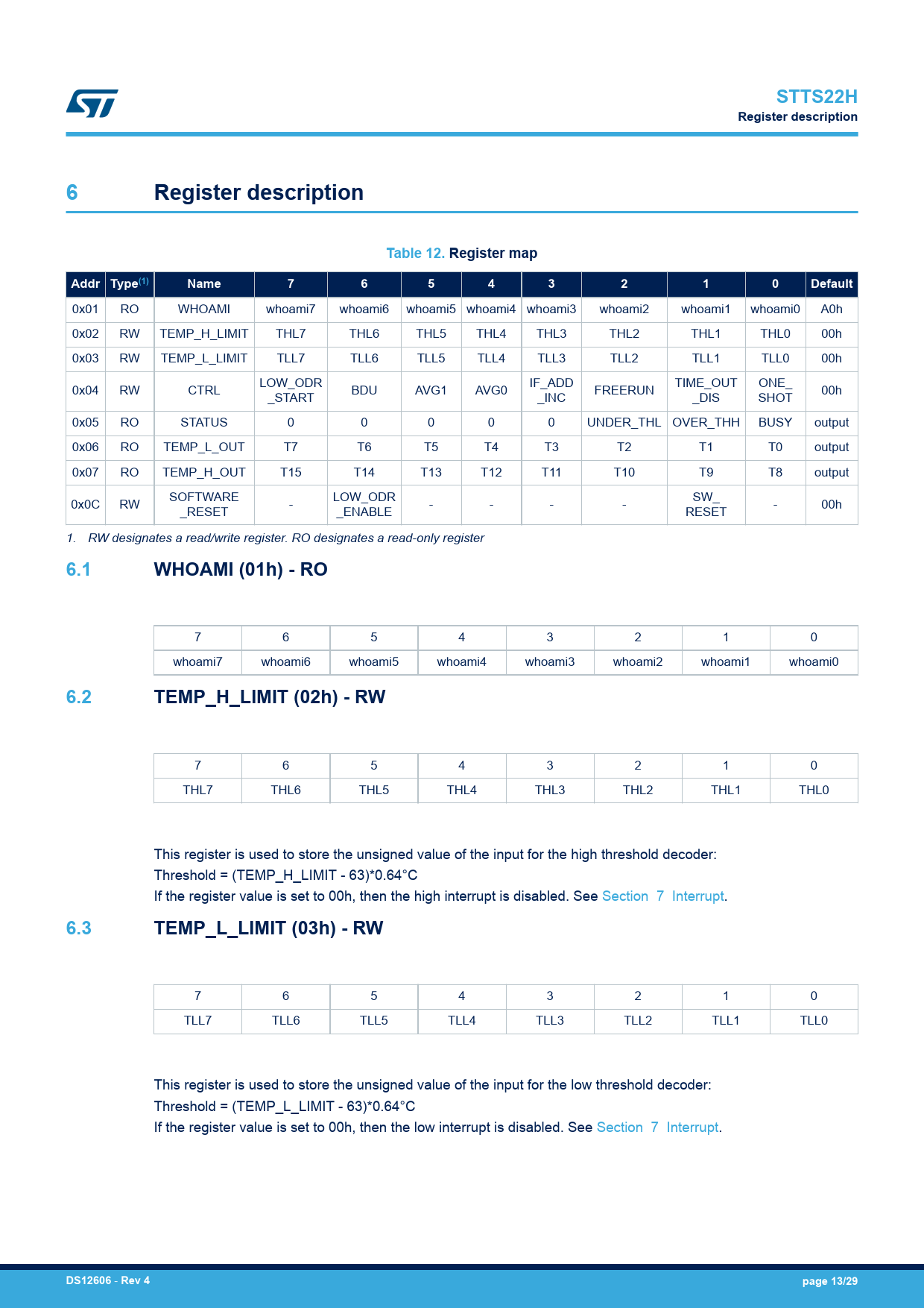

STTS22H Register description 6 Register description Table 12. Register map Addr Type(1) Name 7 6 5 4 3 2 1 0 Default
0x01 RO WHOAMI whoami7 whoami6 whoami5 whoami4 whoami3 whoami2 whoami1 whoami0 A0h 0x02 RW TEMP_H_LIMIT THL7 THL6 THL5 THL4 THL3 THL2 THL1 THL0 00h 0x03 RW TEMP_L_LIMIT TLL7 TLL6 TLL5 TLL4 TLL3 TLL2 TLL1 TLL0 00h LOW_ODR IF_ADD TIME_OUT ONE_ 0x04 RW CTRL BDU AVG1 AVG0 FREERUN 00h _START _INC _DIS SHOT 0x05 RO STATUS 0 0 0 0 0 UNDER_THL OVER_THH BUSY output 0x06 RO TEMP_L_OUT T7 T6 T5 T4 T3 T2 T1 T0 output 0x07 RO TEMP_H_OUT T15 T14 T13 T12 T11 T10 T9 T8 output SOFTWARE LOW_ODR SW_ 0x0C RW - - - - - - 00h _RESET _ENABLE RESET 1. RW designates a read/write register. RO designates a read-only register
6.1 WHOAMI (01h) - RO
7 6 5 4 3 2 1 0 whoami7 whoami6 whoami5 whoami4 whoami3 whoami2 whoami1 whoami0
6.2 TEMP_H_LIMIT (02h) - RW
7 6 5 4 3 2 1 0 THL7 THL6 THL5 THL4 THL3 THL2 THL1 THL0 This register is used to store the unsigned value of the input for the high threshold decoder: Threshold = (TEMP_H_LIMIT - 63)*0.64°C If the register value is set to 00h, then the high interrupt is disabled. See Section 7 Interrupt.
6.3 TEMP_L_LIMIT (03h) - RW
7 6 5 4 3 2 1 0 TLL7 TLL6 TLL5 TLL4 TLL3 TLL2 TLL1 TLL0 This register is used to store the unsigned value of the input for the low threshold decoder: Threshold = (TEMP_L_LIMIT - 63)*0.64°C If the register value is set to 00h, then the low interrupt is disabled. See Section 7 Interrupt.
