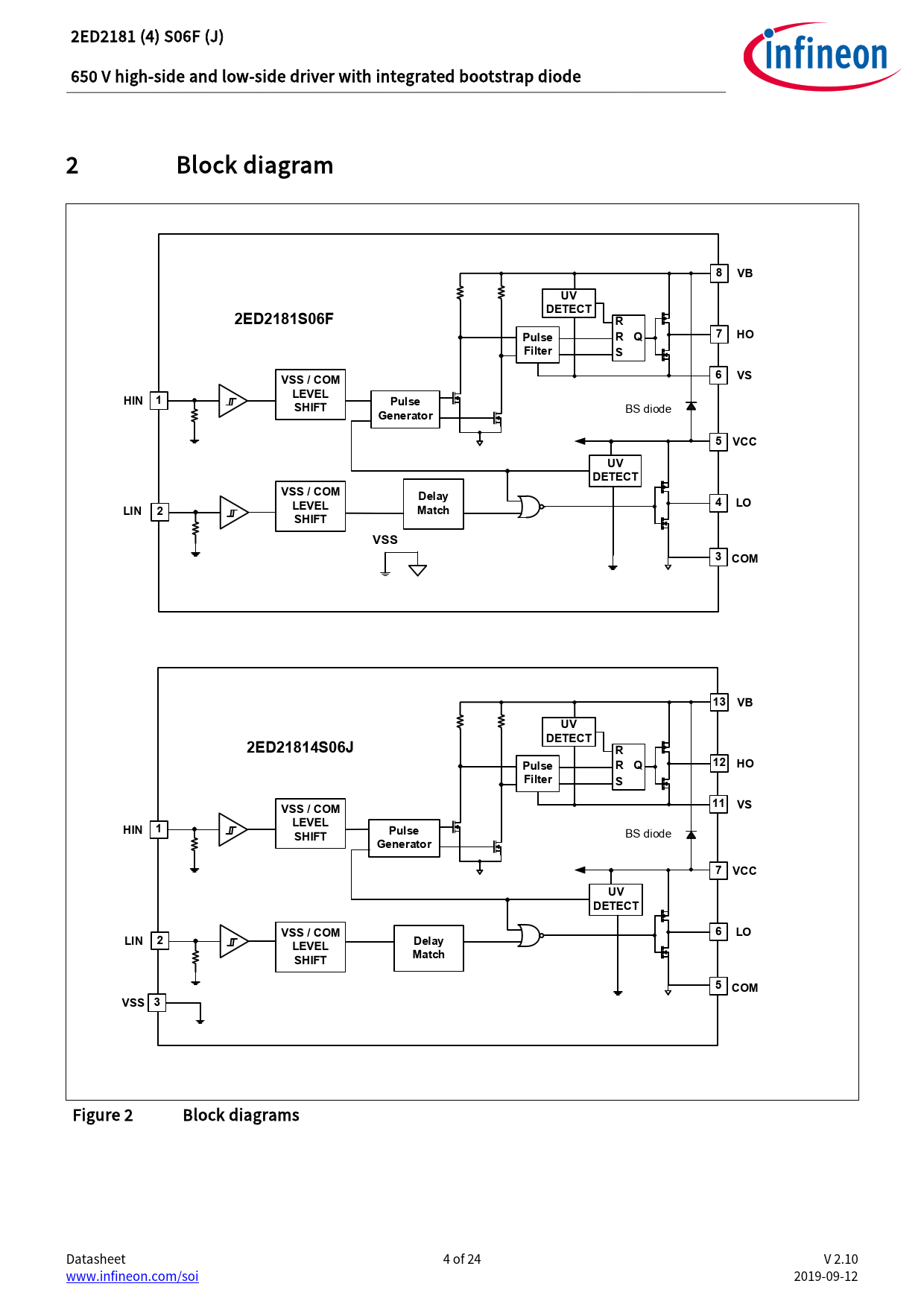

8 VB. DETECT. 2ED2181S06F. R R Q. Pulse. Filter. 6 VS. VSS / COM. HIN 1. LEVEL. SHIFT. Generator. 5 VCC. Delay. LIN 2. Match. VSS. 3 COM. 13 VB. 2ED21814S06J
8 VB DETECT 2ED2181S06F R R Q Pulse Filter 6 VS VSS / COM HIN 1 LEVEL SHIFT Generator 5 VCC Delay LIN 2 Match VSS 3 COM 13 VB 2ED21814S06J
2ED2181 (4) S06F (J) 650 V high-side and low-side driver with integrated bootstrap diode 2
Block diagram
8 VB UV DETECT 2ED2181S06F R R Q 7 Pulse HO Filter S 6 VS VSS / COM HIN 1 LEVEL Pulse SHIFT Generator
BS diode
5 VCC UV DETECT VSS / COM Delay LEVEL 4 LIN 2 Match LO SHIFT VSS 3 COM 13 VB UV DETECT 2ED21814S06J R R Q 12 Pulse HO Filter S 11 VS VSS / COM HIN 1 LEVEL Pulse SHIFT
BS diode
Generator 7 VCC UV DETECT VSS / COM 6 LO LIN 2 Delay LEVEL Match SHIFT 5 COM VSS 3
