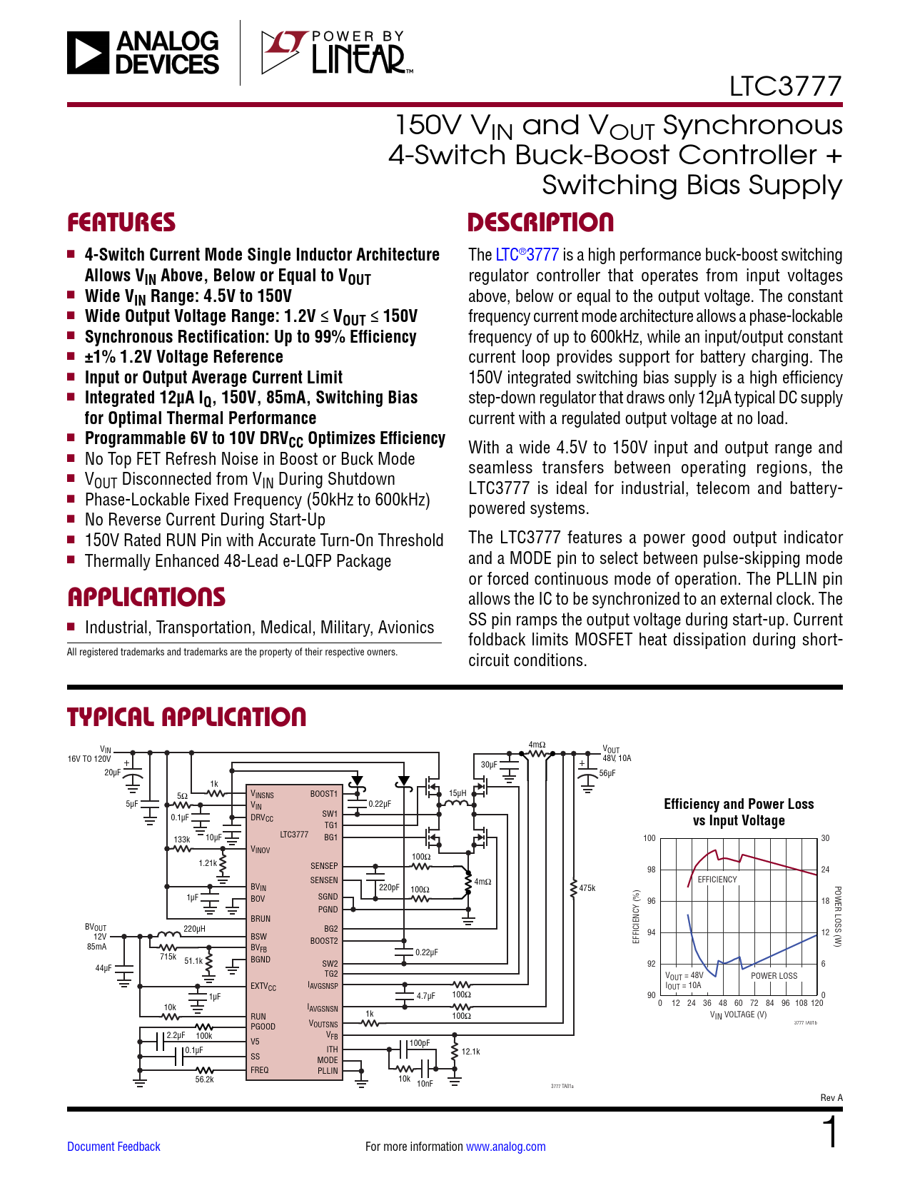

Description150V VIN and VOUT Synchronous 4-Switch Buck-Boost Controller + Switching Bias Supply
Pages / Page40 / 1 — FEATURES. DESCRIPTION. 4-Switch Current Mode Single Inductor …
RevisionA
File Format / SizePDF / 2.8 Mb
FEATURES. DESCRIPTION. 4-Switch Current Mode Single Inductor Architecture. Allows VIN Above, Below or Equal to VOUT
Datasheet LTC3777 Analog Devices, Revision: A
LTC3777 150V VIN and VOUT Synchronous 4-Switch Buck-Boost Controller + Switching Bias Supply
FEATURES DESCRIPTION
n
The LTC®3777 is a high performance buck-boost switching
regulator controller that operates from input voltages n
Wide VIN Range: 4.5V to 150V
above, below or equal to the output voltage. The constant n
Wide Output Voltage Range: 1.2V ≤ VOUT ≤ 150V
frequency current mode architecture allows a phase-lockable n
Synchronous Rectification: Up to 99% Efficiency
frequency of up to 600kHz, while an input/output constant n
±1% 1.2V Voltage Reference
current loop provides support for battery charging. The n
Input or Output Average Current Limit
150V integrated switching bias supply is a high efficiency n
Integrated 12µA IQ, 150V, 85mA, Switching Bias
step-down regulator that draws only 12µA typical DC supply
for Optimal Thermal Performance
current with a regulated output voltage at no load. n
Programmable 6V to 10V DRVCC Optimizes Efficiency
With a wide 4.5V to 150V input and output range and n No Top FET Refresh Noise in Boost or Buck Mode seamless transfers between operating regions, the n VOUT Disconnected from VIN During Shutdown LTC3777 is ideal for industrial, telecom and battery- n Phase-Lockable Fixed Frequency (50kHz to 600kHz) powered systems. n No Reverse Current During Start-Up n 150V Rated RUN Pin with Accurate Turn-On Threshold The LTC3777 features a power good output indicator n Thermally Enhanced 48-Lead e-LQFP Package and a MODE pin to select between pulse-skipping mode or forced continuous mode of operation. The PLLIN pin
APPLICATIONS
allows the IC to be synchronized to an external clock. The n SS pin ramps the output voltage during start-up. Current Industrial, Transportation, Medical, Military, Avionics foldback limits MOSFET heat dissipation during short- All registered trademarks and trademarks are the property of their respective owners. circuit conditions.
TYPICAL APPLICATION
4mΩ VIN VOUT 16V TO 120V 48V, 10A 30µF 20µF 56µF 1k VINSNS BOOST1 15µH 5Ω 5µF V 0.22µF IN
