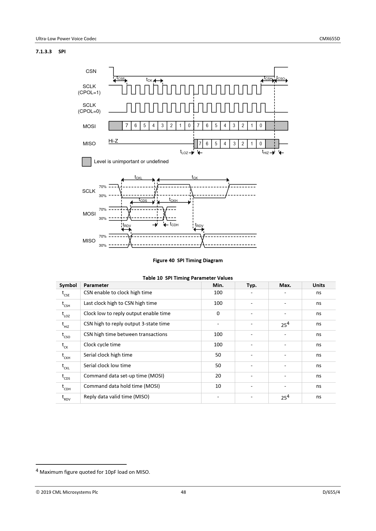

7.1.3.3 SPI. Figure 40 SPI Timing Diagram. Table 10 SPI Timing Parameter Values. Symbol Parameter. Min. Typ. Max. Units
7.1.3.3 SPI Figure 40 SPI Timing Diagram Table 10 SPI Timing Parameter Values Symbol Parameter Min Typ Max Units
link to page 48 Ultra-Low Power Voice Codec CMX655D
7.1.3.3 SPI
CSN tCSE t tCSH tCSO CK SCLK (CPOL=1) SCLK (CPOL=0) MOSI 7 6 5 4 3 2 1 0 7 6 5 4 3 2 1 0 Hi-Z MISO 7 6 5 4 3 2 1 0 tLOZ tHIZ Level is unimportant or undefined tCKL tCK 70% SCLK 30% tCDS tCKH 70% MOSI 30% t t RDV CDH tRDV 70% MISO 30%
Figure 40 SPI Timing Diagram Table 10 SPI Timing Parameter Values Symbol Parameter Min. Typ. Max. Units
t CSN enable to clock high time 100 - - ns CSE t Last clock high to CSN high time 100 - - ns CSH t Clock low to reply output enable time 0 - - ns LOZ t CSN high to reply output 3-state time - - HIZ 254 ns t CSN high time between transactions 100 - - ns CSO t Clock cycle time 100 - - ns CK t Serial clock high time 50 - - ns CKH t Serial clock low time 50 - - ns CKL t Command data set-up time (MOSI) 20 - - ns CDS t Command data hold time (MOSI) 10 - - ns CDH t Reply data valid time (MISO) - - RDV 254 ns 4 Maximum figure quoted for 10pF load on MISO.  2019 CML Microsystems Plc 48 D/655/4 Document Outline Datasheet Front Page 1 Brief Description 2 Block Diagram 2.1 CMX655D 3 Pin List 3.1 CMX655D 4 External Components 4.1 CMX655D 4.1.1 Power Supply and Pin Decoupling 4.1.2 SPI 4.1.3 TWI 4.1.4 Speaker and Microphone 5 General Description 5.1 Power Management 5.1.1 External Supplies 5.1.2 Regulated Supplies 5.2 Device Reset 5.2.1 Power-On-Reset 5.2.2 Reset Pin 5.3 Main Clock 5.3.1 Clock Frequency 5.3.2 Clock Generation 5.3.3 PLL 5.3.4 Low Power Oscillator 5.3.5 Clock Control Registers 5.3.5.1 CLKCTRL ($03) 5.3.5.2 RDIVHI ($04) 5.3.5.3 RDIVLO ($05) 5.3.5.4 NDIVHI ($06) 5.3.5.5 NDIVLO ($07) 5.3.5.6 PLLCTRL ($08) 5.4 Microphone Interface 5.4.1 Digital Microphone Interface 5.5 Class-D Amplifier 5.5.1 Audio Outputs 5.5.2 Overload Current Protection 5.5.3 Thermal Protection 5.5.4 Clipping Detection 5.6 Audio Signal Processing 5.6.1 Record Level Control 5.6.1.1 Record Level Control Register 5.6.2 Noise Gate 5.6.2.1 Noise Gate Registers 5.6.3 Record Level Detection 5.6.3.1 Record Level Detection Registers 5.6.4 Playback Preamplifier Gain 5.6.4.1 Playback Preamplifier Gain Register 5.6.5 Playback Volume Control 5.6.5.1 Playback Volume Register 5.6.6 Automatic Level Control 5.6.6.1 ALC Registers 5.6.7 Digital Sidetone 5.6.7.1 Digital Sidetone Register 5.6.8 Voice Filters 5.6.8.1 Low Pass Filter 5.6.8.2 DC Blocking Filter 5.6.8.3 High Pass Filter 5.6.8.4 Voice Filters Registers 5.6.9 Channel Multiplexing 5.6.10 Click-and-Pop Reduction 5.6.10.1 Click-and-Pop Reduction Register 5.7 Control Interface 5.7.1 SPI Slave 5.7.2 TWI Slave 5.8 Serial Audio Interface 5.8.1 I2S Mode 5.8.2 Left-Justified Mode 5.8.3 PCM Mode 5.8.4 Audio Companding 5.8.5 Serial Audio Interface Registers 5.9 Interrupt Status and IRQN Pin 5.9.1 Interrupt Registers 5.10 System Control 5.10.1 System Control Registers 5.11 Register Address Map 6 Application Notes 6.1 Programming Examples 6.1.1 Start-up 6.1.2 Configuration 6.1.3 Enable Audio Channels 6.1.4 Shutdown 7 Performance Specification 7.1 Electrical Performance 7.1.1 Absolute Maximum Ratings 7.1.2 Operating Limits 7.1.3 Operating Characteristics 7.1.3.1 DC Parameters 7.1.3.2 AC Parameters 7.1.3.3 SPI 7.1.3.4 TWI 7.1.3.5 SAI 7.1.3.6 Digital Microphone Interface 7.2 Typical Performance Characteristics 7.2.1 THD+N vs. Level performance 7.2.2 THD+N vs. Frequency performance 7.2.3 Class D Amplifier Efficiency 7.2.4 Filter Performance Speaker Channel 7.2.5 Filter Performance Microphone Channel 7.3 Packaging 7.3.1 CMX655D End of Document cmlmicro.com CMX655D - Ultra-low Power Voice Codec - CML Micro
