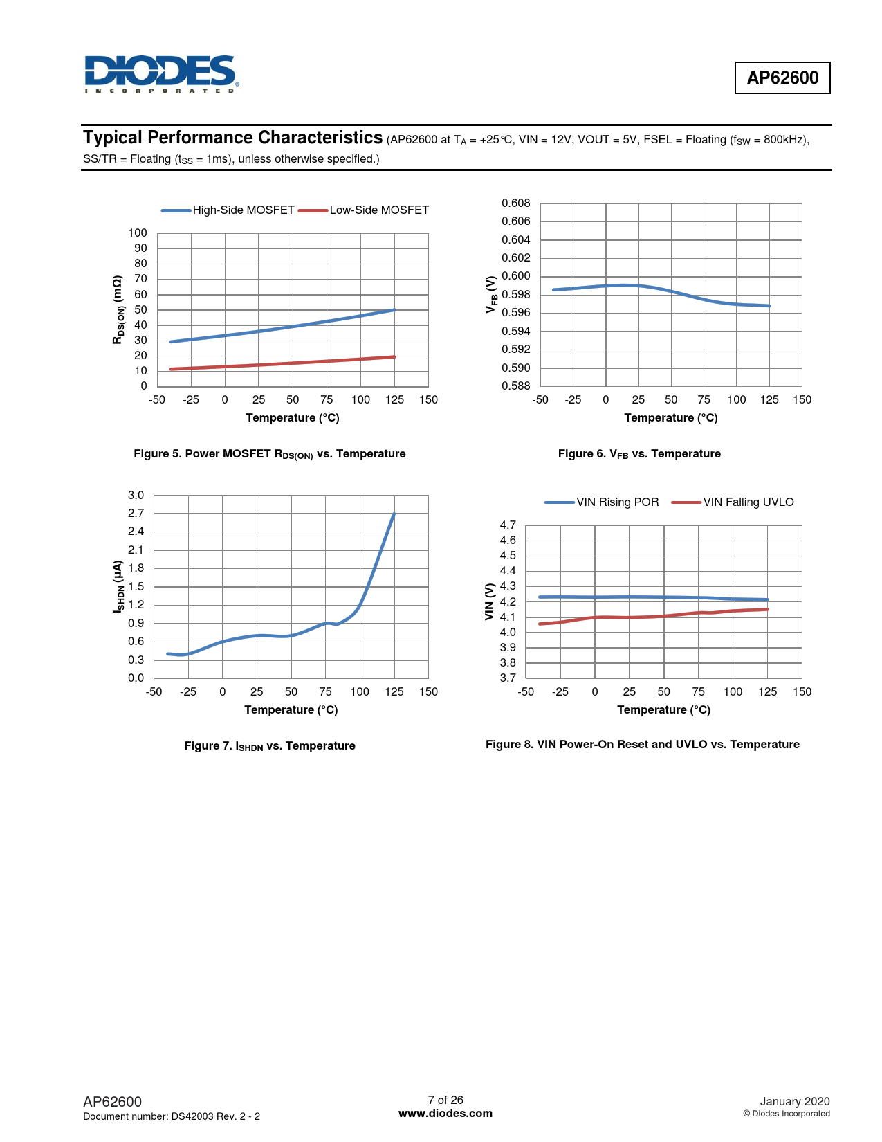

AP62600. Typical Performance Characteristics. ON)(. Temperature (°C). Figure 5. Power MOSFET RDS(ON) vs. Temperature
AP62600 Typical Performance Characteristics
(AP62600 at TA = +25°C, VIN = 12V, VOUT = 5V, FSEL = Floating (fSW = 800kHz), SS/TR = Floating (tSS = 1ms), unless otherwise specified.) 0.608 High-Side MOSFET Low-Side MOSFET 0.606 100 0.604 90 0.602 80 70

Temperature (°C) Temperature (°C) Figure 5. Power MOSFET RDS(ON) vs. Temperature Figure 6. VFB vs. Temperature

Temperature (°C) Temperature (°C) Figure 7. ISHDN vs. Temperature Figure 8. VIN Power-On Reset and UVLO vs. Temperature
