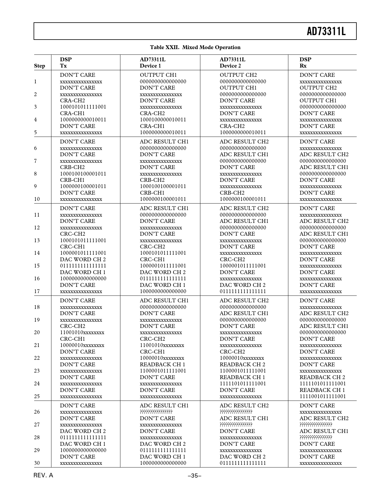

Pages / Page36 / 35 — AD73311L. Table XXII. Mixed Mode Operation. DSP. Step. Device 1. Device 2
RevisionA
File Format / SizePDF / 391 Kb
AD73311L Table XXII Mixed Mode Operation DSP Step Device 1 Device 2
AD73311L Table XXII. Mixed Mode Operation DSP AD73311L AD73311L DSP Step Tx Device 1 Device 2 Rx
DON’T CARE OUTPUT CH1 OUTPUT CH2 DON’T CARE 1 xxxxxxxxxxxxxxxx 0000000000000000 0000000000000000 xxxxxxxxxxxxxxxx DON’T CARE DON’T CARE OUTPUT CH1 OUTPUT CH2 2 xxxxxxxxxxxxxxxx xxxxxxxxxxxxxxxx 0000000000000000 0000000000000000 CRA-CH2 DON’T CARE DON’T CARE OUTPUT CH1 3 1000101011111001 xxxxxxxxxxxxxxxx xxxxxxxxxxxxxxxx 0000000000000000 CRA-CH1 CRA-CH2 DON’T CARE DON’T CARE 4 1000000000010011 1000100000010011 xxxxxxxxxxxxxxxx xxxxxxxxxxxxxxxx DON’T CARE CRA-CH1 CRA-CH2 DON’T CARE 5 xxxxxxxxxxxxxxxx 1000000000010011 1000000000010011 xxxxxxxxxxxxxxxx DON’T CARE ADC RESULT CH1 ADC RESULT CH2 DON’T CARE 6 xxxxxxxxxxxxxxxx 0000000000000000 0000000000000000 xxxxxxxxxxxxxxxx DON’T CARE DON’T CARE ADC RESULT CH1 ADC RESULT CH2 7 xxxxxxxxxxxxxxxx xxxxxxxxxxxxxxxx 0000000000000000 0000000000000000 CRB-CH2 DON’T CARE DON’T CARE ADC RESULT CH1 8 1000100100001011 xxxxxxxxxxxxxxxx xxxxxxxxxxxxxxxx 0000000000000000 CRB-CH1 CRB-CH2 DON’T CARE DON’T CARE 9 1000000100001011 1000100100001011 xxxxxxxxxxxxxxxx xxxxxxxxxxxxxxxx DON’T CARE CRB-CH1 CRB-CH2 DON’T CARE 10 xxxxxxxxxxxxxxxx 1000000100001011 1000000100001011 xxxxxxxxxxxxxxxx DON’T CARE ADC RESULT CH1 ADC RESULT CH2 DON’T CARE 11 xxxxxxxxxxxxxxxx 0000000000000000 0000000000000000 xxxxxxxxxxxxxxxx DON’T CARE DON’T CARE ADC RESULT CH1 ADC RESULT CH2 12 xxxxxxxxxxxxxxxx xxxxxxxxxxxxxxxx 0000000000000000 0000000000000000 CRC-CH2 DON’T CARE DON’T CARE ADC RESULT CH1 13 1000101011111001 xxxxxxxxxxxxxxxx xxxxxxxxxxxxxxxx 0000000000000000 CRC-CH1 CRC-CH2 DON’T CARE DON’T CARE 14 1000001011111001 1000101011111001 xxxxxxxxxxxxxxxx xxxxxxxxxxxxxxxx DAC WORD CH 2 CRC-CH1 CRC-CH2 DON’T CARE 15 0111111111111111 1000001011111001 1000001011111001 xxxxxxxxxxxxxxxx DAC WORD CH 1 DAC WORD CH 2 DON’T CARE DON’T CARE 16 1000000000000000 0111111111111111 xxxxxxxxxxxxxxxx xxxxxxxxxxxxxxxx DON’T CARE DAC WORD CH 1 DAC WORD CH 2 DON’T CARE 17 xxxxxxxxxxxxxxxx 1000000000000000 0111111111111111 xxxxxxxxxxxxxxxx DON’T CARE ADC RESULT CH1 ADC RESULT CH2 DON’T CARE 18 xxxxxxxxxxxxxxxx 0000000000000000 0000000000000000 xxxxxxxxxxxxxxxx DON’T CARE DON’T CARE ADC RESULT CH1 ADC RESULT CH2 19 xxxxxxxxxxxxxxxx xxxxxxxxxxxxxxxx 0000000000000000 0000000000000000 CRC-CH2 DON’T CARE DON’T CARE ADC RESULT CH1 20 11001010xxxxxxxx xxxxxxxxxxxxxxxx xxxxxxxxxxxxxxxx 0000000000000000 CRC-CH1 CRC-CH2 DON’T CARE DON’T CARE 21 10000010xxxxxxxx 11001010xxxxxxxx xxxxxxxxxxxxxxxx xxxxxxxxxxxxxxxx DON’T CARE CRC-CH1 CRC-CH2 DON’T CARE 22 xxxxxxxxxxxxxxxx 10000010xxxxxxxx 10000010xxxxxxxx xxxxxxxxxxxxxxxx DON’T CARE READBACK CH 1 READBACK CH 2 DON’T CARE 23 xxxxxxxxxxxxxxxx 1100001011111001 1100001011111001 xxxxxxxxxxxxxxxx DON’T CARE DON’T CARE READBACK CH 1 READBACK CH 2 24 xxxxxxxxxxxxxxxx xxxxxxxxxxxxxxxx 1111101011111001 1111101011111001 DON’T CARE DON’T CARE DON’T CARE READBACK CH 1 25 xxxxxxxxxxxxxxxx xxxxxxxxxxxxxxxx xxxxxxxxxxxxxxxx 1111001011111001 DON’T CARE ADC RESULT CH1 ADC RESULT CH2 DON’T CARE 26 xxxxxxxxxxxxxxxx ???????????????? ???????????????? xxxxxxxxxxxxxxxx DON’T CARE DON’T CARE ADC RESULT CH1 ADC RESULT CH2 27 xxxxxxxxxxxxxxxx xxxxxxxxxxxxxxxx ???????????????? ???????????????? DAC WORD CH 2 DON’T CARE DON’T CARE ADC RESULT CH1 28 0111111111111111 xxxxxxxxxxxxxxxx xxxxxxxxxxxxxxxx ???????????????? DAC WORD CH 1 DAC WORD CH 2 DON’T CARE DON’T CARE 29 1000000000000000 0111111111111111 xxxxxxxxxxxxxxxx xxxxxxxxxxxxxxxx DON’T CARE DAC WORD CH 1 DAC WORD CH 2 DON’T CARE 30 xxxxxxxxxxxxxxxx 1000000000000000 0111111111111111 xxxxxxxxxxxxxxxx REV. A –35–
