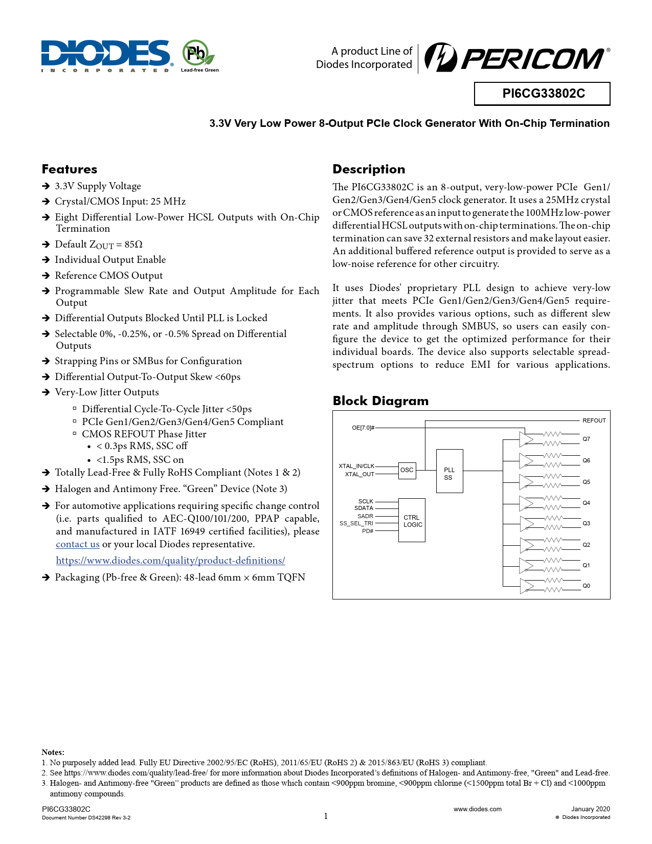

Lead-free Green PI6CG33802C 3.3V Very Low Power 8-Output PCIe Clock Generator With On-Chip Termination Features Description
Î Î 3.3V Supply Voltage The PI6CG33802C is an 8-output, very-low-power PCIe Gen1/ Î Î Crystal/CMOS Input: 25 MHz Gen2/Gen3/Gen4/Gen5 clock generator. It uses a 25MHz crystal or CMOS reference as an input to generate the 100MHz low-power Î Î Eight Differential Low-Power HCSL Outputs with On-Chip Termination differential HCSL outputs with on-chip terminations. The on-chip termination can save 32 external resistors and make layout easier. Î Î Default ZOUT = 85Ω An additional buffered reference output is provided to serve as a Î Î Individual Output Enable low-noise reference for other circuitry. Î Î Reference CMOS Output Î Î Programmable Slew Rate and Output Amplitude for Each It uses Diodes' proprietary PLL design to achieve very-low Output jitter that meets PCIe Gen1/Gen2/Gen3/Gen4/Gen5 require- ments. It also provides various options, such as different slew Î Î Differential Outputs Blocked Until PLL is Locked rate and amplitude through SMBUS, so users can easily con- Î Î Selectable 0%, -0.25%, or -0.5% Spread on Differential Outputs figure the device to get the optimized performance for their individual boards. The device also supports selectable spread- Î Î Strapping Pins or SMBus for Configuration spectrum options to reduce EMI for various applications. Î Î Differential Output-To-Output Skew <60ps Î Î Very-Low Jitter Outputs
Block Diagram
à Differential Cycle-To-Cycle Jitter <50ps à PCIe Gen1/Gen2/Gen3/Gen4/Gen5 Compliant REFOUT à CMOS REFOUT Phase Jitter OE[7:0]# •  < 0.3ps RMS, SSC off Q7 •  <1.5ps RMS, SSC on Q6 XTAL_IN/CLK Î Î Totally Lead-Free & Fully RoHS Compliant (Notes 1 & 2) OSC PLL XTAL_OUT SS Q5 Î Î Halogen and Antimony Free. “Green” Device (Note 3) Î Î For automotive applications requiring specific change control SCLK Q4 SDATA (i.e. parts qualified to AEC-Q100/101/200, PPAP capable, SADR CTRL SS_SEL_TRI Q3 and manufactured in IATF 16949 certified facilities), please LOGIC PD# contact us or your local Diodes representative. Q2 https://www.diodes.com/quality/product-definitions/ Q1 Î Î Packaging (Pb-free & Green): 48-lead 6mm × 6mm TQFN Q0
Notes:
1. No purposely added lead. Fully EU Directive 2002/95/EC (RoHS), 2011/65/EU (RoHS 2) & 2015/863/EU (RoHS 3) compliant. 2. See https://www.diodes.com/quality/lead-free/ for more information about Diodes Incorporated’s definitions of Halogen- and Antimony-free, "Green" and Lead-free. 3. Halogen- and Antimony-free "Green” products are defined as those which contain <900ppm bromine, <900ppm chlorine (<1500ppm total Br + Cl) and <1000ppm antimony compounds. PI6CG33802C www.diodes.com January 2020 Document Number DS42298 Rev 3-2 1 Diodes Incorporated
