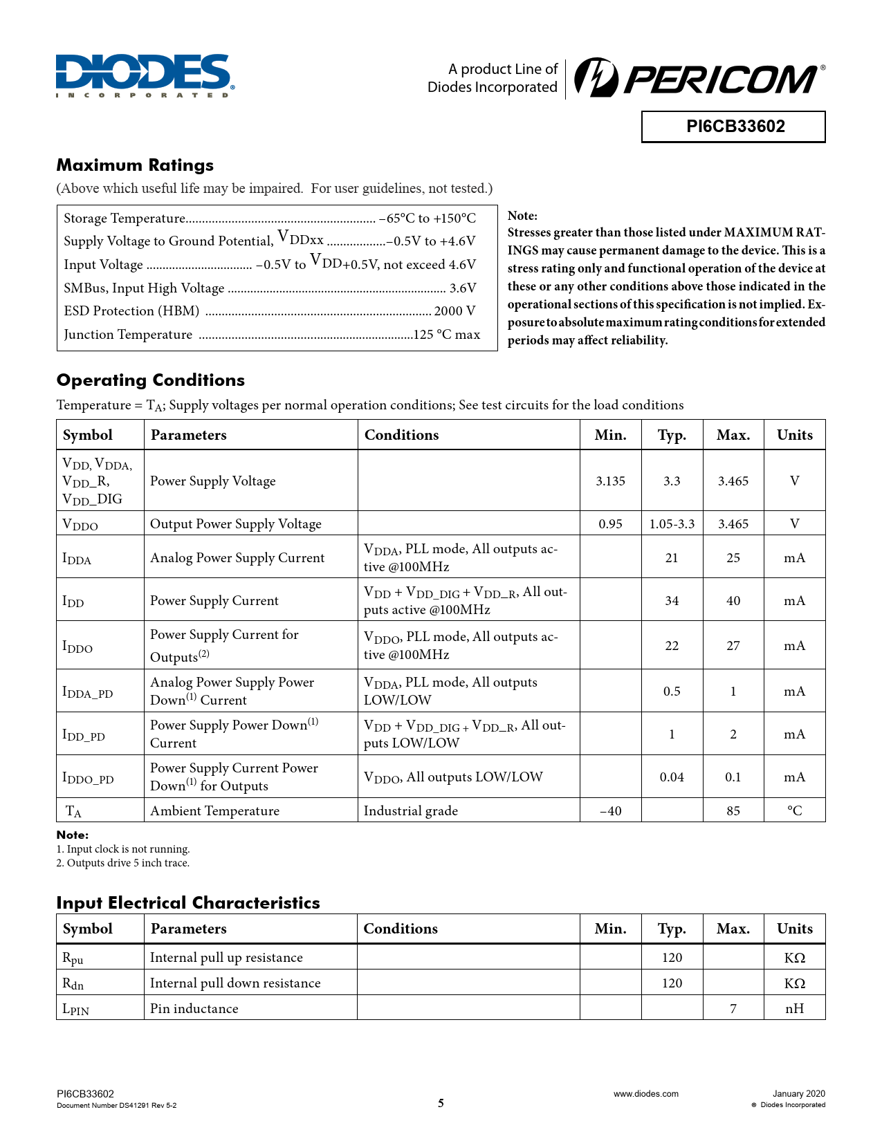

PI6CB33602 Maximum Ratings
(Above which useful life may be impaired. For user guidelines, not tested.) Storage Temperature .. –65°C to +150°C
Note:
Supply Voltage to Ground Potential, VDDxx ..–0.5V to +4.6V
Stresses greater than those listed under MAXIMUM RAT- INGS may cause permanent damage to the device. This is a
Input Voltage ... –0.5V to VDD+0.5V, not exceed 4.6V
stress rating only and functional operation of the device at
SMBus, Input High Voltage .. 3.6V
these or any other conditions above those indicated in the
ESD Protection (HBM) ... 2000 V
operational sections of this specification is not implied. Ex- posure to absolute maximum rating conditions for extended
Junction Temperature ..125 °C max
periods may affect reliability. Operating Conditions
Temperature = TA; Supply voltages per normal operation conditions; See test circuits for the load conditions
Symbol Parameters Conditions Min. Typ. Max. Units
VDD, VDDA, VDD_R, Power Supply Voltage 3.135 3.3 3.465 V VDD_DIG VDDO Output Power Supply Voltage 0.95 1.05-3.3 3.465 V IDDA Analog Power Supply Current VDDA, PLL mode, All outputs ac- tive @100MHz 21 25 mA IDD Power Supply Current VDD + VDD_DIG + VDD_R, All out- puts active @100MHz 34 40 mA Power Supply Current for I VDDO, PLL mode, All outputs ac- DDO Outputs(2) tive @100MHz 22 27 mA I Analog Power Supply Power VDDA, PLL mode, All outputs DDA_PD Down(1) Current LOW/LOW 0.5 1 mA I Power Supply Power Down(1) VDD + VDD_DIG + VDD_R, All out- DD_PD Current puts LOW/LOW 1 2 mA I Power Supply Current Power DDO_PD Down(1) for Outputs VDDO, All outputs LOW/LOW 0.04 0.1 mA TA Ambient Temperature Industrial grade –40 85 °C
Note:
1. Input clock is not running. 2. Outputs drive 5 inch trace.
Input Electrical Characteristics Symbol Parameters Conditions Min. Typ. Max. Units
Rpu Internal pull up resistance 120 KW Rdn Internal pull down resistance 120 KW LPIN Pin inductance 7 nH PI6CB33602 www.diodes.com January 2020 Document Number DS41291 Rev 5-2 5 Diodes Incorporated
