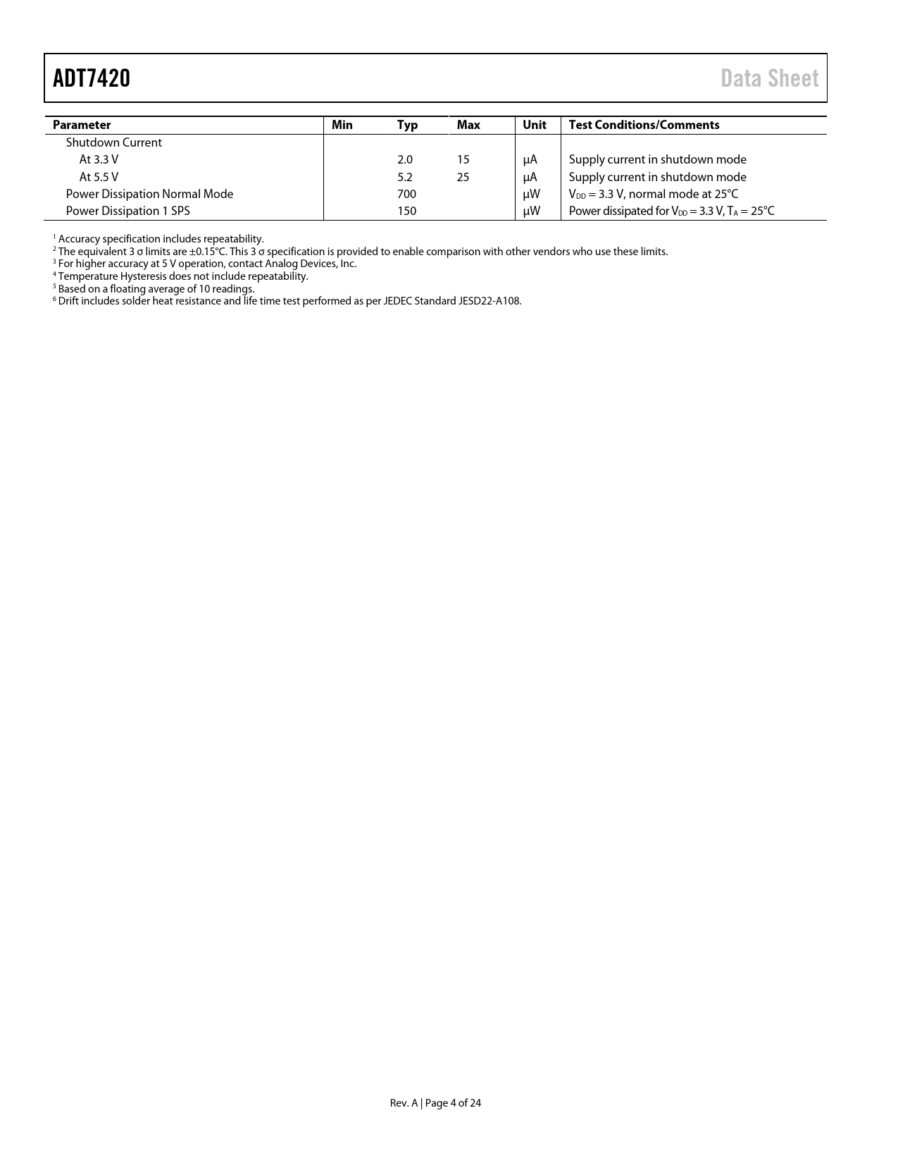

ADT7420. Data Sheet. Parameter. Min. Typ. Max. Unit. Test Conditions/Comments
ADT7420 Data Sheet Parameter Min Typ Max Unit Test Conditions/Comments
Shutdown Current At 3.3 V 2.0 15 µA Supply current in shutdown mode At 5.5 V 5.2 25 µA Supply current in shutdown mode Power Dissipation Normal Mode 700 µW VDD = 3.3 V, normal mode at 25°C Power Dissipation 1 SPS 150 µW Power dissipated for VDD = 3.3 V, TA = 25°C 1 Accuracy specification includes repeatability. 2 The equivalent 3 σ limits are ±0.15°C. This 3 σ specification is provided to enable comparison with other vendors who use these limits. 3 For higher accuracy at 5 V operation, contact Analog Devices, Inc. 4 Temperature Hysteresis does not include repeatability. 5 Based on a floating average of 10 readings. 6 Drift includes solder heat resistance and life time test performed as per JEDEC Standard JESD22-A108. Rev. A | Page 4 of 24 Document Outline FEATURES APPLICATIONS GENERAL DESCRIPTION PRODUCT HIGHLIGHTS FUNCTIONAL BLOCK DIAGRAM TABLE OF CONTENTS REVISION HISTORY SPECIFICATIONS I2C TIMING SPECIFICATIONS Timing Diagram ABSOLUTE MAXIMUM RATINGS ESD CAUTION PIN CONFIGURATION AND FUNCTION DESCRIPTIONS TYPICAL PERFORMANCE CHARACTERISTICS THEORY OF OPERATION CIRCUIT INFORMATION CONVERTER DETAILS NORMAL MODE ONE-SHOT MODE CT and INT Operation in One-Shot Mode 1 SPS MODE SHUTDOWN FAULT QUEUE TEMPERATURE DATA FORMAT TEMPERATURE CONVERSION FORMULAS 16-Bit Temperature Data Format 13-Bit Temperature Data Format 10-Bit Temperature Data Format 9-Bit Temperature Data Format REGISTERS ADDRESS POINTER REGISTER TEMPERATURE VALUE REGISTERS STATUS REGISTER CONFIGURATION REGISTER THIGH SETPOINT REGISTERS TLOW SETPOINT REGISTERS TCRIT SETPOINT REGISTERS THYST SETPOINT REGISTER ID REGISTER SERIAL INTERFACE SERIAL BUS ADDRESS WRITING DATA READING DATA RESET GENERAL CALL INT AND CT OUTPUTS UNDERTEMPERATURE AND OVERTEMPERATURE DETECTION Comparator Mode Interrupt Mode APPLICATIONS INFORMATION THERMAL RESPONSE TIME SUPPLY DECOUPLING POWERING FROM A SWITCHING REGULATOR TEMPERATURE MEASUREMENT QUICK GUIDE TO MEASURING TEMPERATURE OUTLINE DIMENSIONS ORDERING GUIDE
