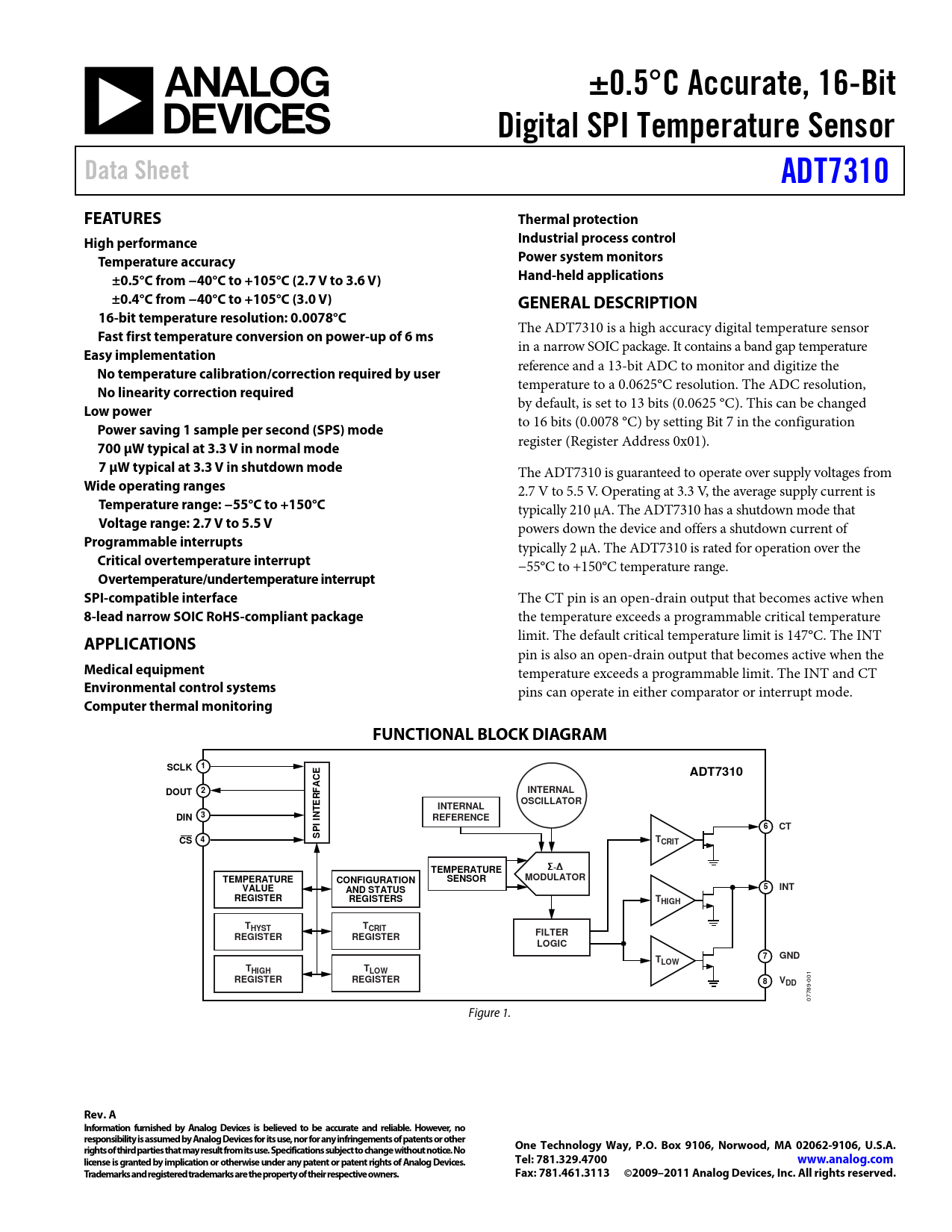

±0.5°C Accurate, 16-Bit. Digital SPI Temperature Sensor. Data Sheet. ADT7310. FEATURES. Thermal protection. High performance
±0.5°C Accurate, 16-Bit Digital SPI Temperature Sensor Data Sheet ADT7310 FEATURES Thermal protection High performance Industrial process control Temperature accuracy Power system monitors ±0.5°C from −40°C to +105°C (2.7 V to 3.6 V) Hand-held applications ±0.4°C from −40°C to +105°C (3.0 V) GENERAL DESCRIPTION 16-bit temperature resolution: 0.0078°C
The ADT7310 is a high accuracy digital temperature sensor
Fast first temperature conversion on power-up of 6 ms
in a narrow SOIC package. It contains a band gap temperature
Easy implementation
reference and a 13-bit ADC to monitor and digitize the
No temperature calibration/correction required by user No linearity correction required
temperature to a 0.0625°C resolution. The ADC resolution,
Low power
by default, is set to 13 bits (0.0625 °C). This can be changed
Power saving 1 sample per second (SPS) mode
to 16 bits (0.0078 °C) by setting Bit 7 in the configuration
700 µW typical at 3.3 V in normal mode
register (Register Address 0x01).
7 µW typical at 3.3 V in shutdown mode
The ADT7310 is guaranteed to operate over supply voltages from
Wide operating ranges
2.7 V to 5.5 V. Operating at 3.3 V, the average supply current is
Temperature range: −55°C to +150°C
typical y 210 μA. The ADT7310 has a shutdown mode that
Voltage range: 2.7 V to 5.5 V
powers down the device and offers a shutdown current of
Programmable interrupts
typical y 2 μA. The ADT7310 is rated for operation over the
Critical overtemperature interrupt
−55°C to +150°C temperature range.
Overtemperature/undertemperature interrupt SPI-compatible interface
The CT pin is an open-drain output that becomes active when
8-lead narrow SOIC RoHS-compliant package
the temperature exceeds a programmable critical temperature
APPLICATIONS
limit. The default critical temperature limit is 147°C. The INT pin is also an open-drain output that becomes active when the
Medical equipment
temperature exceeds a programmable limit. The INT and CT
Environmental control systems
pins can operate in either comparator or interrupt mode.
Computer thermal monitoring FUNCTIONAL BLOCK DIAGRAM 1 SCLK ADT7310 ACE 2 INTERNAL DOUT RF E OSCILLATOR INTERNAL 3 NT DIN REFERENCE I I 6 CT P S 4 CS TCRIT TEMPERATURE Σ-Δ TEMPERATURE CONFIGURATION SENSOR MODULATOR 5 VALUE INT AND STATUS REGISTER REGISTERS THIGH T T HYST CRIT FILTER REGISTER REGISTER LOGIC 7 T GND LOW T T HIGH LOW REGISTER REGISTER 8 VDD
001 07789- Figure 1.
