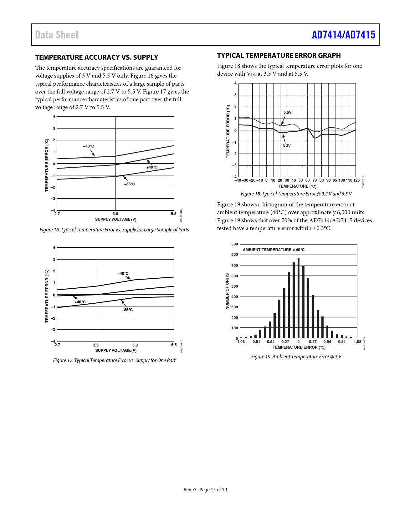

Data Sheet AD7414/ AD7415 TEMPERATURE ACCURACY VS. SUPPLY TYPICAL TEMPERATURE ERROR GRAPH
The temperature accuracy specifications are guaranteed for Figure 18 shows the typical temperature error plots for one voltage supplies of 3 V and 5.5 V only. Figure 16 gives the device with VDD at 3.3 V and at 5.5 V. typical performance characteristics of a large sample of parts
4
over the full voltage range of 2.7 V to 5.5 V. Figure 17 gives the
3
typical performance characteristics of one part over the full voltage range of 2.7 V to 5.5 V.

Figure 18. Typical Temperature Error @ 3.3 V and 5.5 V
–3
Figure 19 shows a histogram of the temperature error at
–42.7 3.0 5.5
ambient temperature (40°C) over approximately 6,000 units.

02463-016 Figure 19 shows that over 70% of the AD7414/AD7415 devices Figure 16. Typical Temperature Error vs. Supply for Large Sample of Parts tested have a temperature error within ±0.3°C.
