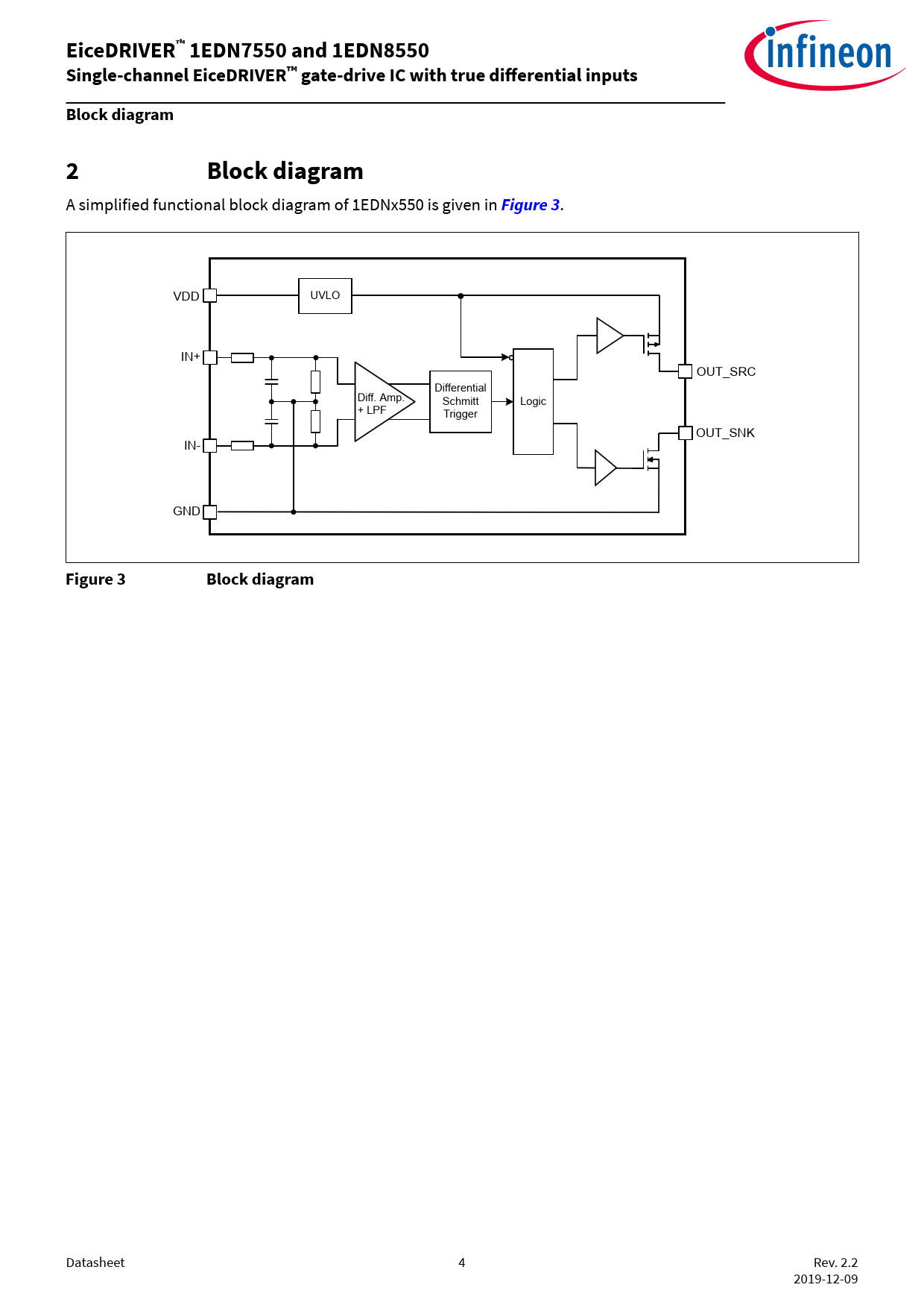

EiceDRIVER™ 1EDN7550 and 1EDN8550. Single-channel EiceDRIVER™ gate-drive IC with true differential inputs. Block diagram
link to page 4
EiceDRIVER™ 1EDN7550 and 1EDN8550 Single-channel EiceDRIVER™ gate-drive IC with true differential inputs Block diagram 2 Block diagram
A simplified functional block diagram of 1EDNx550 is given in
Figure 3
. VDD UVLO IN+ OUT_SRC Differential Diff. Amp. Schmitt Logic + LPF Trigger OUT_SNK IN- GND
Figure 3 Block diagram
