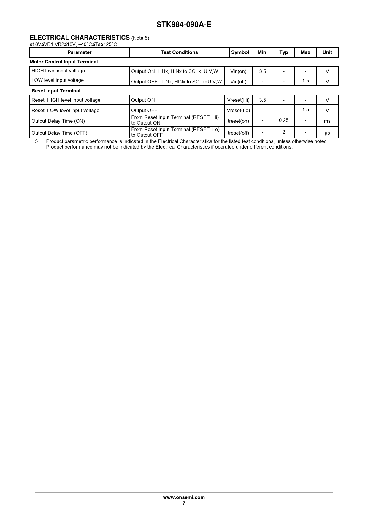

STK984-090A-E. ELECTRICAL CHARACTERISTICS (Note 5). at 8V≤VB1,VB2≤18V, 40C≤Ta≤125C
STK984-090A-E ELECTRICAL CHARACTERISTICS (Note 5) at 8V≤VB1,VB2≤18V, 40C≤Ta≤125C
STK984-090A-E
Parameter Test Conditions Symbol Min Typ Max Unit Motor Control Input Terminal
HIGH level input voltage Output ON. LINx, HINx to SG. x=U,V,W Vin(on) 3.5 -V LOW level input voltage Output OFF. LINx, HINx to SG. x=U,V,W Vin(off) -1.5 V Vreset(Hi) 3.5 -V Reset Input Terminal
Reset HIGH level input voltage Output ON 1.5
Output OFF
Vreset(Lo)
V
From Reset Input Terminal (RESET=Hi)
0.25
Output Delay Time (ON)
treset(on)
ms
to Output ON
From Reset Input Terminal (RESET=Lo)
2
Output Delay Time (OFF)
treset(off)
s
to Output OFF
5. Product parametric performance is indicated in the Electrical Characteristics for the listed test conditions, unless otherwise noted.
Product performance may not be indicated by the Electrical Characteristics if operated under different conditions.
Reset LOW level input voltage www.onsemi.com 7
