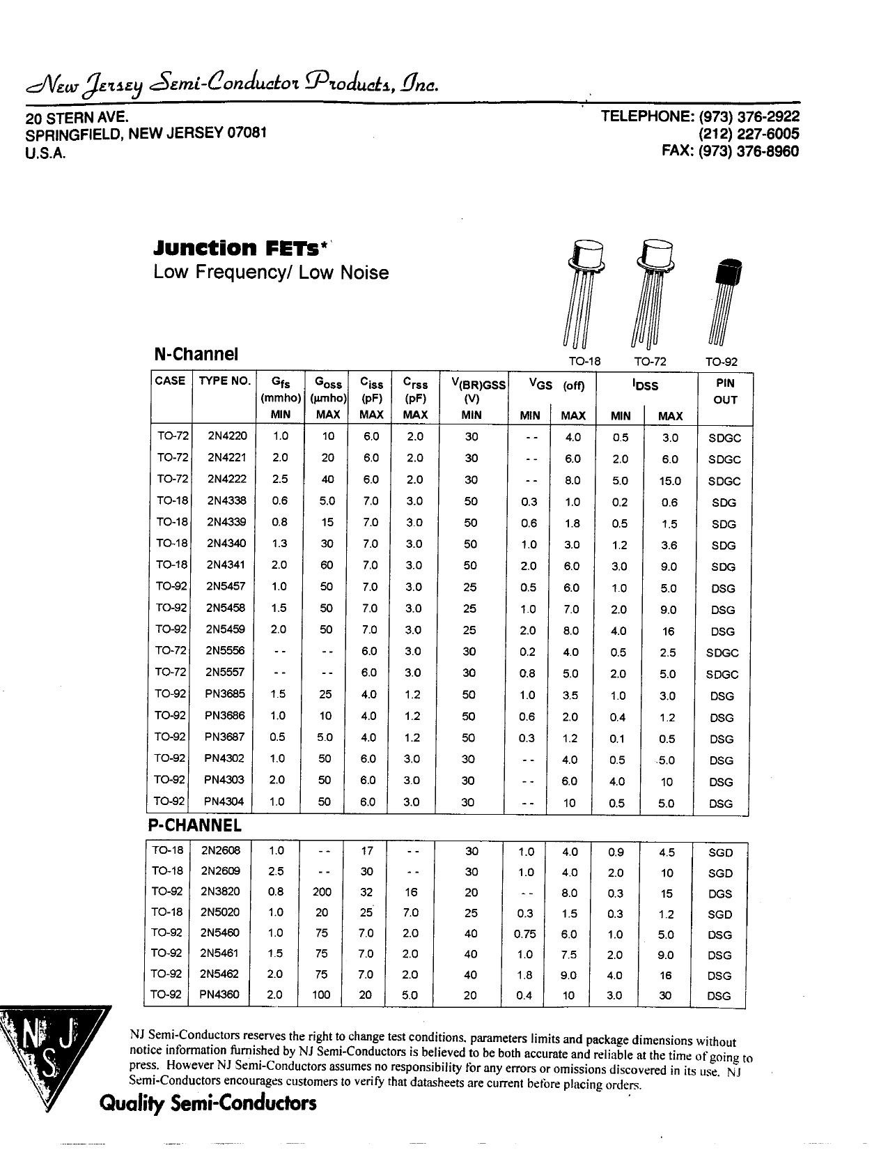

Datasheet 2N4220-2N4222, 2N4338-2N4341, 2N5457-2N5459, 2N5556, 2N5557, PN3685-PN3687, PN4302-PN4304, 2N2608, 2N2609, 2N3820, 2N5020, 2N5460-2N5461, PN4360 (New Jersey Semiconductor)
| Manufacturer | New Jersey Semiconductor |
| Description | Junction FETs Low Frequency, Low Noise |
| Pages / Page | 1 / 1 — tSemL-CondiLctoi iPioduati, {Jnc. TELEPHONE: (973) 376-2922. … |
| File Format / Size | PDF / 56 Kb |
tSemL-CondiLctoi iPioduati, {Jnc. TELEPHONE: (973) 376-2922. (212)227-6005. FAX: (973) 376-8960 20 STERN AVE
(212)227-6005
FAX: (973) 376-8960 20 STERN AVE.
SPRINGFIELD, NEW JERSEY 07081
U.S.A. Junction FETs*
Low Frequency/ Low Noise N-Channel
CASE TYPE NO. TO-72 TO-18 (PF)
MAX Crss
(PF)
MAX 10 6.0 Gfs
Goss
(mmho) (Him ho
MAX
MIN ciss V(BR)GSS VGJ> (off) 'D ss TO-92
PIN (V)
MIN MIN MAX MIN MAX 2.0 30 -4.0 0.5 3.0 SDGC 30 -6.0 2.0 6.0 SDGC TO-72 2N4220 1.0 TO-72 2N4221 2.0 20 6.0 2.0 OUT TO-72 2N4222 2.5 40 6.0 2.0 30 -8.0 5.0 15.0 SDGC TO-18 2N4338 0.6 5.0 7.0 3.0 50 0.3 1.0 0.2 0.6 SDG TO-18 2N4339 0.8 15 7.0 3.0 50 0.6 1.8 0.5 1.5 SDG TO-18 2N4340 1.3 30 7.0 3.0 50 1.0 3.0 1.2 3.6 SDG TO-18 2N4341 2.0 60 7.0 3.0 50 2.0 6.0 3.0 9.0 SDG TO-92 2N5457 1.0 50 7.0 3.0 25 0.5 6.0 1.0 5.0 DSG 9.0 DSG TO-92 2N5458 1.5 50 7.0 3.0 25 1.0 7.0 2.0 TO-92 2N5459 2.0 50 7.0 3.0 25 2.0 8.0 4.0 16 DSG TO-72 2N5556 -6.0 3.0 30 0.2 4.0 0.5 2.5 SDGC TO-72 2N5557 -6.0 3.0 30 0.8 5.0 2.0 5.0 SDGC TO-92 PN3685 1.5 25 4.0 1.2 50 1.0 3.5 1.0 3.0 DSG TO-92 PN3686 1.0 10 4.0 1.2 50 0.6 2.0 0.4 1.2 DSG TO-92 PN3687 0.5 5.0 4.0 1.2 50 0.3 1.2 0.1 0.5 DSG 5.0 DSG TO-92 PN4302 1.0 50 6.0 3.0 30 -4.0 0.5 TO-92 PN4303 2.0 50 6.0 3.0 30 -6.0 4.0 10 DSG TO-92 PN4304 1.0 50 6.0 3.0 30 -10 0.5 5.0 DSG P-CHANNEL
TO-18 2N2608 1.0 -17 -30 1.0 4.0 0.9 4.5 SGD TO-18 2N2609 2.5 -30 -30 1.0 4,0 2.0 10 SGD TO-92 2N3820 0.8 200 32 16 20 . 8.0 0.3 15 DGS TO-18 2N5020 1.0 20 25 7.0 25 0.3 1.5 0.3 1.2 SGD TO-92 2N5460 1.0 75 7.0 2.0 40 0.75 6.0 1.0 5.0 DSG TO-92 2N5461 1.5 75 7.0 2.0 40 1.0 7.5 2.0 9.0 DSG TO-92 2N5462 2.0 75 7.0 2.0 40 1.8 9.0 4.0 16 DSG TO-92 PN4360 2.0 100 20 5.0 20 0.4 10 3.0 30 DSG NJ Semi-Conductors reserves the right to change test conditions, parameters limits and package dimensions without
