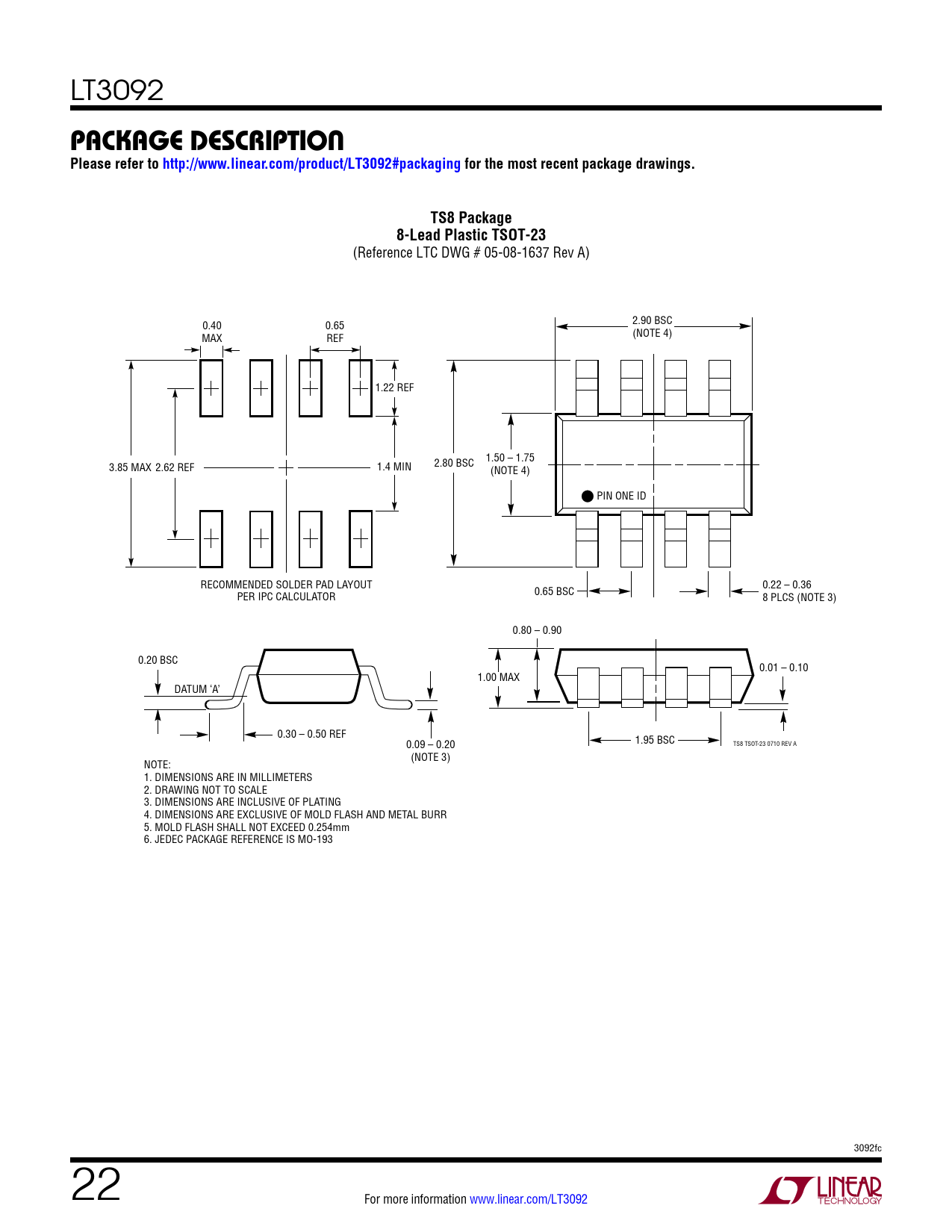

package DescripTion. Please refer to http://www.linear.com/product/LT3092#packaging for the most recent package drawings
package DescripTion Please refer to http://www.linear.com/product/LT3092#packaging for the most recent package drawings
LT3092
package DescripTion Please refer to http://www.linear.com/product/LT3092#packaging for the most recent package drawings. TS8 Package 8-Lead Plastic TSOT-23
(Reference LTC DWG # 05-08-1637 Rev A) 2.90 BSC 0.40 0.65 (NOTE 4) MAX REF 1.22 REF 1.50 – 1.75 2.80 BSC 3.85 MAX 2.62 REF 1.4 MIN (NOTE 4) PIN ONE ID RECOMMENDED SOLDER PAD LAYOUT 0.22 – 0.36 0.65 BSC PER IPC CALCULATOR 8 PLCS (NOTE 3) 0.80 – 0.90 0.20 BSC 0.01 – 0.10 1.00 MAX DATUM ‘A’ 0.30 – 0.50 REF 0.09 – 0.20 1.95 BSC TS8 TSOT-23 0710 REV A (NOTE 3) NOTE: 1. DIMENSIONS ARE IN MILLIMETERS 2. DRAWING NOT TO SCALE 3. DIMENSIONS ARE INCLUSIVE OF PLATING 4. DIMENSIONS ARE EXCLUSIVE OF MOLD FLASH AND METAL BURR 5. MOLD FLASH SHALL NOT EXCEED 0.254mm 6. JEDEC PACKAGE REFERENCE IS MO-193 3092fc 22 For more information www.linear.com/LT3092 Document Outline Description Typical Application Absolute Maximum Ratings Pin Configuration Electrical Characteristics Typical Performance Characteristics Pin Functions Applications Information Package Description Related Parts
