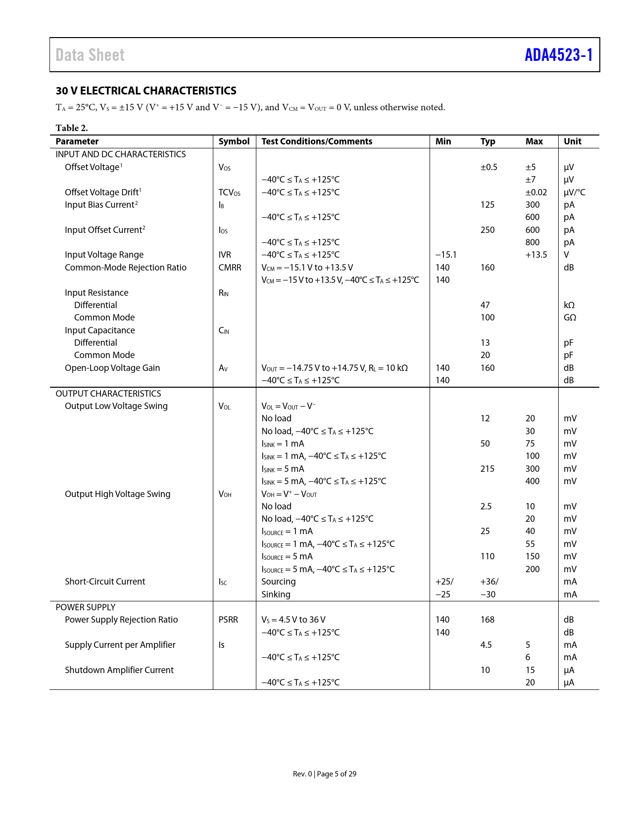

Data Sheet ADA4523-1 30 V ELECTRICAL CHARACTERISTICS
TA = 25°C, VS = ±15 V (V+ = +15 V and V− = −15 V), and VCM = VOUT = 0 V, unless otherwise noted.
Table 2. Parameter Symbol Test Conditions/Comments Min Typ Max Unit
INPUT AND DC CHARACTERISTICS Offset Voltage1 VOS ±0.5 ±5 µV −40°C ≤ TA ≤ +125°C ±7 µV Offset Voltage Drift1 TCVOS −40°C ≤ TA ≤ +125°C ±0.02 µV/°C Input Bias Current2 IB 125 300 pA −40°C ≤ TA ≤ +125°C 600 pA Input Offset Current2 IOS 250 600 pA −40°C ≤ TA ≤ +125°C 800 pA Input Voltage Range IVR −40°C ≤ TA ≤ +125°C −15.1 +13.5 V Common-Mode Rejection Ratio CMRR VCM = −15.1 V to +13.5 V 140 160 dB VCM = −15 V to +13.5 V, −40°C ≤ TA ≤ +125°C 140 Input Resistance RIN Differential 47 kΩ Common Mode 100 GΩ Input Capacitance CIN Differential 13 pF Common Mode 20 pF Open-Loop Voltage Gain AV VOUT = −14.75 V to +14.75 V, RL = 10 kΩ 140 160 dB −40°C ≤ TA ≤ +125°C 140 dB OUTPUT CHARACTERISTICS Output Low Voltage Swing VOL VOL = VOUT − V− No load 12 20 mV No load, −40°C ≤ TA ≤ +125°C 30 mV ISINK = 1 mA 50 75 mV ISINK = 1 mA, −40°C ≤ TA ≤ +125°C 100 mV ISINK = 5 mA 215 300 mV ISINK = 5 mA, −40°C ≤ TA ≤ +125°C 400 mV Output High Voltage Swing VOH VOH = V+ − VOUT No load 2.5 10 mV No load, −40°C ≤ TA ≤ +125°C 20 mV ISOURCE = 1 mA 25 40 mV ISOURCE = 1 mA, −40°C ≤ TA ≤ +125°C 55 mV ISOURCE = 5 mA 110 150 mV ISOURCE = 5 mA, −40°C ≤ TA ≤ +125°C 200 mV Short-Circuit Current ISC Sourcing +25/ +36/ mA Sinking −25 −30 mA POWER SUPPLY Power Supply Rejection Ratio PSRR VS = 4.5 V to 36 V 140 168 dB −40°C ≤ TA ≤ +125°C 140 dB Supply Current per Amplifier Is 4.5 5 mA −40°C ≤ TA ≤ +125°C 6 mA Shutdown Amplifier Current 10 15 µA −40°C ≤ TA ≤ +125°C 20 µA Rev. 0 | Page 5 of 29 Document Outline FEATURES APPLICATIONS GENERAL DESCRIPTION TYPICAL APPLICATION DIAGRAM COMPANION PRODUCTS TABLE OF CONTENTS REVISION HISTORY SPECIFICATIONS 5 V ELECTRICAL CHARACTERISTICS 30 V ELECTRICAL CHARACTERISTICS ABSOLUTE MAXIMUM RATINGS THERMAL RESISTANCE ESD CAUTION PIN CONFIGURATIONS AND FUNCTION DESCRIPTIONS TYPICAL PERFORMANCE CHARACTERISTICS THEORY OF OPERATION INPUT VOLTAGE NOISE INPUT CURRENT NOISE INPUT BIAS CURRENT THERMOCOUPLE EFFECTS POWER DISSIPATION ELECTRICAL OVERSTRESS AND INPUT PROTECTION SHUTDOWN MODE APPLICATIONS INFORMATION PARALLELING CHOPPERS TO IMPROVE NOISE SOLDER PAD LAYOUTS TYPICAL APPLICATION CIRCUIT AND TRANSFER FUNCTION RELATED PRODUCTS OUTLINE DIMENSIONS ORDERING GUIDE
