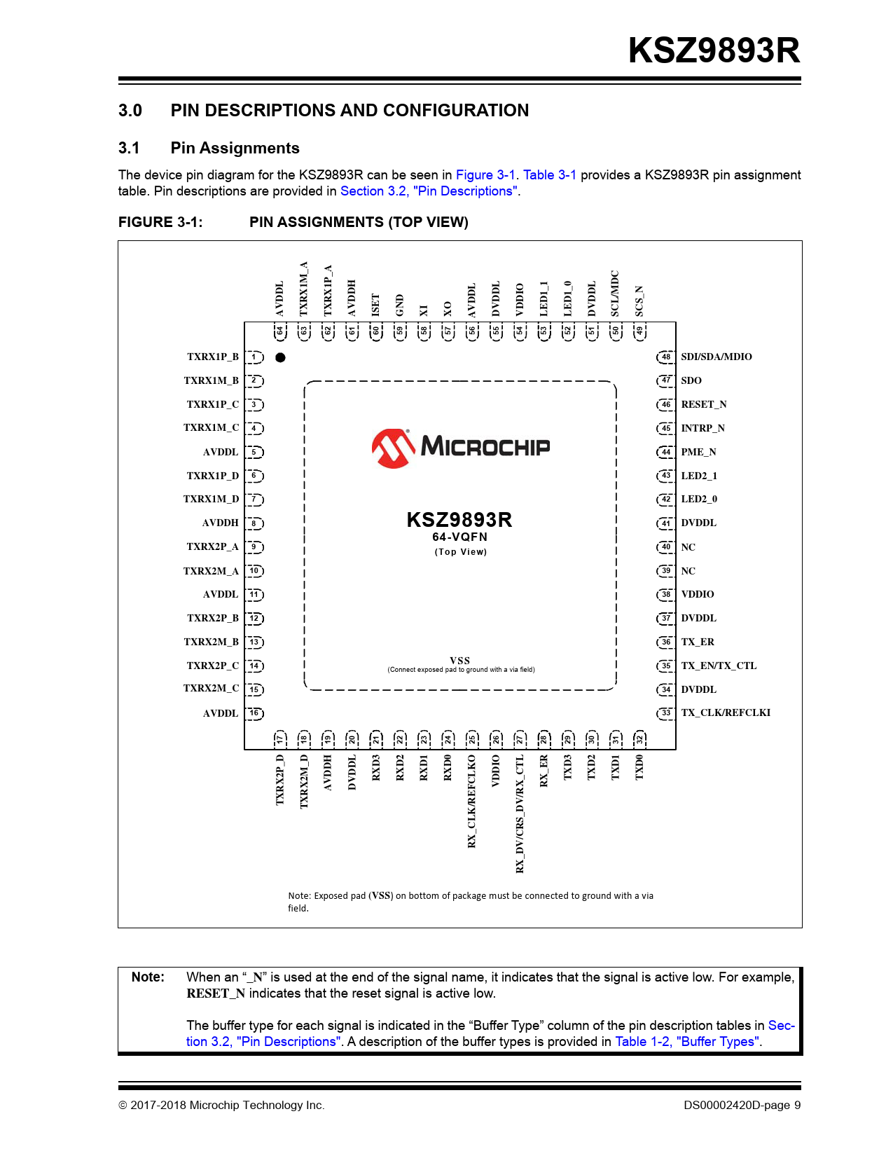

The device pin diagram for the KSZ9893R can be seen in Figure 3-1. Table 3-1 provides a KSZ9893R pin assignment table. Pin descriptions are provided in Section 3.2, "Pin Descriptions".
FIGURE 3-1: PIN ASSIGNMENTS (TOP VIEW) A A _ _ C M P L 1 1 H L 1 0 L D D X X D D _ _ IO 1 1 D N T /M D R R D D _ DDL D D D D D E L S AV TX TX AV IS GN XI XO AV DV VD LE LE DV SC SC 64 63 62 61 60 59 58 57 56 55 54 53 52 51 50 49 TXRX1P_B 1 48 SDI/SDA/MDIO TXRX1M_B 2 47 SDO TXRX1P_C 3 46 RESET_N TXRX1M_C 4 45 INTRP_N AVDDL 5 44 PME_N TXRX1P_D 6 43 LED2_1 TXRX1M_D 7 42 LED2_0 AVDDH 8 KSZ9893R 41 DVDDL 64-VQFN TXRX2P_A 9 40 ( T o p V i e w) NC TXRX2M_A 10 39 NC AVDDL 11 38 VDDIO TXRX2P_B 12 37 DVDDL TXRX2M_B 13 36 TX_ER V S S TXRX2P_C 14 35
(Connect exposed pad to ground with a via field)
TX_EN/TX_CTL TXRX2M_C 15 34 DVDDL AVDDL 16 33 TX_CLK/REFCLKI 17 18 19 20 21 22 23 24 25 26 27 28 29 30 31 32 D O 3 L 2 1 0 _ _D D3 D2 DH D1 D0 IO ER K D D D D P DDL 2 L CT 2M RX RX RX RX TX TX X TX TX X VDD RX_ R AVD DV R EFC /RX_ TX X /R V T D LK _ C _ X CRS R V/ D _ RX
Note: Exposed pad
(VSS
) on bottom of package must be connected to ground with a via  field.
Note:
When an “
_N
” is used at the end of the signal name, it indicates that the signal is active low. For example,
