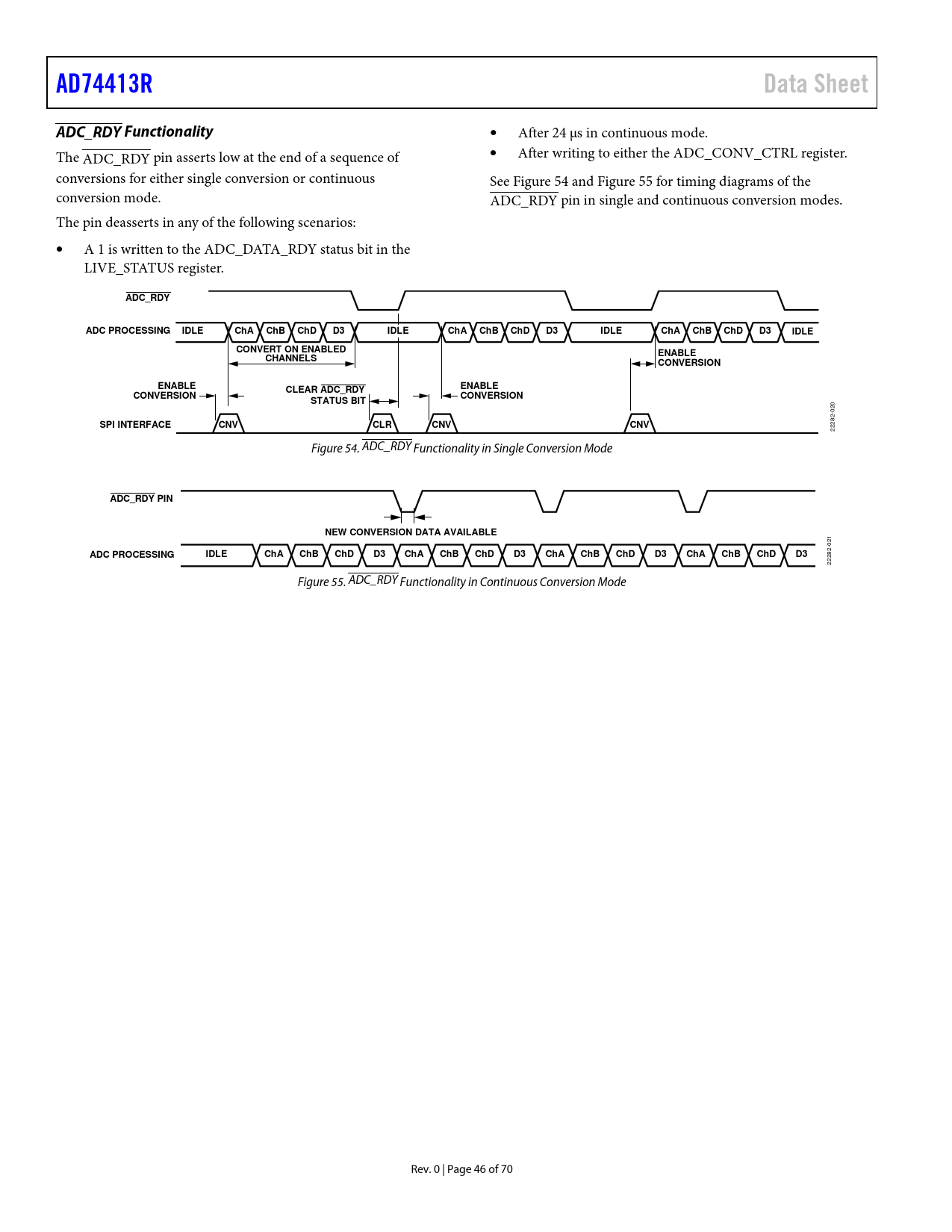

AD74413R Data Sheet ADC_RDY Functionality
• After 24 µs in continuous mode. The ADC_RDY pin asserts low at the end of a sequence of • After writing to either the ADC_CONV_CTRL register. conversions for either single conversion or continuous See Figure 54 and Figure 55 for timing diagrams of the conversion mode. ADC_RDY pin in single and continuous conversion modes. The pin deasserts in any of the following scenarios: • A 1 is written to the ADC_DATA_RDY status bit in the LIVE_STATUS register.
ADC_RDY ADC PROCESSING IDLE ChA ChB ChD D3 IDLE ChA ChB ChD D3 IDLE ChA ChB ChD D3 IDLE CONVERT ON ENABLED ENABLE CHANNELS CONVERSION ENABLE ENABLE CLEAR ADC_RDY CONVERSION CONVERSION STATUS BIT
020
SPI INTERFACE CNV CLR CNV CNV
22282- Figure 54. ADC_RDY Functionality in Single Conversion Mode
ADC_RDY PIN NEW CONVERSION DATA AVAILABLE
021
ADC PROCESSING IDLE ChA ChB ChD D3 ChA ChB ChD D3 ChA ChB ChD D3 ChA ChB ChD D3
