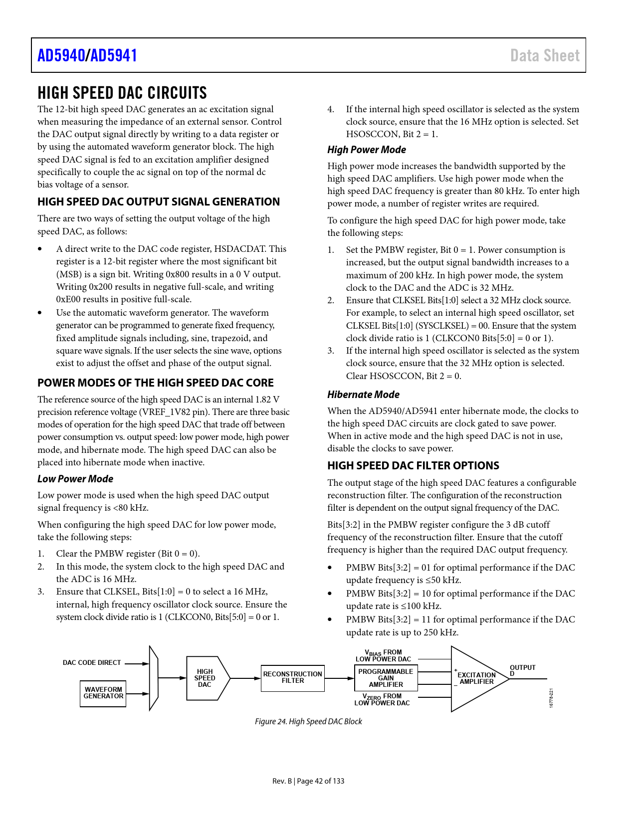

AD5940/. AD5941. Data Sheet. HIGH SPEED DAC CIRCUITS. High Power Mode. HIGH SPEED DAC OUTPUT SIGNAL GENERATION
AD5940/ AD5941 Data Sheet HIGH SPEED DAC CIRCUITS High Power Mode HIGH SPEED DAC OUTPUT SIGNAL GENERATION
The 12-bit high speed DAC generates an ac excitation signal 4. If the internal high speed oscillator is selected as the system when measuring the impedance of an external sensor. Control clock source, ensure that the 16 MHz option is selected. Set the DAC output signal directly by writing to a data register or HSOSCCON, Bit 2 = 1. by using the automated waveform generator block. The high
High Power Mode
speed DAC signal is fed to an excitation amplifier designed specifically to couple the ac signal on top of the normal dc High power mode increases the bandwidth supported by the bias voltage of a sensor. high speed DAC amplifiers. Use high power mode when the high speed DAC frequency is greater than 80 kHz. To enter high
power mode, a number of register writes are required. There are two ways of setting the output voltage of the high To configure the high speed DAC for high power mode, take speed DAC, as follows: the following steps: • A direct write to the DAC code register, HSDACDAT. This 1. Set the PMBW register, Bit 0 = 1. Power consumption is register is a 12-bit register where the most significant bit increased, but the output signal bandwidth increases to a (MSB) is a sign bit. Writing 0x800 results in a 0 V output. maximum of 200 kHz. In high power mode, the system Writing 0x200 results in negative full-scale, and writing clock to the DAC and the ADC is 32 MHz. 0xE00 results in positive full-scale. 2. Ensure that CLKSEL Bits[1:0] select a 32 MHz clock source. • Use the automatic waveform generator. The waveform For example, to select an internal high speed oscillator, set generator can be programmed to generate fixed frequency, CLKSEL Bits[1:0] (SYSCLKSEL) = 00. Ensure that the system fixed amplitude signals including, sine, trapezoid, and clock divide ratio is 1 (CLKCON0 Bits[5:0] = 0 or 1). square wave signals. If the user selects the sine wave, options 3. If the internal high speed oscillator is selected as the system exist to adjust the offset and phase of the output signal. clock source, ensure that the 32 MHz option is selected.
POWER MODES OF THE HIGH SPEED DAC CORE
Clear HSOSCCON, Bit 2 = 0. The reference source of the high speed DAC is an internal 1.82 V
Hibernate Mode
precision reference voltage (VREF_1V82 pin). There are three basic When the AD5940/AD5941 enter hibernate mode, the clocks to modes of operation for the high speed DAC that trade off between the high speed DAC circuits are clock gated to save power. power consumption vs. output speed: low power mode, high power When in active mode and the high speed DAC is not in use, mode, and hibernate mode. The high speed DAC can also be disable the clocks to save power. placed into hibernate mode when inactive.
HIGH SPEED DAC FILTER OPTIONS Low Power Mode
The output stage of the high speed DAC features a configurable Low power mode is used when the high speed DAC output reconstruction filter. The configuration of the reconstruction signal frequency is <80 kHz. filter is dependent on the output signal frequency of the DAC. When configuring the high speed DAC for low power mode, Bits[3:2] in the PMBW register configure the 3 dB cutoff take the following steps: frequency of the reconstruction filter. Ensure that the cutoff 1. Clear the PMBW register (Bit 0 = 0). frequency is higher than the required DAC output frequency. 2. In this mode, the system clock to the high speed DAC and • PMBW Bits[3:2] = 01 for optimal performance if the DAC the ADC is 16 MHz. update frequency is ≤50 kHz. 3. Ensure that CLKSEL, Bits[1:0] = 0 to select a 16 MHz, • PMBW Bits[3:2] = 10 for optimal performance if the DAC internal, high frequency oscillator clock source. Ensure the update rate is ≤100 kHz. system clock divide ratio is 1 (CLKCON0, Bits[5:0] = 0 or 1. • PMBW Bits[3:2] = 11 for optimal performance if the DAC update rate is up to 250 kHz.
VBIAS FROM DAC CODE DIRECT LOW POWER DAC OUTPUT HIGH RECONSTRUCTION PROGRAMMABLE + D SPEED EXCITATION FILTER GAIN DAC AMPLIFIER AMPLIFIER WAVEFORM GENERATOR V
221
ZERO FROM LOW POWER DAC
16778- Figure 24. High Speed DAC Block Rev. B | Page 42 of 133 Document Outline FEATURES APPLICATIONS SIMPLIFIED BLOCK DIAGRAM TABLE OF CONTENTS REVISION HISTORY FUNCTIONAL BLOCK DIAGRAM GENERAL DESCRIPTION SPECIFICATIONS ADC RMS NOISE SPECIFICATIONS ADC RMS Noise: Digital Filter Settings ADC RMS Noise: Peak-to-Peak Effective Bits SPI TIMING SPECIFICATIONS SPI Timing Diagram ABSOLUTE MAXIMUM RATINGS THERMAL RESISTANCE ESD CAUTION PIN CONFIGURATION AND FUNCTION DESCRIPTIONS TYPICAL PERFORMANCE CHARACTERISTICS REFERENCE TEST CIRCUIT THEORY OF OPERATION CONFIGURATION REGISTERS Configuration Register—AFECON Power Mode Configuration Register—PMBW SILICON IDENTIFICATION IDENTIFICATION REGISTERS Analog Devices, Inc., Identification Register—ADIID Chip Identification Register—CHIPID SYSTEM INITIALIZATION LOW POWER DAC LOW POWER DAC SWITCH OPTIONS RELATIONSHIP BETWEEN THE 12-BIT AND 6-BIT OUTPUTS LOW POWER DAC USE CASES Electrochemical Amperometric Measurement Electrochemical Impedance Spectroscopy Low Power DAC in 4-Wire Isolated Impedance Measurements LOW POWER DAC CIRCUIT REGISTERS LPDACCON0 Register—LPDACCON0 Low Power DAC Switch Control Register—LPDACSW0 Low Power DAC Data Output Register—LPDACDAT0 Low Power Reference Control Register—LPREFBUFCON Common-Mode Switch Mux Register—SWMUX LOW POWER POTENTIOSTAT LOW POWER TIA LOW POWER TIA PROTECTION DIODES Current-Limit Feature of the Low Power TIA and Potentiostat amplifier Low Power TIA Force/Sense Feature USING AN EXTERNAL RTIA RECOMMENDED SWITCH SETTINGS FOR VARIOUS OPERATING MODES LOW POWER TIA CIRCUITS REGISTERS Low Power TIA Switch Configuration Register—LPTIASW0 Low Power TIA Control Bits, Channel 0 Register—LPTIACON0 HIGH SPEED DAC CIRCUITS HIGH SPEED DAC OUTPUT SIGNAL GENERATION POWER MODES OF THE HIGH SPEED DAC CORE Low Power Mode High Power Mode Hibernate Mode HIGH SPEED DAC FILTER OPTIONS HIGH SPEED DAC OUTPUT ATTENUATION OPTIONS HIGH SPEED DAC EXCITATION AMPLIFIER COUPLING AN AC SIGNAL FROM THE HIGH SPEED DAC TO THE DC LEVEL SET BY THE LOW POWER DAC AVOIDING INCOHERENCY ERRORS BETWEEN EXCITATION AND MEASUREMENT FREQUENCIES DURING IMPEDANCE MEASUREMENTS HIGH SPEED DAC CALIBRATION OPTIONS HIGH SPEED DAC CIRCUIT REGISTERS High Speed DAC Configuration Register—HSDACCON High Speed DAC Code Register—HSDACDAT Calibration Data Lock Register—CALDATLOCK DAC Gain Register—DACGAIN DAC Offset with Attenuator Enabled (Low Power Mode) Register—DACOFFSETATTEN DAC Offset with Attenuator Disabled (Low Power Mode Register)—DACOFFSET DAC Offset with Attenuator Enabled (High Speed Mode Register)—DACOFFSETATTENHS DAC Offset with Attenuator Disabled (High Speed Mode Register)—DACOFFSETHS HIGH SPEED TIA CIRCUITS HIGH SPEED TIA CONFIGURATION Input Signal Selection Gain Resistor Selection Load Resistor Selection Common-Mode Voltage Selection External RTIA Selection HIGH SPEED TIA CIRCUIT REGISTERS High Speed RTIA Configuration Register—HSRTIACON DE0 High Speed TIA Resistors Configuration Register—DE0RESCON High Speed TIA Configuration Register—HSTIACON HIGH PERFORMANCE ADC CIRCUIT ADC CIRCUIT OVERVIEW ADC CIRCUIT DIAGRAM ADC CIRCUIT FEATURES ADC CIRCUIT OPERATION ADC TRANSFER FUNCTION ADC LOW POWER CURRENT INPUT CHANNEL SELECTING INPUTS TO ADC MUX ADC POSTPROCESSING Sinc3 Filter INTERNAL TEMPERATURE SENSOR CHANNEL SINC2 FILTER (50 HZ/60 HZ MAINS FILTER) ADC CALIBRATION ADC CIRCUIT REGISTERS ADC Output Filters Configuration Register—ADCFILTERCON ADC Raw Result Register—ADCDAT DFT Result, Real Device Register—DFTREAL DFT Result, Imaginary Device Register—DFTIMAG Sinc2 Filter Result Register—SINC2DAT Temperature Sensor Result Register—TEMPSENSDAT DFT Configuration Register—DFTCON Temperature Sensor Configuration Register—TEMPSENS ADC Configuration Register—ADCCON Repeat ADC Conversions Control Register—REPEATADCCNV ADC Buffer Configuration Register—ADCBUFCON ADC CALIBRATION REGISTERS Calibration Data Lock Register—CALDATLOCK ADC Offset Calibration on the Low Power TIA Channel Register—ADCOFFSETLPTIA ADC Gain Calibration for the Low Power TIA Channel Register—ADCGNLPTIA ADC Offset Calibration on the High Speed TIA Channel Register—ADCOFFSETHSTIA ADC Gain Calibration for the High Speed TIA Channel Register—ADCGAINHSTIA ADC Offset Calibration Auxiliary Channel (PGA Gain = 1) Register—ADCOFFSETGN1 ADC Gain Calibration Auxiliary Input Channel (PGA Gain = 1) Register—ADCGAINGN1 ADC Offset Calibration Auxiliary Input Channel (PGA Gain = 1.5) Register—ADCOFFSETGN1P5 ADC Gain Calibration Auxiliary Input Channel (PGA Gain = 1.5) Register—ADCGAINGN1P5 ADC Offset Calibration Auxiliary Input Channel (PGA Gain = 2) Register—ADCOFFSETGN2 ADC Gain Calibration Auxiliary Input Channel (PGA Gain = 2) Register—ADCGAINGN2 ADC Offset Calibration Auxiliary Input Channel (PGA Gain = 4) Register—ADCOFFSETGN4 ADC Gain Calibration Auxiliary Input Channel (PGA Gain = 4) Register—ADCGAINGN4 ADC Offset Calibration Auxiliary Input Channel (PGA Gain = 9) Register—ADCOFFSETGN9 ADC Gain Calibration Auxiliary Input Channel (PGA Gain = 9) Register—ADCGAINGN9 ADC Offset Calibration Temperature Sensor Channel Register—ADCOFFSETTEMPSENS ADC Gain Calibration Temperature Sensor Channel Register—ADCGAINTEMPSENS ADC DIGITAL POSTPROCESSING REGISTERS (OPTIONAL) ADC Minimum Value Check Register—ADCMIN ADC Minimum Hysteresis Value Register—ADCMINSM ADC Maximum Value Check Register—ADCMAX ADC Maximum Hysteresis Value Register—ADCMAXSMEN ADC Delta Value Check Register—ADCDELTA ADC STATISTICS REGISTERS Variance Output Register—STATSVAR Statistics Control Register—STATSCON Statistics Mean Output Register—STATSMEAN PROGRAMMABLE SWITCH MATRIX SWITCH DESCRIPTIONS Dx/DR0 Switches Px/Pxx Switches Nx/Nxx Switches Tx/TR1 Switches AFEx Switches RECOMMENDED CONFIGURATION IN HIBERNATE MODE OPTIONS FOR CONTROLLING ALL SWITCHES PROGRAMMABLE SWITCHES REGISTERS Switch Matrix Configuration Register—SWCON Switch Matrix Full Configuration Dx/DR0 Register—DSWFULLCON Switch Matrix Full Configuration Nx/Nxx Register—NSWFULLCON Switch Matrix Full Configuration Px/Pxx Register—PSWFULLCON Switch Matrix Full Configuration Tx/TR1 Register—TSWFULLCON Switch Matrix Status Dx/DR0 Register—DSWSTA Switch Matrix Status Px/Pxx Register—PSWSTA Switch Matrix Status Nx/Nxx Register—NSWSTA Switch Matrix Status Tx/TR1 Register—TSWSTA PRECISION VOLTAGE REFERENCES HIGH POWER AND LOW POWER BUFFER CONTROL REGISTER—BUFSENCON SEQUENCER SEQUENCER FEATURES SEQUENCER OVERVIEW SEQUENCER COMMANDS Write Command Timer Command SEQUENCER OPERATION Command Memory Loading Sequences Data FIFO Data FIFO Word Format Sequencer and the Sleep and Wake-Up Timer Configuring the GPIOx Pin Mux Sequencer Conflicts SEQUENCER AND FIFO REGISTERS Sequencer Configuration Register—SEQCON FIFO Configuration Register—FIFOCON Sequencer CRC Value Register—SEQCRC Sequencer Timeout Counter Register—SEQTIMEOUT Data FIFO Read Register—DATAFIFORD Command FIFO Write Register—CMDFIFOWRITE Sequencer Sleep Control Lock Register—SEQSLPLOCK Sequencer Trigger Sleep Register—SEQTRGSLP Sequence 0 Information Register—SEQ0INFO Sequence 2 Information Register—SEQ2INFO Command FIFO Write Address Register—CMDFIFOWADDR Command Data Control Register—CMDDATACON Data FIFO Threshold Register—DATAFIFOTHRES Sequence 3 Information Register—SEQ3INFO Sequence 1 Information Register—SEQ1INFO Command and Data FIFO Internal Data Count Register—FIFOCNTSTA Sync External Devices Register—SYNCEXTDEVICE Trigger Sequence Register—TRIGSEQ WAVEFORM GENERATOR WAVEFORM GENERATOR FEATURES WAVEFORM GENERATOR OPERATION Sinusoid Generator Trapezoid Generator USING THE WAVEFORM GENERATOR WITH THE LOW POWER DAC WAVEFORM GENERATOR REGISTERS Waveform Generator Configuration Register—WGCON Waveform Generator, Trapezoid DC Level 1 Register—WGDCLEVEL1 Waveform Generator, Trapezoid DC Level 2 Register—WGDCLEVEL2 Sequencer Command Count Register—SEQCNT Waveform Generator, Trapezoid Delay 1 Time Register—WGDELAY1 Waveform Generator, Trapezoid Slope 1 Time Register—WGSLOPE1 Waveform Generator, Trapezoid Delay 2 Time Register—WGDELAY2 Waveform Generator, Trapezoid Slope 2 Time Register—WGSLOPE2 Waveform Generator, Sinusoid Frequency Control Word Register—WGFCW Waveform Generator, Sinusoid Phase Offset Register—WGPHASE Waveform Generator, Sinusoid Offset Register—WGOFFSET Waveform Generator, Sinusoid Amplitude Register—WGAMPLITUDE SPI INTERFACE OVERVIEW SPI PINS Chip Select Enable SCLK MOSI and MISO SPI OPERATION COMMAND BYTE WRITING TO AND READING FROM REGISTERS READING DATA FROM THE DATA FIFO Read Data from Data FIFO SLEEP AND WAKE-UP TIMER SLEEP AND WAKE-UP TIMER FEATURES SLEEP AND WAKE-UP TIMER OVERVIEW CONFIGURING A DEFINED SEQUENCE ORDER RECOMMENDED SLEEP AND WAKE-UP TIMER OPERATION SLEEP AND WAKE-UP TIMER REGISTERS Timer Control Register—CON Order Control Register—SEQORDER Sequence 0 to Sequence 3 Wake-Up Time Registers (LSB)—SEQxWUPL Sequence 0 to Sequence 3 Wake-Up Time Registers (MSB)—SEQxWUPH Sequence 0 to Sequence 3 Sleep Time Registers (LSB)—SEQxSLEEPL Sequence 0 to Sequence 3 Sleep Time Registers (MSB)—SEQxSLEEPH Timer Wake-Up Configuration Register—TMRCON INTERRUPTS INTERRUPT CONTROLLER INTERUPTS CONFIGURING THE INTERRUPTS CUSTOM INTERRUPTS EXTERNAL INTERRUPT CONFIGURATION INTERRUPT REGISTERS Interrupt Polarity Register—INTCPOL Interrupt Clear Register—INTCCLR Interrupt Controller Select Registers—INTCSEL0 and INTCSEL1 Interrupt Controller Flag Registers—INTCFLAG0 and INTCFLAG1 Analog Generation Interrupt Register—AFEGENINTSTA EXTERNAL INTERRUPT CONFIGURATION REGISTERS External Interrupt Configuration 0 Register—EI0CON External Interrupt Configuration 1 Register—EI1CON External Interrupt Configuration 2 Register—EI2CON External Interrupt Clear Register—EICLR DIGITAL INPUTS/OUTPUTS DIGITAL INPUTS/OUTPUTS FEATURES DIGITAL INPUTS/OUTPUTS OPERATION Input/Output Pull-Up Enable Input/Output Data Input Input/Output Data Output Bit Set Bit Clear Bit Toggle Input/Output Data Output Enable Interrupt Inputs Interrupt Outputs Digital Port Multiplex GPIOx Control with the Sequencer GPIO REGISTERS GPIO Port 0 Configuration Register—GP0CON GPIO Port 0 Output Enable Register—GP0OEN GPIO Port 0 Pull-Up and Pull-Down Enable Register—GP0PE GPIO Port 0 Input Path Enable Register—GP0IEN GPIO Port 0 Registered Data Input—GP0IN GPIO Port 0 Data Output Register—GP0OUT GPIO Port 0 Data Out Set Register—GP0SET GPIO Port 0 Data Out Clear Register—GP0CLR GPIO Port 0 Pin Toggle Register—GP0TGL SYSTEM RESETS ANALOG DIE RESET REGISTERS Key Protection for the RSTCON Register—RSTCONKEY Software Reset Register—SWRSTCON Reset Status Register—RSTSTA POWER MODES ACTIVE HIGH POWER MODE (>80 kHz) ACTIVE LOW POWER MODE (<80 kHz) HIBERNATE MODE SHUTDOWN MODE LOW POWER MODE POWER MODES REGISTERS Power Modes Register—PWRMOD Key Protection for the PWRMOD Register—PWRKEY Low Power Mode AFE Control Lock Register—LPMODEKEY Low Power Mode Clock Select Register—LPMODECLKSEL Low Power Mode Configuration Register—LPMODECON CLOCKING ARCHITECTURE CLOCK FEATURES CLOCK ARCHITECTURE REGISTERS Key Protection Register for the CLKCON0 Register—CLKCON0KEY Clock Divider Configuration Register—CLKCON0 Clock Select Register—CLKSEL Clock Enable for Low Power TIA Chop and Wake-Up Timer—CLKEN0 Clock Gate Enable Register—CLKEN1 Key Protection for the OSCCON Register—OSCKEY Oscillator Control Register—OSCCON High Power Oscillator Configuration Register—HSOSCCON Key Protection for RSTCON Register—RSTCONKEY Internal Low Frequency Oscillator Register—LOSCTST APPLICATIONS INFORMATION EDA BIOIMPEDANCE MEASUREMENT USING A LOW BANDWIDTH LOOP BODY IMPEDANCE ANALYSIS (BIA) MEASUREMENT USING A HIGH BANDWIDTH LOOP HIGH PRECISION POTENTIOSAT CONFIGURATION USING THE AD5940/AD5941, AD8232, AND AD8233 FOR BIOIMPEDANCE AND ELECTROCARDIOGRAM (ECG) MEASUREMENTS SMART WATER/LIQUID QUALITY AFE OUTLINE DIMENSIONS ORDERING GUIDE
