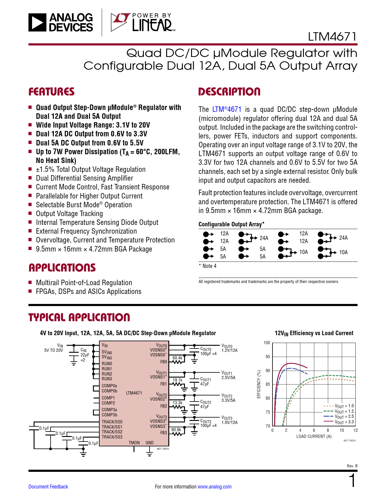

LTM4671 Quad DC/DC µModule Regulator with Configurable Dual 12A, Dual 5A Output Array
FEATURES DESCRIPTION
n
Quad Output Step-Down µModule® Regulator with
The LTM®4671 is a quad DC/DC step-down µModule
Dual 12A and Dual 5A Output
(micromodule) regulator offering dual 12A and dual 5A n
Wide Input Voltage Range: 3.1V to 20V
output. Included in the package are the switching control- n
Dual 12A DC Output from 0.6V to 3.3V
lers, power FETs, inductors and support components. n
Dual 5A DC Output from 0.6V to 5.5V
Operating over an input voltage range of 3.1V to 20V, the n
Up to 7W Power Dissipation (TA = 60°C, 200LFM,
LTM4671 supports an output voltage range of 0.6V to
No Heat Sink)
3.3V for two 12A channels and 0.6V to 5.5V for two 5A n ±1.5% Total Output Voltage Regulation channels, each set by a single external resistor. Only bulk n Dual Differential Sensing Amplifier input and output capacitors are needed. n Current Mode Control, Fast Transient Response Fault protection features include overvoltage, overcurrent n Parallelable for Higher Output Current and overtemperature protection. The LTM4671 is offered n Selectable Burst Mode® Operation in 9.5mm × 16mm × 4.72mm BGA package. n Output Voltage Tracking n Internal Temperature Sensing Diode Output
Configurable Output Array*
n External Frequency Synchronization 12A 12A 24A 24A n Overvoltage, Current and Temperature Protection 12A 12A n 9.5mm × 16mm × 4.72mm BGA Package 5A 5A 10A 10A 5A 5A
APPLICATIONS
* Note 4 n Multirail Point-of-Load Regulation All registered trademarks and trademarks are the property of their respective owners. n FPGAs, DSPs and ASICs Applications
TYPICAL APPLICATION 4V to 20V Input, 12A, 12A, 5A, 5A DC/DC Step-Down µModule Regulator 12VIN Efficiency vs Load Current
