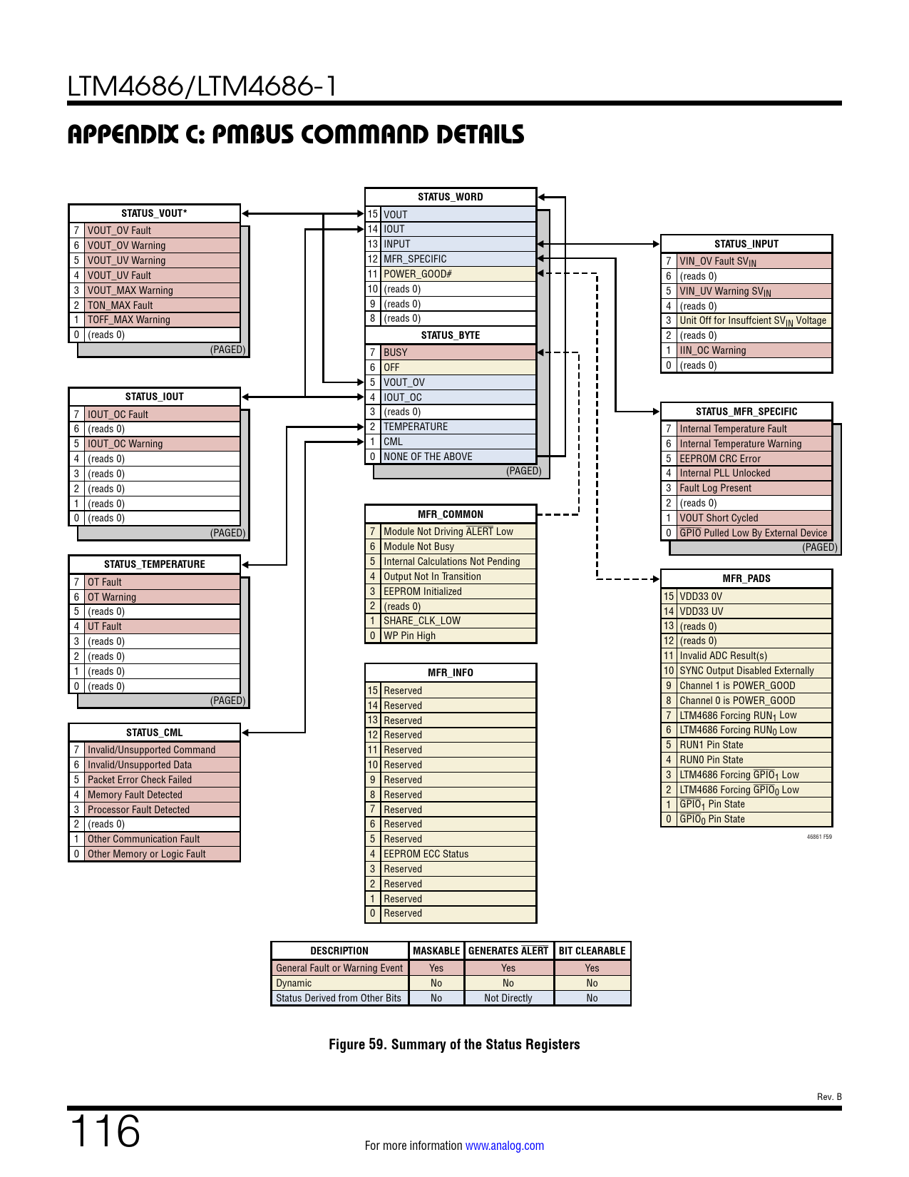

APPENDIX C: PMBUS COMMAND DETAILS. STATUS_WORD. STATUS_VOUT*. STATUS_INPUT. STATUS_BYTE. STATUS_IOUT. STATUS_MFR_SPECIFIC. MFR_COMMON
LTM4686/LTM4686-1
APPENDIX C: PMBUS COMMAND DETAILS STATUS_WORD STATUS_VOUT*
15 VOUT 7 VOUT_OV Fault 14 IOUT 6 VOUT_OV Warning 13 INPUT
STATUS_INPUT
5 VOUT_UV Warning 12 MFR_SPECIFIC 7 VIN_OV Fault SVIN 4 VOUT_UV Fault 11 POWER_GOOD# 6 (reads 0) 3 VOUT_MAX Warning 10 (reads 0) 5 VIN_UV Warning SVIN 2 TON_MAX Fault 9 (reads 0) 4 (reads 0) 1 TOFF_MAX Warning 8 (reads 0) 3 Unit Off for Insuffcient SVIN Voltage 0 (reads 0)
STATUS_BYTE
2 (reads 0) (PAGED) 7 BUSY 1 IIN_OC Warning 6 OFF 0 (reads 0) 5 VOUT_OV
STATUS_IOUT
4 IOUT_OC 7 IOUT_OC Fault 3 (reads 0)
STATUS_MFR_SPECIFIC
6 (reads 0) 2 TEMPERATURE 7 Internal Temperature Fault 5 IOUT_OC Warning 1 CML 6 Internal Temperature Warning 4 (reads 0) 0 NONE OF THE ABOVE 5 EEPROM CRC Error (PAGED) 3 (reads 0) 4 Internal PLL Unlocked 2 (reads 0) 3 Fault Log Present 1 (reads 0) 2 (reads 0)
MFR_COMMON
0 (reads 0) 1 VOUT Short Cycled (PAGED) 7 Module Not Driving ALERT Low 0 GPIO Pulled Low By External Device 6 Module Not Busy (PAGED) 5 Internal Calculations Not Pending
STATUS_TEMPERATURE
4 Output Not In Transition
MFR_PADS
7 OT Fault 3 EEPROM Initialized 6 OT Warning 15 VDD33 0V 2 (reads 0) 5 (reads 0) 14 VDD33 UV 1 SHARE_CLK_LOW 4 UT Fault 13 (reads 0) 0 WP Pin High 3 (reads 0) 12 (reads 0) 2 (reads 0) 11 Invalid ADC Result(s) 1 (reads 0)
MFR_INFO
10 SYNC Output Disabled Externally 0 (reads 0) 9 Channel 1 is POWER_GOOD 15 Reserved (PAGED) 8 Channel 0 is POWER_GOOD 14 Reserved 7 LTM4686 Forcing RUN1 Low 13 Reserved
STATUS_CML
6 LTM4686 Forcing RUN0 Low 12 Reserved 5 RUN1 Pin State 7 Invalid/Unsupported Command 11 Reserved 4 RUN0 Pin State 6 Invalid/Unsupported Data 10 Reserved 3 LTM4686 Forcing GPIO1 Low 5 Packet Error Check Failed 9 Reserved 2 LTM4686 Forcing GPIO0 Low 4 Memory Fault Detected 8 Reserved 1 GPIO1 Pin State 3 Processor Fault Detected 7 Reserved 0 GPIO0 Pin State 2 (reads 0) 6 Reserved 46861 F59 1 Other Communication Fault 5 Reserved 0 Other Memory or Logic Fault 4 EEPROM ECC Status 3 Reserved 2 Reserved 1 Reserved 0 Reserved
DESCRIPTION MASKABLE GENERATES ALERT BIT CLEARABLE
General Fault or Warning Event Yes Yes Yes Dynamic No No No Status Derived from Other Bits No Not Directly No
Figure 59. Summary of the Status Registers
