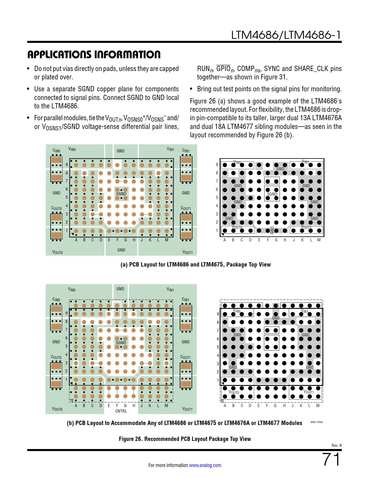

APPLICATIONS INFORMATION. (a) PCB Layout for LTM4686 and LTM4675, Package Top View
APPLICATIONS INFORMATION (a) PCB Layout for LTM4686 and LTM4675, Package Top View
link to page 74 link to page 71 link to page 71 LTM4686/LTM4686-1
• Do not put vias directly on pads, unless they are capped RUNn, GPIOn, COMPna, SYNC and SHARE_CLK pins or plated over. together—as shown in Figure 31. • Use a separate SGND copper plane for components • Bring out test points on the signal pins for monitoring. connected to signal pins. Connect SGND to GND local Figure 26 (a) shows a good example of the LTM4686's to the LTM4686. recommended layout. For flexibility, the LTM4686 is drop- • For parallel modules, tie the V + – OUTn, VOSNS0 /VOSNS and/ in pin-compatible to its taller, larger dual 13A LTM4676A or VOSNS1/SGND voltage-sense differential pair lines, and dual 18A LTM4677 sibling modules—as seen in the layout recommended by Figure 26 (b). C V IN0 IN0 VIN1 GND CIN1 V V 9 9 IN0 IN1 GND 8 8 7 7 GND GND 6 6 GND SGND GND SGND 5 5 GND GND 4 4 COUT0 COUT1 3 3 GND GND 2 2 VOUT0 VOUT1 1 1 GND A B C D E F G H J K L M A B C D E F G H J K L M GND VOUT0 VOUT1
VIN0 GND VIN1 CIN0 CIN1 V 9 IN0 V 9 IN1 GND 8 8 7 7 GND GND 6 6 GND SGND GND 5 5 C 4 4 OUT0 COUT1 3 3 GND GND 2 2 1 1 VOUT0 VOUT1 A B C D E F G H J K L M A B C D E F G H J K L M VOUT0 CNTRL VOUT1 46861 F26ab
(b) PCB Layout to Accommodate Any of LTM4686 or LTM4675 or LTM4676A or LTM4677 Modules Figure 26. Recommended PCB Layout Package Top View
