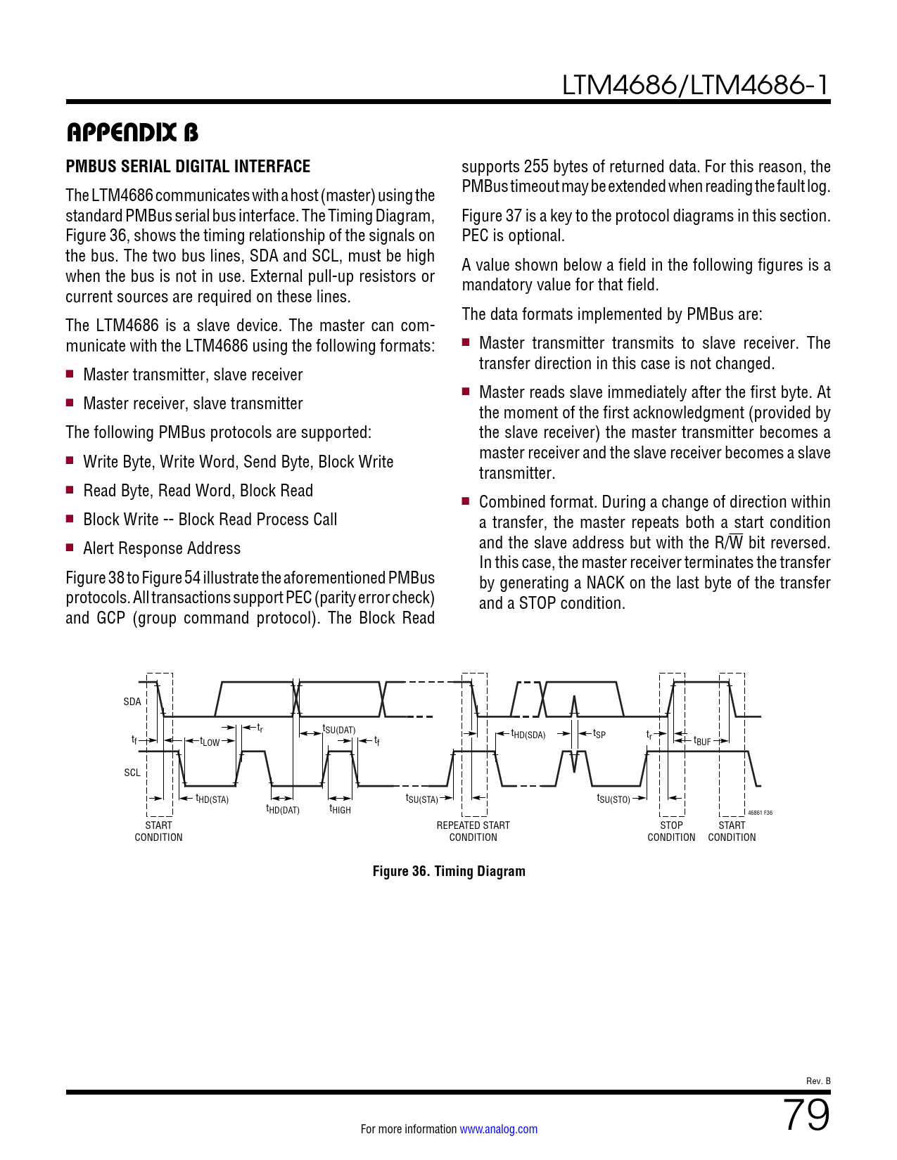

APPENDIX B PMBUS SERIAL DIGITAL INTERFACE
supports 255 bytes of returned data. For this reason, the The LTM4686 communicates with a host (master) using the PMBus timeout may be extended when reading the fault log. standard PMBus serial bus interface. The Timing Diagram, Figure 37 is a key to the protocol diagrams in this section. Figure 36, shows the timing relationship of the signals on PEC is optional. the bus. The two bus lines, SDA and SCL, must be high A value shown below a field in the following figures is a when the bus is not in use. External pull-up resistors or mandatory value for that field. current sources are required on these lines. The data formats implemented by PMBus are: The LTM4686 is a slave device. The master can com- municate with the LTM4686 using the following formats: n Master transmitter transmits to slave receiver. The transfer direction in this case is not changed. n Master transmitter, slave receiver n Master reads slave immediately after the first byte. At n Master receiver, slave transmitter the moment of the first acknowledgment (provided by The following PMBus protocols are supported: the slave receiver) the master transmitter becomes a master receiver and the slave receiver becomes a slave n Write Byte, Write Word, Send Byte, Block Write transmitter. n Read Byte, Read Word, Block Read n Combined format. During a change of direction within n Block Write -- Block Read Process Call a transfer, the master repeats both a start condition and the slave address but with the R/W bit reversed. n Alert Response Address In this case, the master receiver terminates the transfer Figure 38 to Figure 54 illustrate the aforementioned PMBus by generating a NACK on the last byte of the transfer protocols. All transactions support PEC (parity error check) and a STOP condition. and GCP (group command protocol). The Block Read SDA tr tSU(DAT) t t t HD(SDA) tSP r tf LOW t t f BUF SCL tHD(STA) tSU(STA) tSU(STO) tHD(DAT) tHIGH 46861 F36 START REPEATED START STOP START CONDITION CONDITION CONDITION CONDITION
Figure 36. Timing Diagram
